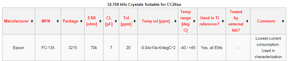

I have a question about CC2640 32.768K XOSC_LF Load capacitor.
The Epson FC-135 for 32.768KHz Crystal is used on CC2650EM Baoad.
The CL of  Epson FC-135 is 7pF.
The load capacitor on CC2650EM schematic is 12pF.
Why use 12pF for load capacitor ?
