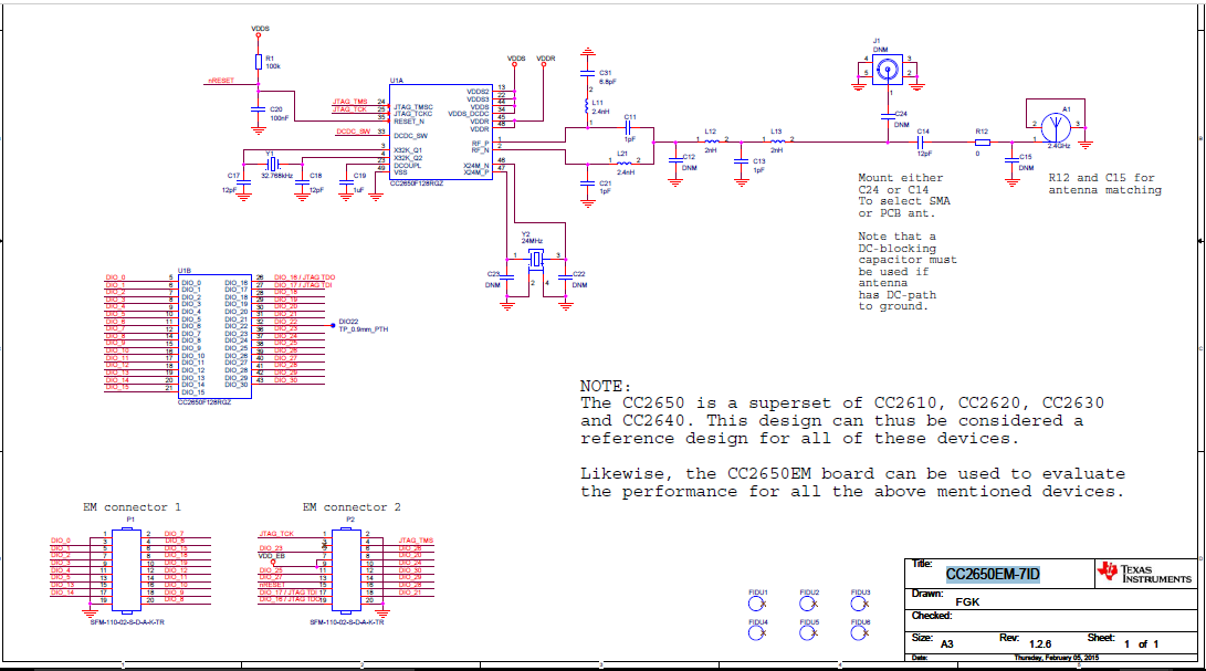

I am working on SPP project. I want to communicate SPPBLEServer with SPPBLE Client. I could load both programs from CCS to 2 boards. Server side shows "Advertising". but when i press UP button at client side it does not show "Discovering...". In short button press functions at client side not working. I had modified my Board.h file earlier (Keys, LEDs , UART , and LCD IODs). Whenever i load pre built hex files system works fine. How to make the client side to detect serever on button presses? please help (I am using CC2650EM 7ID and SmartRF06 EB)(Software patch downloaded from www.ti.com/.../TIDC-SPPBLE-SW-RD).
My Modified Board.h file

  • Hi Abhijith,
    It seems you are using the board file for the Sensortag, can you try excluding this file and add in the board file for the SmartRF06 board that's used in the original SimpleBLEPeripheral project?
    Best wishes
    I think I have overwritten that file with this new board.h file :(. from where can i get the original file?. I have modified that  file by referring this pdf
    BR,
    Abhijith S.
  • The board file for RF06 is located in C:\ti\tirtos_simplelink_2_13_00_06\packages\ti\boards\SRF06EB\CC2650EM_7ID\Board.h
    You should not see any definition regarding sensortag
  • Actually i have overwritten that  file at this location , Now i got that  original file from another folder. i will be working on it , but not now. Now i am concentrate on Server side. i can manage client side with an app
