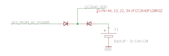

My application is likely a home automation application, and I use a CC2640 with its basic configuration (integrated CC-CC converter),
My need is special, because my module has two sources of simultaneous powering.
- The first is a 3v3 AC power.
- The second is a backup powering, it is a 3v coin cell, supplying the module when there is a defect of the first power supply.
 In experimental condition I encounter the following problem:
 When Vcc voltage remains around 1v8,  in this case this is able of generating a crash of the microcontroller.
In this case,  The CC2640 seem to be in particular mode: all IO are not powered, the two crystals oscillators are stopped, the CC-CC regulator not switching but VDDR/VDDRF remains around 1v7. This even if Vcc reach back to 3v3.
The only ways to recover the normal state of microcontroller is that Vcc back down under 1v8 and goes up above 1v8 with a minimal slope, the second way is to asserting hardware Reset signal to ground.
For me because I use the CC2640 with two power supplies, this is a potential problem.
In case if the mains power is off and my backup cell is empty, my backup cell can maintain a voltage Vcc around 1V8. in this case when I recover the 3v3 mains power , I risk not being able to recover a good functionality of microcontroller.

    My power Scheme is the following one:
    My main power source is the AC Power, The battery is juste a backup power source,
    A dead battery should not prevent the operation of the module when his main power source goes from 'Off' to 'On'
    That is why in my case Vdd of the CC2640 can floating around 1v8 (from dead battery) before he goes up to 3v3 (from main AC power).This can happen when the main power goes from OFF to ON.

    The system could be crashed due to power glitch or software bug. In your case, it is more likely power supply issue. I would suggest you to use oscilloscope to monitor CC2640_VDD. In oscilloscope, set a trigger level at 2.2V. It is not reasonable for CC2640_VDD to drop to 2.2V. If this happens then it means your board layout or power integrity is not good enough.

    As I mention earlier in this blog, my problem is I have a main AC power (3v3), and in parallel (with diodes) a backup battery (see the diagrams above).
    My problem is, due to my specifications, the backup battery can possibly be dead.
    Also, when AC power is no longer operational, dead battery can cause glitch or voltage around 1v8 on CC2640 VDD, in that case, when the main AC power return, I can't guarantee to recover control of the CC2640.

  • Hi Damien,
    So, the major issue is when backup battery is dead.
    OK, first of all, I won't recommend you to turn off STANDBY mode because it will consume too much current from battery if you keep CC26xx active all the time. The output current of coin cell battery is very very limited.
    One of the method is to use watchdog, when the program is crashed due to out of backup battery, CC26xx will be reset by watchdog and run from start again. But the output voltage of coin cell will drop immediately when there is inrush current. This usually happens when booting up and when RF is activated. So, I will say this is a unreliable way because CC26xx will boot --> crash --> reset --> boot --> crash --> rest... for several rounds.
    An external RESET chip is a very reliable way. CPU like MSP430 has a hardware mechanism to detect VDD, acts like RESET chip. But so far I don't know if CC26xx can do that or not.
    In summary, I would recommend a RESET chip for reliable design.
