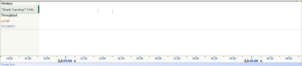

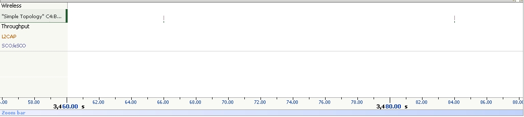

2.when i use the mobile phone (meizu mx5,android 5.0) which installed the app nRF Master control pannel developed by Nordic connect to RF06 board .the broadcast becomes abnormal as shown in the picture.(the first picture shows the normal broadcast)
pictures below shows the abnormal broadcast:
at last ,there is no longer broadcast appeared. but it's not absolute,sometimes the broadcast appeared again and becomes normal just like nothing happend.
3.RF06 connected to 3 itouches and some mobile phones which installed BLE Device Monitor or nRF Master control pannel,then the itouch will disconnect some minutes later.
    What was the reason for the disconnect(s)?

    Just to confirm, are you using the latest code from the GitHub page: github.com/.../multi_role ?
    We'll need to know the reason for the disconnect; please understand this is useful info for the investigation as we do not see the same issue or have the exact setup as you. Thank you for your understanding.
