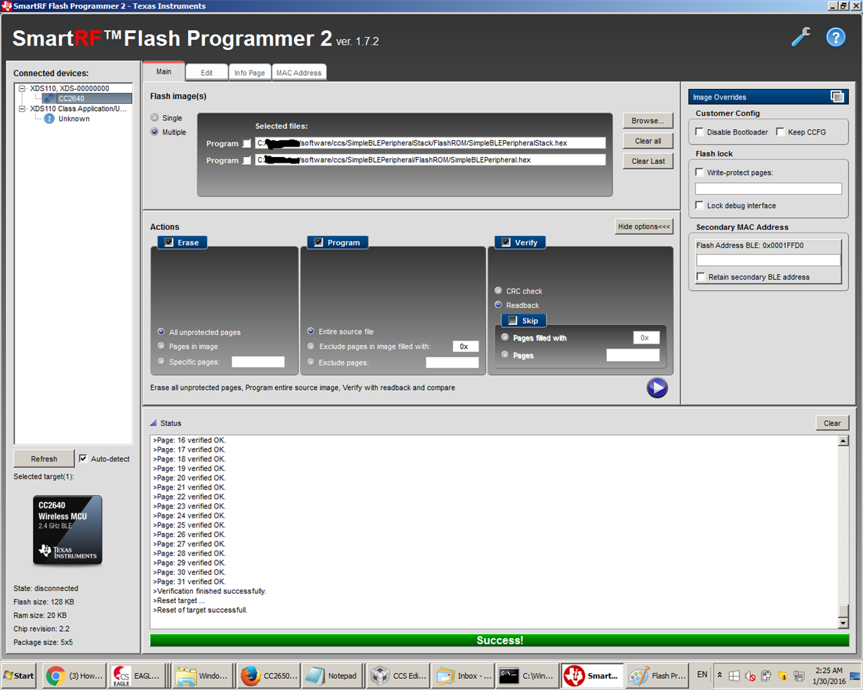

  •  Thank you. My XDS110 is alive again. I followed your instructions, using Flash Programmer 2 to flash the hex files of both Simple BLE Peripheral  stack and its app as my screen shot. Then, unplug debugger, reset my board's power to run in release mode, it is actully running. Everything is normal except bluetooth can not connect to mobile app. In release mode, my board is advertising, but when my phone's app tries to connect, it will result in "Interrogation timeout". While in debug mode in CCS, the bluetooth connection is good.
    Do you know what is wrong? Thanks.

  • Hi Zhang,
    This is usually caused by the missing CCFG data at the end of flash memory. You can find an example ccfg.c file under folder "driverlib". What you need to do is to link the CCFG data with your program by using linker command file.
