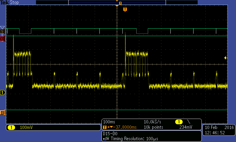

  • After taking a looking at the current consumption, it appears that CC2540 does not perform any scanning unless the scanning window falls into when the device it is advertising.
    Take a look at the following screen shot:
    D9 is set high when we enable scanning, when D9 is low it is either we have found a response through GAP_DEVICE_INFO_EVENT or scanning has ended via GAP_DEVICE_DISCOVERY_EVENT
