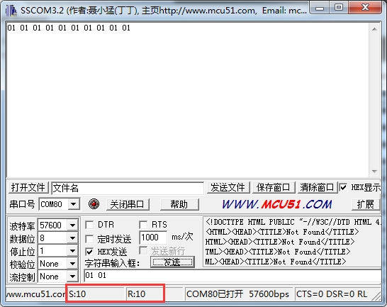

Tested in sdk(ble_2_00_00_42893)and (ble_2_01_01_44627),use simpleBLEBroadcaster project with power saving, send 5 times HEX data (01,01) and watch result.

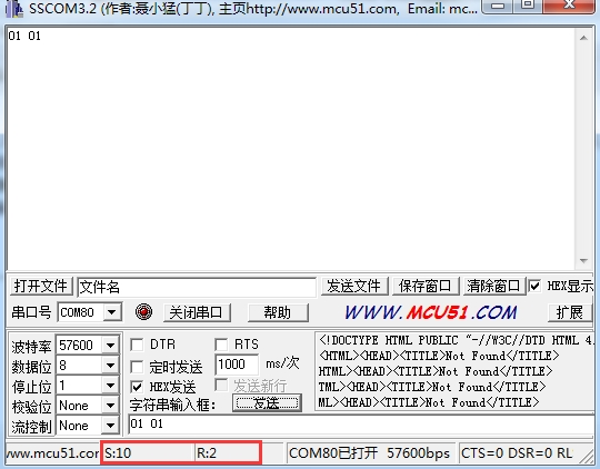

in (ble_2_00_00_42893), reslut is ok (write 10 bytes,read 10 bytes, ),in (ble_2_01_01_44627), something is happend (write 10 bytes, echo 2 bytes),

in (ble_2_01_01_44627),we can find Callback function l only have one respond .but in (ble_2_00_00_42893),it respond  everytime.

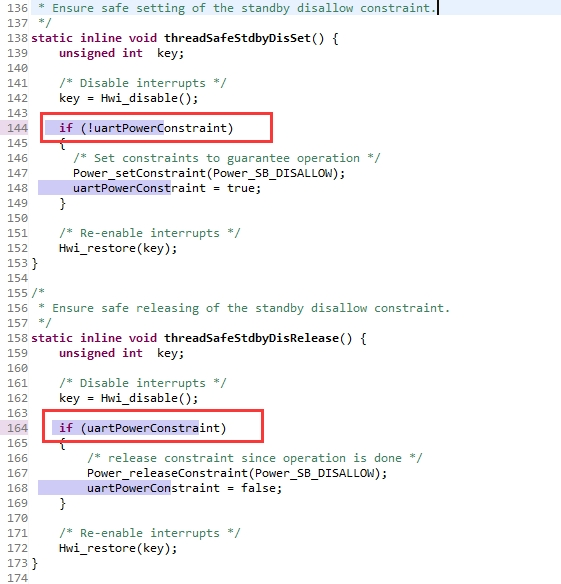

we debug trace,and find differences in UARTCC26XX.c which include in (tirtos_simplelink_2_11_01_09) and (tirtos_simplelink_2_13_00_06).
in ThreadSafeStdbyDisSet() andThreadSafeStdbyDisRelease(),  tirtos_simplelink_2_11_01_09  has added  if(!uartpowerConstraint) and if(uartpowerConstraint) ,if we comment these if statement,everything is ok.
so I and customer want to know , whether my code have some errors or (ble_2_01_01_44627) has some problems?? Wish somebody can answer my query.........
