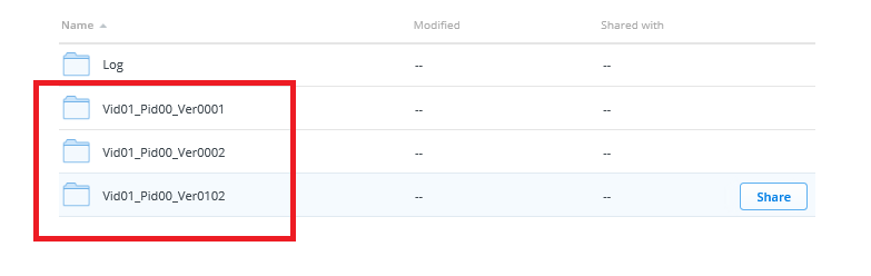

I am currently working on OTA for CC3200. I am referring CC3200 Over-The-Air (OTA) Update Application Note. Using this, I tried out the sample application for OTA packaged with CC3200sdk. It worked fine. Now, I am trying the Adding OTA to existing application. I am now using Get Weather application. After following all the things mentioned in the application note, I am getting error as "OTA run = -4, Error with OTA server". I am attaching some images for more clarification. Please tell me what will be the cause?
Three folders created in DropBox.
The OTA_VENDOR_STRING is Vid01_Pid00_Ver01 for first build and uploaded to folder Vid01_Pid00_Ver0002.
The OTA_VENDOR_STRING is Vid01_Pid00_Ver00 for second build and uploaded to folder Vid01_Pid00_Ver0102.
Following screen shows the debug on Tera Term.
For mcuimg.bin I set the url as "C:\ti\CC3200SDK_1.1.0\cc3200-sdk\example\application_bootloader\ccs\Release\application_bootloader.bin"
For mcuimg1.bin, "D:\Mind and Body\OTA-over the air\Get_Weather_workspace\get_weather\Release\get_weather.bin"
For mcuimg2.bin. "D:\Mind and Body\OTA-over the air\Get_Weather_workspace\get_weather\Release\get_weather.bin"
