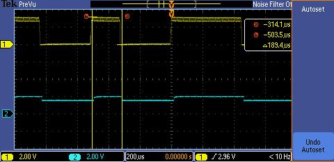

Hi everyone.....

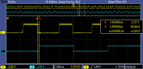

I m using CC2540 on custom board and working on custom bluetooth 4.0 project. At the first screenshot yellow channel of scope shows destination wave to measure pulse-space width. This wave coming from anolog circuit to P0_7of CC2540. The blue cannel shows catching of any external interrupt(rising&falling). For the first screenshot, the time slot (that has variable value, not fixed) beetwen cursors(value is 189.4 us) is expected value. So, external interrupt on P0_7 is working truely. At the second screenshot, this time, blue cannel showing P0_7 logic-0 state(it means if the P0_7 is logic-0 then toggle) after the capturing any edge. So, after the edge capture, checking the P0_7 state working truely(also, logic-1 state checked).
What i want to?.. I want to measure pulse-space width with 16-bit timer(TIMER1) and save to variable. If the measured pulse-space width with the timer1 is in the destination time slot, then the data array which is coming from analog circuit will place to uint8 array after the evaluation. The code fragments like this;
