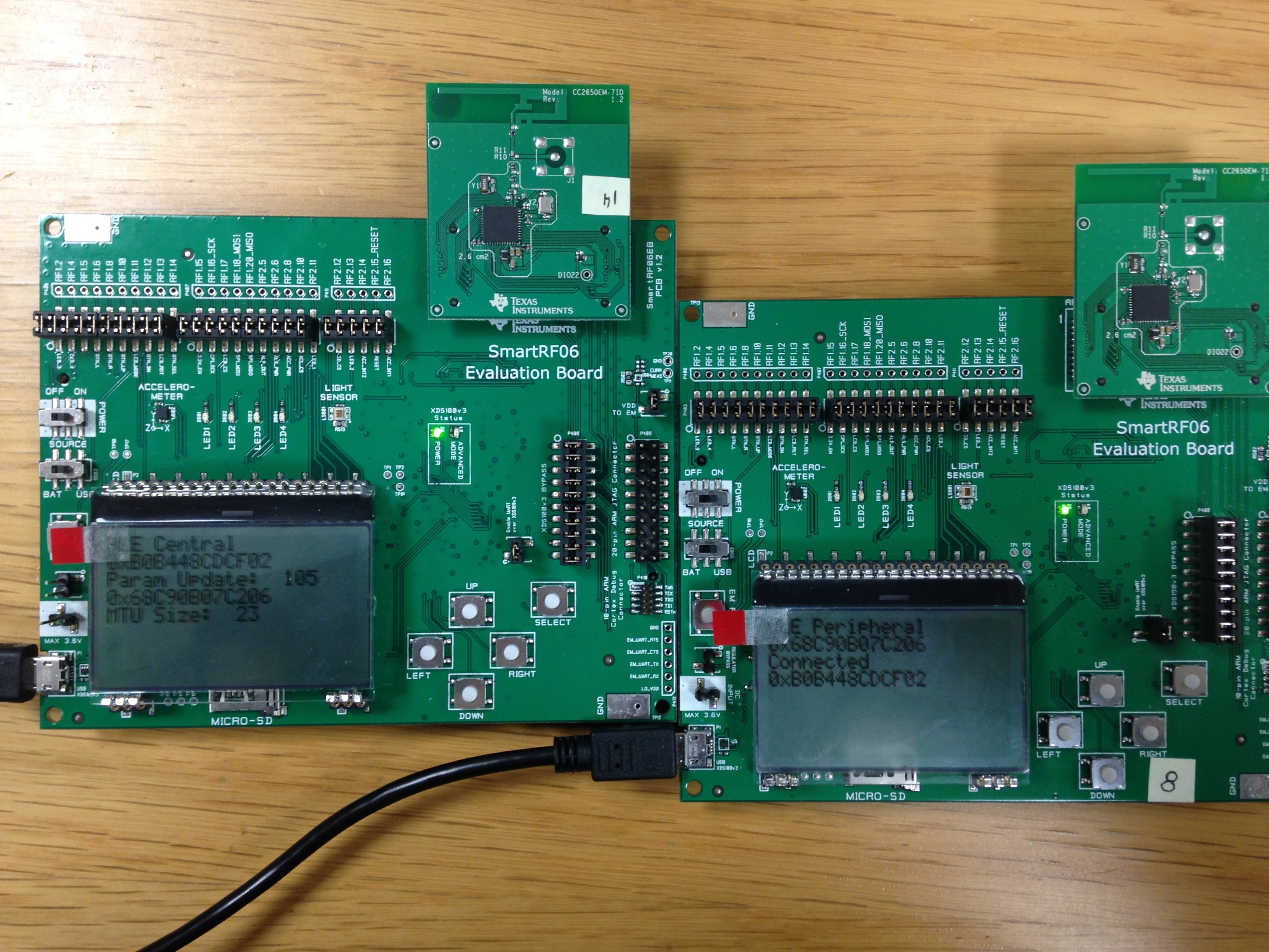

    I am using the hex files of the central and the peripheral (without modifying them at all). After 6 sec since the establishment of the connection, the parameters of the connection are updated and on the screen of the master I can see those values. I can confirm that I have seen all of them, in decimal form on the screen. I can upload a picture tomorrow morning, but I can tell you that I tried today one more time and I got 105 (0x69), as most of the time.

  • Ok I see what is happening...
    When the link update event (gapLinkUpdateEvent_t) is sent by the stack, the status of the event is actually being set to the status of the osal event (yellow) instead of the event status (green):
    typedef struct
      osal_event_hdr_t hdr;     //!< GAP_MSG_EVENT and status
      uint8 opcode;             //!< GAP_LINK_PARAM_UPDATE_EVENT
      uint8 status;             //!< bStatus_t
      uint16 connectionHandle;  //!< Connection handle of the update
      uint16 connInterval;      //!< Requested connection interval
      uint16 connLatency;       //!< Requested connection latency
      uint16 connTimeout;       //!< Requested connection timeout
    } gapLinkUpdateEvent_t;
    typedef struct
      uint8 event;
      uint8 status;
    } osal_event_hdr_t;
    The application, however, is checking the event status which is not set so it is reading whatever the last value was in RAM. I've filed this as a bug and it will be fixed.
    In the meantime, you can do the following in the application:
        case GAP_LINK_PARAM_UPDATE_EVENT:
            LCD_WRITE_STRING_VALUE("Param Update:", pEvent->linkUpdate.hdr.status,
                                    10, LCD_PAGE2);
