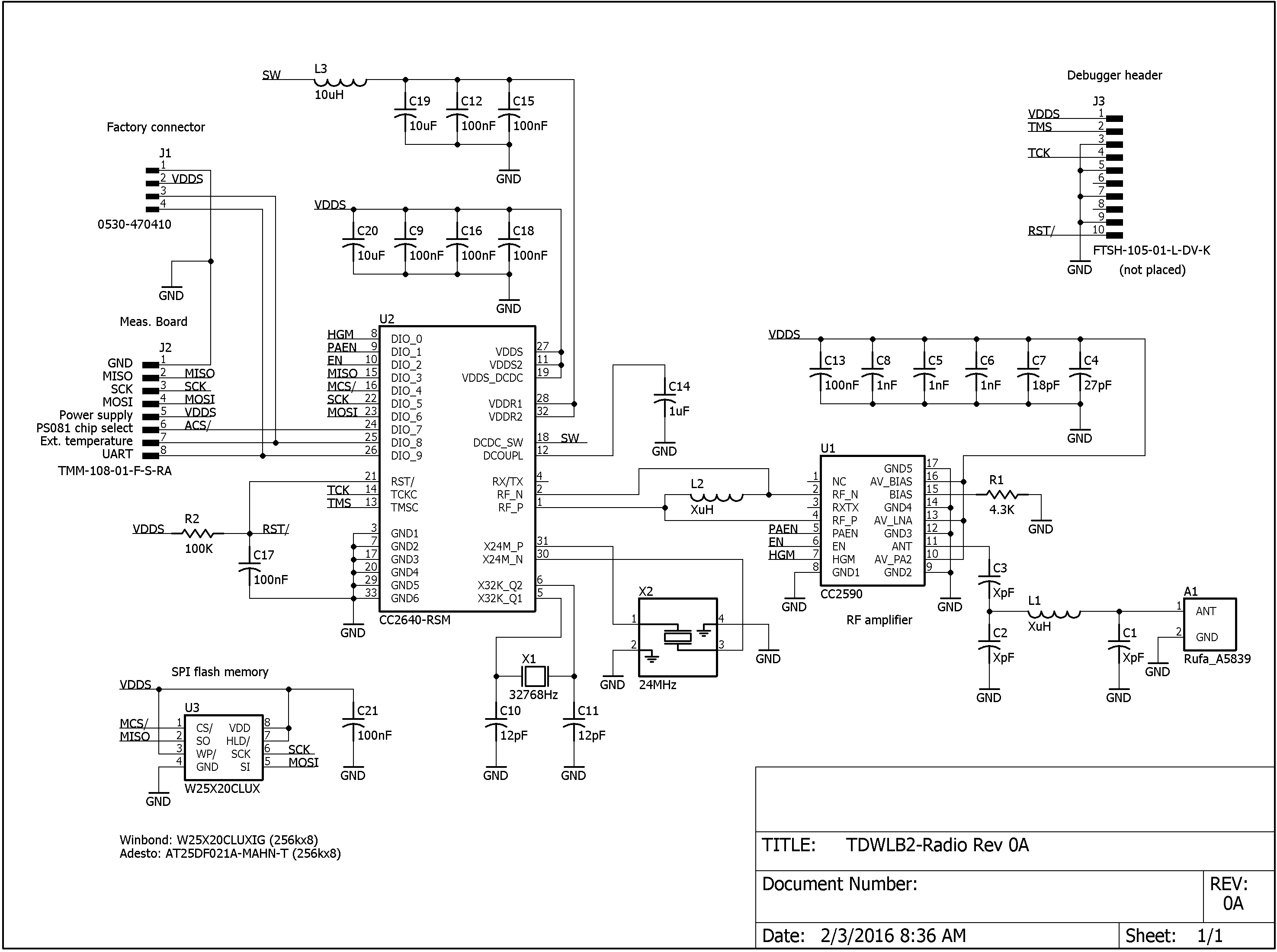

SimpleBLEPeripheral 2640 custom board/2650DK-- how to observe advertising
Other Parts Discussed in Thread: CC2640, CC2650, CC2541, CC2590, SYSBIOS
SimpleBLEPeripheral built successfully and a debug run on the 2650 DK displayed "advertising" on the
screen. I ran the project as is without changing any default parameter settings (initialAdvertEnable = TRUE).
What will this project output be like on the 2650DK?
I was also able to successfully build SimpleBLEPeripheral to a 4x4 package. Edits were made to main.c
to set the IOC ports that control the power amplifier on our custom board to transmit and receive.
This code is compiling and executing OK.
I am probing PAEN and EN on the scope and I am not seeing any advertising happening.
Break points in simpleBLEPeripheral.c are not being executed. Can you offer pointers
here?
Priya
  • We are using an XDS200 debugger with our custom CC2640 board.
    The target config file is set to CC2650 built for a 4x4 package I used the
    same board.c file that came with the CC2650DK.
    I successfully built the SimpleBLEPeripheral to our custom target this way.
    When I debug this project, here is what I see after PIN_init(BoardGpioInitTable);
    is executed.
    Expression x = *(PIN_init); type unknown; Value 0x00001988 Error cannot be
    loaded from nonprimitive location.
    What does this error mean?
    Priya
  • Hello Priya,
    For running on 4x4, did you follow the procedure to change to the CC2650EM_4XS board file? This is needed, among other reasons, to get the correct RF settings. See 6.2 Board File in the CC2640 SW Dev Guide (SWRU393).
    Best wishes
  • Yes, I am currently picking the CC2650EM_4XS board file. I did but a break point after the PIN_Init
    function call in main.c and the debugger is complaining about something when I hover over this
    function call. I posted about this on a new thread today. Maybe its related to this issue?
    Thank you for your reply,
    Priya
  • Hello Priya,
    Let's consider them related. I see some new information: you are using a custom board and not the CC2650EM_4XS module. Can you confirm that your board file PIN structure matches your custom HW layout? If not, you can expect to see some undefined behavior.
    For debugging, try removing optimization on the main.c & board.c files.
    Also, if possible, please attach your schematic & board.c/h PIN table.
    Best wishes

    4744.Board.hI have attached the schematic for this custom board. The Board.c and Board.h are the
    same as the CC2650_4XS files that came with the CC2650DK.
    Thank you,
    Priya
    Since you are setting the IO pins directly via IOCPortConfigureSet , you should take them out of the BoardGpioInitTable as you will have a conflict.
    Best wishes
  • JXS--
    The only 3 pins I am currently defining through IOCPortConfigureSet are what the RF Power Amplifier needs. (HGM, PAEN and EN).
    The PIN table in the board.c file has the same code as from the 2650DK:
    PIN_Config BoardGpioInitTable[] = {
    Board_KEY_SELECT | PIN_INPUT_EN | PIN_PULLUP | PIN_HYSTERESIS, /* Button is active low */
    Board_UART_TX | PIN_GPIO_OUTPUT_EN | PIN_GPIO_HIGH | PIN_PUSHPULL, /* UART TX pin at inactive level */
    PIN_TERMINATE /* Terminate list */
    Which part of this table can I remove?
    Should I be making specific IOCPortconfigureSet calls for the SPI and UART pins for the custom board?
    I don't understand how to edit this BoardGPIOInitTable clearly.
    Priya
  • Priya,
    The BoardGPIOInitTable is just an array of structures, with each element corresponding to the respective pin (mapped via board.h).
    #define Board_UART_TX IOID_2 /* RF1.9 */
    is the same pin as your EN in your schematic, so you shoudl remove this line from your BoardGPIOInitTable .

  • Without reading the entire thread, some comments to your schematics. You must configure the CC2640 to a differential front-end with internal bias. L2 should be not mounted. For the CC2590 part (decoupling and ant pin) you should copy the CC2541 CC2590 reference design, see www.ti.com/.../cc2541-cc2590em-rd. And you will most likely need placeholders for antenna tuning.
  • Charlotte-- L2 is only a placeholder on the schematic, it is not on our layout board. The CC2541 CC2590
    was the reference design used to get started. Thanks.
    JXS-- thank you for the feedback. I have made edits to the board.h file to match the pins on our schematic.
    1. I removed IOs for LEDs, there are none on our custom board.
    2. I left the KEY_SELECT_IOID7 in place. Our schematic will be using this IO for
    a different purpose, not currently part of the board being programmed, though it will
    eventually have a different name.
    3. I re-numbered the UART and SPI pin definitions to match the schematic.
    Not much has changed in the debug run, build is successful. If you happen to notice
    anything else, I appreciate a reply. I will keep looking for more.
    Priya
