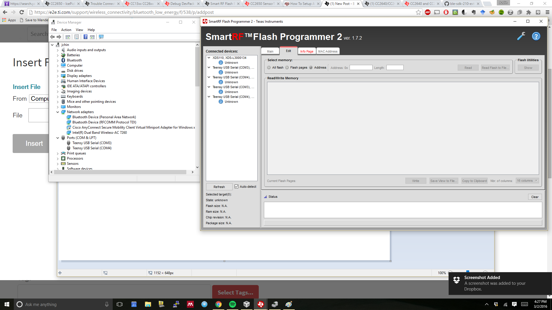

  I was able to debug my CC2650 on CCS and flash hex files using Smart RF, however after going through the TI RTOS Basic Lab and flashing a modified program, I am no longer able to detect my CC2650.  The CC2650 still runs the program that I flashed properly.  Does anyone have any suggestions?
  • Hello Justin,
    From your screen shot, it looks like you have other programs open, such as CCS, that may be attaching to the XDS110. Can you try closing all programs, then open up SmartRF Flash Programmer 2? If that doesn't work, try rebooting your PC.
    Best wishes
