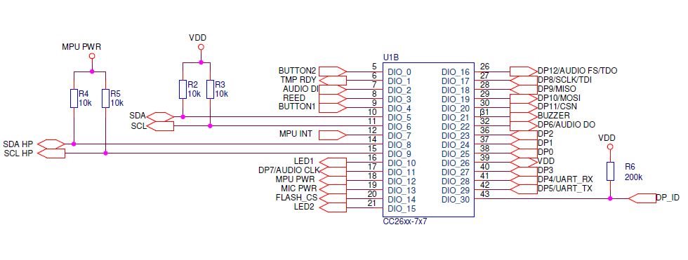

  • Thanks for your quick reply. Can I drive the buzzer on the SensorTag from the SC?
  • You can take a look at our TRM section 11.8 I/O Pin Mapping, which lists which DIOs can be used in sensor controller.
    TRM can be downloaded here :
    in STK schematic, buzzer is mapped to DIO21, which is not AUX IO too.
