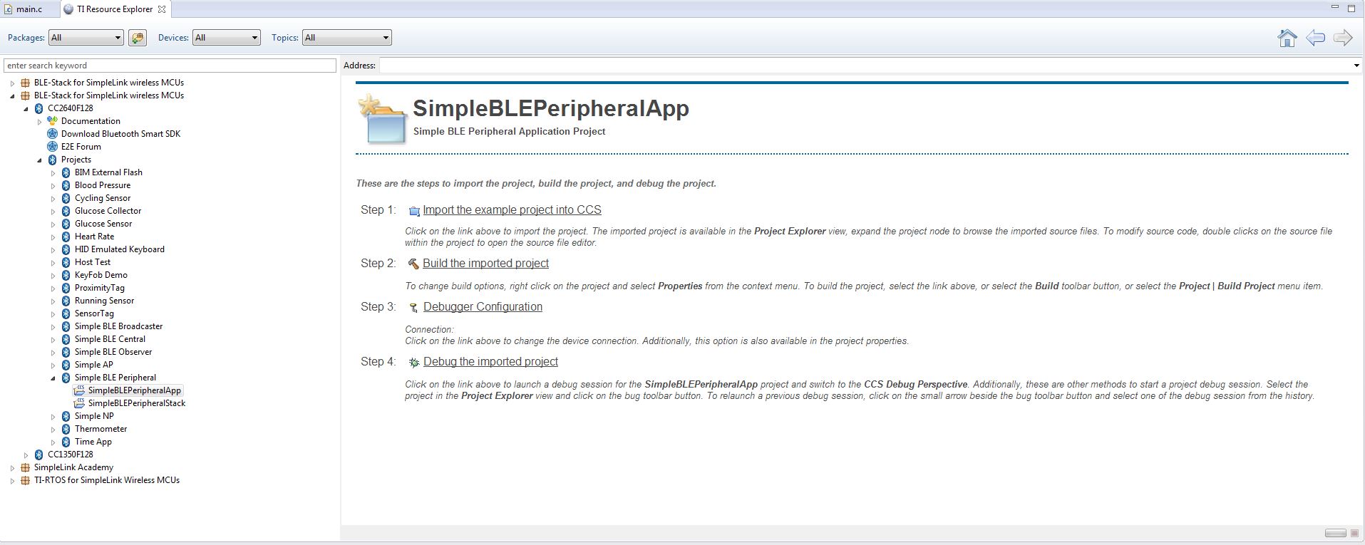

Anyone explain me how can i configure CCS for my CC2650 STK step by step. I tired very much but always give error about include paths? ( #1965 fatal error can not open  source file etc)

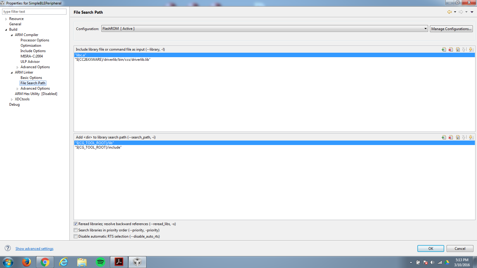

    u need to add the path of the library, in Properties, Arm compiler -> include option -> add dir

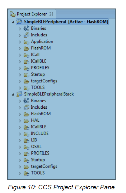

    debug the app and stack both project of sensor tag then it will work

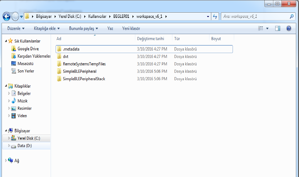

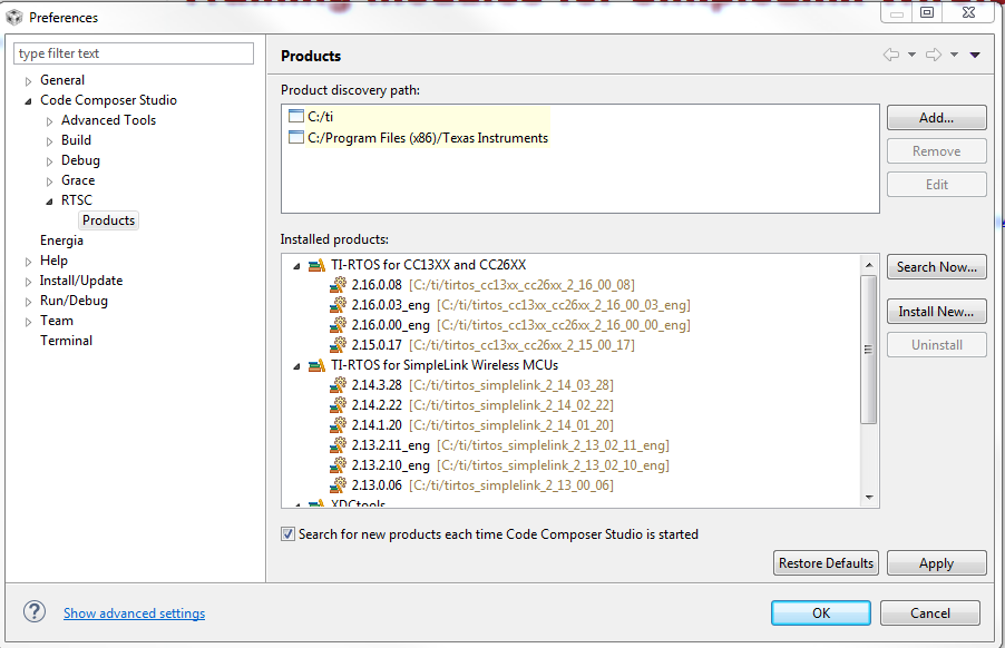

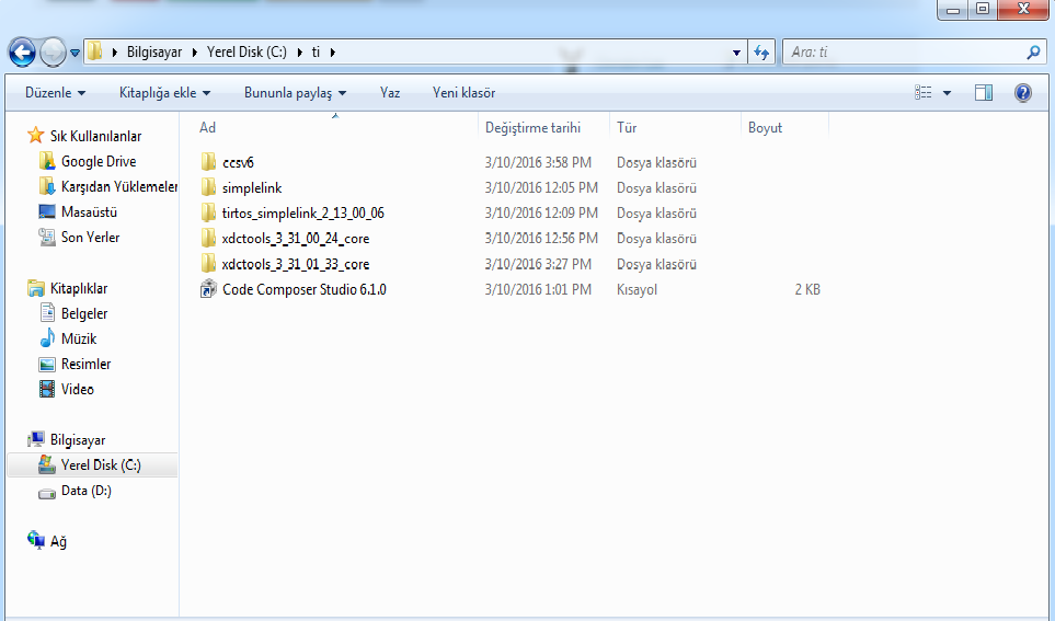

  • which paths are included ? i tried so much but dont work.
  • you don't have to change anything in the example project....just build and debug them...app and stack both on sensortag.
    or screenshot will be helpful for me to guide you

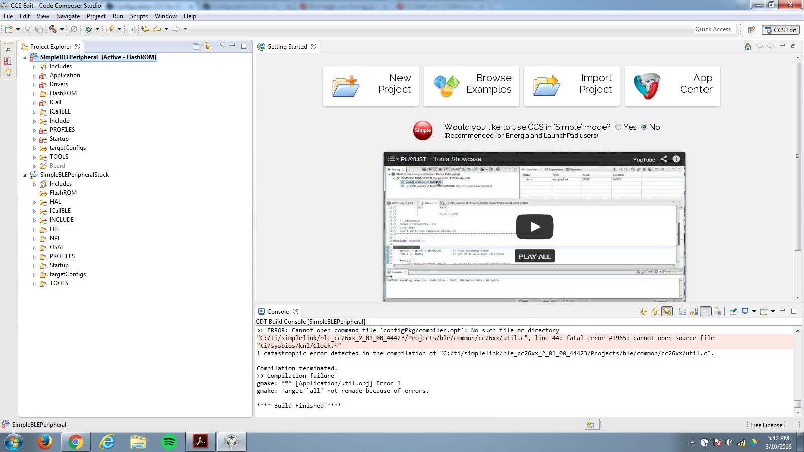

  • Hİ,
    This is my error log,
    **** Build of configuration FlashROM for project SimpleBLEPeripheral ****
    "C:\\ti\\ccsv6\\utils\\bin\\gmake" -k all
    'Building file: C:/ti/simplelink/ble_cc26xx_2_01_01_44627/Projects/ble/SimpleBLEPeripheral/CC26xx/CCS/Config/appBLE.cfg'
    'Invoking: XDCtools'
    "C:/ti/xdctools_3_31_01_33_core/xs" --xdcpath="C:/ti/tirtos_simplelink_2_13_00_06/packages;C:/ti/tirtos_simplelink_2_13_00_06/products/bios_6_42_00_08/packages;C:/ti/tirtos_simplelink_2_13_00_06/products/uia_2_00_02_39/packages;C:/ti/ccsv6/ccs_base;" xdc.tools.configuro -o configPkg -t ti.targets.arm.elf.M3 -p ti.platforms.simplelink:CC2640F128 -r release -c "C:/ti/ccsv6/tools/compiler/ti-cgt-arm_5.2.5" --compileOptions "-mv7M3 --code_state=16 --abi=eabi -me -O4 --opt_for_speed=0 --include_path=\"C:/ti/ccsv6/tools/compiler/ti-cgt-arm_5.2.5/include\" --include_path=\"C:/ti/simplelink/ble_cc26xx_2_01_01_44627/Projects/ble/SimpleBLEPeripheral/CC26xx/Source/Application\" --include_path=\"C:/ti/simplelink/ble_cc26xx_2_01_01_44627/Projects/ble/include\" --include_path=\"C:/ti/simplelink/ble_cc26xx_2_01_01_44627/Projects/ble/ICall/Include\" --include_path=\"C:/ti/simplelink/ble_cc26xx_2_01_01_44627/Projects/ble/Profiles/Roles/CC26xx\" --include_path=\"C:/ti/simplelink/ble_cc26xx_2_01_01_44627/Projects/ble/Profiles/Roles\" --include_path=\"C:/ti/simplelink/ble_cc26xx_2_01_01_44627/Projects/ble/Profiles/DevInfo\" --include_path=\"C:/ti/simplelink/ble_cc26xx_2_01_01_44627/Projects/ble/Profiles/SimpleProfile/CC26xx\" --include_path=\"C:/ti/simplelink/ble_cc26xx_2_01_01_44627/Projects/ble/Profiles/SimpleProfile\" --include_path=\"C:/ti/simplelink/ble_cc26xx_2_01_01_44627/Projects/ble/common/cc26xx\" --include_path=\"C:/ti/simplelink/ble_cc26xx_2_01_01_44627/Components/applib/heap\" --include_path=\"C:/ti/simplelink/ble_cc26xx_2_01_01_44627/Components/ble/hci\" --include_path=\"C:/ti/simplelink/ble_cc26xx_2_01_01_44627/Components/ble/controller/CC26xx/include\" --include_path=\"C:/ti/simplelink/ble_cc26xx_2_01_01_44627/Components/ble/host\" --include_path=\"C:/ti/simplelink/ble_cc26xx_2_01_01_44627/Components/hal/target/CC2650TIRTOS\" --include_path=\"C:/ti/simplelink/ble_cc26xx_2_01_01_44627/Components/hal/target/_common/cc26xx\" --include_path=\"C:/ti/simplelink/ble_cc26xx_2_01_01_44627/Components/hal/include\" --include_path=\"C:/ti/simplelink/ble_cc26xx_2_01_01_44627/Components/osal/include\" --include_path=\"C:/ti/simplelink/ble_cc26xx_2_01_01_44627/Components/services/sdata\" --include_path=\"C:/ti/simplelink/ble_cc26xx_2_01_01_44627/Components/services/saddr\" --include_path=\"C:/ti/simplelink/ble_cc26xx_2_01_01_44627/Components/icall/include\" --include_path=\"C:/ti/simplelink/ble_cc26xx_2_01_01_44627/Components/ble/include\" --include_path=\"C:/ti/tirtos_simplelink_2_13_00_06/products/cc26xxware_2_21_01_15600\" --include_path=\"C:/ti/tirtos_simplelink_2_13_00_06/packages/ti/boards/SRF06EB/CC2650EM_7ID\" -g --gcc --define=USE_ICALL --define=POWER_SAVING --define=SBP_TASK_STACK_SIZE=700 --define=GAPROLE_TASK_STACK_SIZE=520 --define=HEAPMGR_SIZE=2672 --define=TI_DRIVERS_SPI_DMA_INCLUDED --define=TI_DRIVERS_LCD_INCLUDED --define=ICALL_MAX_NUM_TASKS=3 --define=ICALL_MAX_NUM_ENTITIES=6 --define=xdc_runtime_Assert_DISABLE_ALL --define=xdc_runtime_Log_DISABLE_ALL --define=MAX_NUM_BLE_CONNS=1 --define=CC26XXWARE --define=CC26XX --display_error_number --diag_suppress=48 --diag_warning=225 --diag_wrap=off --gen_func_subsections=on "
    xdc.tools.configuro: missing input config script

    "C:/ti/ccsv6/tools/compiler/ti-cgt-arm_5.2.5/bin/armcl" --cmd_file="C:/ti/simplelink/ble_cc26xx_2_01_01_44627/Projects/ble/SimpleBLEPeripheral/CC26xx/CCS/SimpleBLEPeripheral/../../IAR/Application/CC2640/../../../CCS/Config/ccsCompilerDefines.bcfg" -mv7M3 --code_state=16 --abi=eabi -me -O4 --opt_for_speed=0 --include_path="C:/ti/ccsv6/tools/compiler/ti-cgt-arm_5.2.5/include" --include_path="C:/ti/simplelink/ble_cc26xx_2_01_01_44627/Projects/ble/SimpleBLEPeripheral/CC26xx/Source/Application" --include_path="C:/ti/simplelink/ble_cc26xx_2_01_01_44627/Projects/ble/include" --include_path="C:/ti/simplelink/ble_cc26xx_2_01_01_44627/Projects/ble/ICall/Include" --include_path="C:/ti/simplelink/ble_cc26xx_2_01_01_44627/Projects/ble/Profiles/Roles/CC26xx" --include_path="C:/ti/simplelink/ble_cc26xx_2_01_01_44627/Projects/ble/Profiles/Roles" --include_path="C:/ti/simplelink/ble_cc26xx_2_01_01_44627/Projects/ble/Profiles/DevInfo" --include_path="C:/ti/simplelink/ble_cc26xx_2_01_01_44627/Projects/ble/Profiles/SimpleProfile/CC26xx" --include_path="C:/ti/simplelink/ble_cc26xx_2_01_01_44627/Projects/ble/Profiles/SimpleProfile" --include_path="C:/ti/simplelink/ble_cc26xx_2_01_01_44627/Projects/ble/common/cc26xx" --include_path="C:/ti/simplelink/ble_cc26xx_2_01_01_44627/Components/applib/heap" --include_path="C:/ti/simplelink/ble_cc26xx_2_01_01_44627/Components/ble/hci" --include_path="C:/ti/simplelink/ble_cc26xx_2_01_01_44627/Components/ble/controller/CC26xx/include" --include_path="C:/ti/simplelink/ble_cc26xx_2_01_01_44627/Components/ble/host" --include_path="C:/ti/simplelink/ble_cc26xx_2_01_01_44627/Components/hal/target/CC2650TIRTOS" --include_path="C:/ti/simplelink/ble_cc26xx_2_01_01_44627/Components/hal/target/_common/cc26xx" --include_path="C:/ti/simplelink/ble_cc26xx_2_01_01_44627/Components/hal/include" --include_path="C:/ti/simplelink/ble_cc26xx_2_01_01_44627/Components/osal/include" --include_path="C:/ti/simplelink/ble_cc26xx_2_01_01_44627/Components/services/sdata" --include_path="C:/ti/simplelink/ble_cc26xx_2_01_01_44627/Components/services/saddr" --include_path="C:/ti/simplelink/ble_cc26xx_2_01_01_44627/Components/icall/include" --include_path="C:/ti/simplelink/ble_cc26xx_2_01_01_44627/Components/ble/include" --include_path="C:/ti/tirtos_simplelink_2_13_00_06/products/cc26xxware_2_21_01_15600" --include_path="C:/ti/tirtos_simplelink_2_13_00_06/packages/ti/boards/SRF06EB/CC2650EM_7ID" -g --gcc --define=USE_ICALL --define=POWER_SAVING --define=SBP_TASK_STACK_SIZE=700 --define=GAPROLE_TASK_STACK_SIZE=520 --define=HEAPMGR_SIZE=2672 --define=TI_DRIVERS_SPI_DMA_INCLUDED --define=TI_DRIVERS_LCD_INCLUDED --define=ICALL_MAX_NUM_TASKS=3 --define=ICALL_MAX_NUM_ENTITIES=6 --define=xdc_runtime_Assert_DISABLE_ALL --define=xdc_runtime_Log_DISABLE_ALL --define=MAX_NUM_BLE_CONNS=1 --define=CC26XXWARE --define=CC26XX --display_error_number --diag_suppress=48 --diag_warning=225 --diag_wrap=off --gen_func_subsections=on --preproc_with_compile --preproc_dependency="Startup/Board.pp" --obj_directory="Startup" --cmd_file="configPkg/compiler.opt" "C:/ti/tirtos_simplelink_2_13_00_06/packages/ti/boards/SRF06EB/Board.c"
    >> ERROR: Cannot open command file 'configPkg/compiler.opt': No such file or directory

    Can you try delete the whole workspace/ or create a new one and then following our software developer's guide, section 2.5, Setting up the Development Environment.
    Our software developer's guide can be found in the same place where the SDK is installed.
    C:\ti\simplelink\ble_cc26xx_2_01_01_44627\Documents
  • Yes i did i it but nothing changes.
  • Can you do print screen of you workspace with some folders unfolded and show us how you import the project? The example project should work out of box. What's the ccs version you have?

  • I build again and the error lo is ,

    'Invoking: ARM Compiler'
    "C:/ti/ccsv6/tools/compiler/ti-cgt-arm_5.2.7/bin/armcl" --cmd_file="C:/ti/simplelink/ble_cc26xx_2_01_00_44423/Projects/ble/SimpleBLEPeripheral/CC26xx/CCS/SimpleBLEPeripheral/../../IAR/Application/CC2640/../../../CCS/Config/ccsCompilerDefines.bcfg" -mv7M3 --code_state=16 --abi=eabi -me -O4 --opt_for_speed=0 --include_path="C:/ti/ccsv6/tools/compiler/ti-cgt-arm_5.2.7/include" --include_path="C:/ti/simplelink/ble_cc26xx_2_01_00_44423/Projects/ble/SimpleBLEPeripheral/CC26xx/Source/Application" --include_path="C:/ti/simplelink/ble_cc26xx_2_01_00_44423/Projects/ble/include" --include_path="C:/ti/simplelink/ble_cc26xx_2_01_00_44423/Projects/ble/ICall/Include" --include_path="C:/ti/simplelink/ble_cc26xx_2_01_00_44423/Projects/ble/Profiles/Roles/CC26xx" --include_path="C:/ti/simplelink/ble_cc26xx_2_01_00_44423/Projects/ble/Profiles/Roles" --include_path="C:/ti/simplelink/ble_cc26xx_2_01_00_44423/Projects/ble/Profiles/DevInfo" --include_path="C:/ti/simplelink/ble_cc26xx_2_01_00_44423/Projects/ble/Profiles/SimpleProfile/CC26xx" --include_path="C:/ti/simplelink/ble_cc26xx_2_01_00_44423/Projects/ble/Profiles/SimpleProfile" --include_path="C:/ti/simplelink/ble_cc26xx_2_01_00_44423/Projects/ble/common/cc26xx" --include_path="C:/ti/simplelink/ble_cc26xx_2_01_00_44423/Components/applib/heap" --include_path="C:/ti/simplelink/ble_cc26xx_2_01_00_44423/Components/ble/hci" --include_path="C:/ti/simplelink/ble_cc26xx_2_01_00_44423/Components/ble/controller/CC26xx/include" --include_path="C:/ti/simplelink/ble_cc26xx_2_01_00_44423/Components/ble/host" --include_path="C:/ti/simplelink/ble_cc26xx_2_01_00_44423/Components/hal/target/CC2650TIRTOS" --include_path="C:/ti/simplelink/ble_cc26xx_2_01_00_44423/Components/hal/target/_common/cc26xx" --include_path="C:/ti/simplelink/ble_cc26xx_2_01_00_44423/Components/hal/include" --include_path="C:/ti/simplelink/ble_cc26xx_2_01_00_44423/Components/osal/include" --include_path="C:/ti/simplelink/ble_cc26xx_2_01_00_44423/Components/services/sdata" --include_path="C:/ti/simplelink/ble_cc26xx_2_01_00_44423/Components/services/saddr" --include_path="C:/ti/simplelink/ble_cc26xx_2_01_00_44423/Components/icall/include" --include_path="C:/ti/simplelink/ble_cc26xx_2_01_00_44423/Components/ble/include" --include_path="C:/ti/tirtos_simplelink_2_13_00_06/products/cc26xxware_2_21_01_15600" --include_path="C:/ti/tirtos_simplelink_2_13_00_06/packages/ti/boards/SRF06EB/CC2650EM_7ID" -g --gcc --define=USE_ICALL --define=POWER_SAVING --define=SBP_TASK_STACK_SIZE=700 --define=GAPROLE_TASK_STACK_SIZE=520 --define=HEAPMGR_SIZE=2672 --define=TI_DRIVERS_SPI_DMA_INCLUDED --define=TI_DRIVERS_LCD_INCLUDED --define=ICALL_MAX_NUM_TASKS=3 --define=ICALL_MAX_NUM_ENTITIES=6 --define=xdc_runtime_Assert_DISABLE_ALL --define=xdc_runtime_Log_DISABLE_ALL --define=MAX_NUM_BLE_CONNS=1 --define=CC26XXWARE --define=CC26XX --define=ccs --define=DEBUG --display_error_number --diag_suppress=48 --diag_warning=225 --diag_wrap=off --gen_func_subsections=on --preproc_with_compile --preproc_dependency="Drivers/UART/UARTCC26XX.pp" --obj_directory="Drivers/UART" --cmd_file="configPkg/compiler.opt" "C:/ti/tirtos_simplelink_2_13_00_06/packages/ti/drivers/uart/UARTCC26XX.c"
    "C:/ti/tirtos_simplelink_2_13_00_06/packages/ti/drivers/uart/UARTCC26XX.c", line 34: fatal error #1965: cannot open source file "xdc/runtime/Error.h"
    1 catastrophic error detected in the compilation of "C:/ti/tirtos_simplelink_2_13_00_06/packages/ti/drivers/uart/UARTCC26XX.c".
    Compilation terminated.
    >> Compilation failure
    gmake: *** [Drivers/UART/UARTCC26XX.obj] Error 1
    'Building file: C:/ti/tirtos_simplelink_2_13_00_06/packages/ti/drivers/SPI.c'
    "C:/ti/ccsv6/tools/compiler/ti-cgt-arm_5.2.7/bin/armcl" --cmd_file="C:/ti/simplelink/ble_cc26xx_2_01_00_44423/Projects/ble/SimpleBLEPeripheral/CC26xx/CCS/SimpleBLEPeripheral/../../IAR/Application/CC2640/../../../CCS/Config/ccsCompilerDefines.bcfg" -mv7M3 --code_state=16 --abi=eabi -me -O4 --opt_for_speed=0 --include_path="C:/ti/ccsv6/tools/compiler/ti-cgt-arm_5.2.7/include" --include_path="C:/ti/simplelink/ble_cc26xx_2_01_00_44423/Projects/ble/SimpleBLEPeripheral/CC26xx/Source/Application" --include_path="C:/ti/simplelink/ble_cc26xx_2_01_00_44423/Projects/ble/include" --include_path="C:/ti/simplelink/ble_cc26xx_2_01_00_44423/Projects/ble/ICall/Include" --include_path="C:/ti/simplelink/ble_cc26xx_2_01_00_44423/Projects/ble/Profiles/Roles/CC26xx" --include_path="C:/ti/simplelink/ble_cc26xx_2_01_00_44423/Projects/ble/Profiles/Roles" --include_path="C:/ti/simplelink/ble_cc26xx_2_01_00_44423/Projects/ble/Profiles/DevInfo" --include_path="C:/ti/simplelink/ble_cc26xx_2_01_00_44423/Projects/ble/Profiles/SimpleProfile/CC26xx" --include_path="C:/ti/simplelink/ble_cc26xx_2_01_00_44423/Projects/ble/Profiles/SimpleProfile" --include_path="C:/ti/simplelink/ble_cc26xx_2_01_00_44423/Projects/ble/common/cc26xx" --include_path="C:/ti/simplelink/ble_cc26xx_2_01_00_44423/Components/applib/heap" --include_path="C:/ti/simplelink/ble_cc26xx_2_01_00_44423/Components/ble/hci" --include_path="C:/ti/simplelink/ble_cc26xx_2_01_00_44423/Components/ble/controller/CC26xx/include" --include_path="C:/ti/simplelink/ble_cc26xx_2_01_00_44423/Components/ble/host" --include_path="C:/ti/simplelink/ble_cc26xx_2_01_00_44423/Components/hal/target/CC2650TIRTOS" --include_path="C:/ti/simplelink/ble_cc26xx_2_01_00_44423/Components/hal/target/_common/cc26xx" --include_path="C:/ti/simplelink/ble_cc26xx_2_01_00_44423/Components/hal/include" --include_path="C:/ti/simplelink/ble_cc26xx_2_01_00_44423/Components/osal/include" --include_path="C:/ti/simplelink/ble_cc26xx_2_01_00_44423/Components/services/sdata" --include_path="C:/ti/simplelink/ble_cc26xx_2_01_00_44423/Components/services/saddr" --include_path="C:/ti/simplelink/ble_cc26xx_2_01_00_44423/Components/icall/include" --include_path="C:/ti/simplelink/ble_cc26xx_2_01_00_44423/Components/ble/include" --include_path="C:/ti/tirtos_simplelink_2_13_00_06/products/cc26xxware_2_21_01_15600" --include_path="C:/ti/tirtos_simplelink_2_13_00_06/packages/ti/boards/SRF06EB/CC2650EM_7ID" -g --gcc --define=USE_ICALL --define=POWER_SAVING --define=SBP_TASK_STACK_SIZE=700 --define=GAPROLE_TASK_STACK_SIZE=520 --define=HEAPMGR_SIZE=2672 --define=TI_DRIVERS_SPI_DMA_INCLUDED --define=TI_DRIVERS_LCD_INCLUDED --define=ICALL_MAX_NUM_TASKS=3 --define=ICALL_MAX_NUM_ENTITIES=6 --define=xdc_runtime_Assert_DISABLE_ALL --define=xdc_runtime_Log_DISABLE_ALL --define=MAX_NUM_BLE_CONNS=1 --define=CC26XXWARE --define=CC26XX --define=ccs --define=DEBUG --display_error_number --diag_suppress=48 --diag_warning=225 --diag_wrap=off --gen_func_subsections=on --preproc_with_compile --preproc_dependency="Drivers/SPI/SPI.pp" --obj_directory="Drivers/SPI" --cmd_file="configPkg/compiler.opt" "C:/ti/tirtos_simplelink_2_13_00_06/packages/ti/drivers/SPI.c"
    "C:/ti/tirtos_simplelink_2_13_00_06/packages/ti/drivers/SPI.c", line 36: fatal error #1965: cannot open source file "ti/drivers/SPI.h"
    1 catastrophic error detected in the compilation of "C:/ti/tirtos_simplelink_2_13_00_06/packages/ti/drivers/SPI.c".
    >> Compilation failure
    gmake: *** [Drivers/SPI/SPI.obj] Error 1
    'Building file: C:/ti/tirtos_simplelink_2_13_00_06/packages/ti/drivers/spi/SPICC26XXDMA.c'
    "C:/ti/ccsv6/tools/compiler/ti-cgt-arm_5.2.7/bin/armcl" --cmd_file="C:/ti/simplelink/ble_cc26xx_2_01_00_44423/Projects/ble/SimpleBLEPeripheral/CC26xx/CCS/SimpleBLEPeripheral/../../IAR/Application/CC2640/../../../CCS/Config/ccsCompilerDefines.bcfg" -mv7M3 --code_state=16 --abi=eabi -me -O4 --opt_for_speed=0 --include_path="C:/ti/ccsv6/tools/compiler/ti-cgt-arm_5.2.7/include" --include_path="C:/ti/simplelink/ble_cc26xx_2_01_00_44423/Projects/ble/SimpleBLEPeripheral/CC26xx/Source/Application" --include_path="C:/ti/simplelink/ble_cc26xx_2_01_00_44423/Projects/ble/include" --include_path="C:/ti/simplelink/ble_cc26xx_2_01_00_44423/Projects/ble/ICall/Include" --include_path="C:/ti/simplelink/ble_cc26xx_2_01_00_44423/Projects/ble/Profiles/Roles/CC26xx" --include_path="C:/ti/simplelink/ble_cc26xx_2_01_00_44423/Projects/ble/Profiles/Roles" --include_path="C:/ti/simplelink/ble_cc26xx_2_01_00_44423/Projects/ble/Profiles/DevInfo" --include_path="C:/ti/simplelink/ble_cc26xx_2_01_00_44423/Projects/ble/Profiles/SimpleProfile/CC26xx" --include_path="C:/ti/simplelink/ble_cc26xx_2_01_00_44423/Projects/ble/Profiles/SimpleProfile" --include_path="C:/ti/simplelink/ble_cc26xx_2_01_00_44423/Projects/ble/common/cc26xx" --include_path="C:/ti/simplelink/ble_cc26xx_2_01_00_44423/Components/applib/heap" --include_path="C:/ti/simplelink/ble_cc26xx_2_01_00_44423/Components/ble/hci" --include_path="C:/ti/simplelink/ble_cc26xx_2_01_00_44423/Components/ble/controller/CC26xx/include" --include_path="C:/ti/simplelink/ble_cc26xx_2_01_00_44423/Components/ble/host" --include_path="C:/ti/simplelink/ble_cc26xx_2_01_00_44423/Components/hal/target/CC2650TIRTOS" --include_path="C:/ti/simplelink/ble_cc26xx_2_01_00_44423/Components/hal/target/_common/cc26xx" --include_path="C:/ti/simplelink/ble_cc26xx_2_01_00_44423/Components/hal/include" --include_path="C:/ti/simplelink/ble_cc26xx_2_01_00_44423/Components/osal/include" --include_path="C:/ti/simplelink/ble_cc26xx_2_01_00_44423/Components/services/sdata" --include_path="C:/ti/simplelink/ble_cc26xx_2_01_00_44423/Components/services/saddr" --include_path="C:/ti/simplelink/ble_cc26xx_2_01_00_44423/Components/icall/include" --include_path="C:/ti/simplelink/ble_cc26xx_2_01_00_44423/Components/ble/include" --include_path="C:/ti/tirtos_simplelink_2_13_00_06/products/cc26xxware_2_21_01_15600" --include_path="C:/ti/tirtos_simplelink_2_13_00_06/packages/ti/boards/SRF06EB/CC2650EM_7ID" -g --gcc --define=USE_ICALL --define=POWER_SAVING --define=SBP_TASK_STACK_SIZE=700 --define=GAPROLE_TASK_STACK_SIZE=520 --define=HEAPMGR_SIZE=2672 --define=TI_DRIVERS_SPI_DMA_INCLUDED --define=TI_DRIVERS_LCD_INCLUDED --define=ICALL_MAX_NUM_TASKS=3 --define=ICALL_MAX_NUM_ENTITIES=6 --define=xdc_runtime_Assert_DISABLE_ALL --define=xdc_runtime_Log_DISABLE_ALL --define=MAX_NUM_BLE_CONNS=1 --define=CC26XXWARE --define=CC26XX --define=ccs --define=DEBUG --display_error_number --diag_suppress=48 --diag_warning=225 --diag_wrap=off --gen_func_subsections=on --preproc_with_compile --preproc_dependency="Drivers/SPI/SPICC26XXDMA.pp" --obj_directory="Drivers/SPI" --cmd_file="configPkg/compiler.opt" "C:/ti/tirtos_simplelink_2_13_00_06/packages/ti/drivers/spi/SPICC26XXDMA.c"
    "C:/ti/tirtos_simplelink_2_13_00_06/packages/ti/drivers/spi/SPICC26XXDMA.c", line 33: fatal error #1965: cannot open source file "xdc/runtime/Error.h"
    1 catastrophic error detected in the compilation of "C:/ti/tirtos_simplelink_2_13_00_06/packages/ti/drivers/spi/SPICC26XXDMA.c".
    >> Compilation failure
    gmake: *** [Drivers/SPI/SPICC26XXDMA.obj] Error 1
    'Building file: C:/ti/tirtos_simplelink_2_13_00_06/packages/ti/drivers/pin/PINCC26XX.c'
    "C:/ti/ccsv6/tools/compiler/ti-cgt-arm_5.2.7/bin/armcl" --cmd_file="C:/ti/simplelink/ble_cc26xx_2_01_00_44423/Projects/ble/SimpleBLEPeripheral/CC26xx/CCS/SimpleBLEPeripheral/../../IAR/Application/CC2640/../../../CCS/Config/ccsCompilerDefines.bcfg" -mv7M3 --code_state=16 --abi=eabi -me -O4 --opt_for_speed=0 --include_path="C:/ti/ccsv6/tools/compiler/ti-cgt-arm_5.2.7/include" --include_path="C:/ti/simplelink/ble_cc26xx_2_01_00_44423/Projects/ble/SimpleBLEPeripheral/CC26xx/Source/Application" --include_path="C:/ti/simplelink/ble_cc26xx_2_01_00_44423/Projects/ble/include" --include_path="C:/ti/simplelink/ble_cc26xx_2_01_00_44423/Projects/ble/ICall/Include" --include_path="C:/ti/simplelink/ble_cc26xx_2_01_00_44423/Projects/ble/Profiles/Roles/CC26xx" --include_path="C:/ti/simplelink/ble_cc26xx_2_01_00_44423/Projects/ble/Profiles/Roles" --include_path="C:/ti/simplelink/ble_cc26xx_2_01_00_44423/Projects/ble/Profiles/DevInfo" --include_path="C:/ti/simplelink/ble_cc26xx_2_01_00_44423/Projects/ble/Profiles/SimpleProfile/CC26xx" --include_path="C:/ti/simplelink/ble_cc26xx_2_01_00_44423/Projects/ble/Profiles/SimpleProfile" --include_path="C:/ti/simplelink/ble_cc26xx_2_01_00_44423/Projects/ble/common/cc26xx" --include_path="C:/ti/simplelink/ble_cc26xx_2_01_00_44423/Components/applib/heap" --include_path="C:/ti/simplelink/ble_cc26xx_2_01_00_44423/Components/ble/hci" --include_path="C:/ti/simplelink/ble_cc26xx_2_01_00_44423/Components/ble/controller/CC26xx/include" --include_path="C:/ti/simplelink/ble_cc26xx_2_01_00_44423/Components/ble/host" --include_path="C:/ti/simplelink/ble_cc26xx_2_01_00_44423/Components/hal/target/CC2650TIRTOS" --include_path="C:/ti/simplelink/ble_cc26xx_2_01_00_44423/Components/hal/target/_common/cc26xx" --include_path="C:/ti/simplelink/ble_cc26xx_2_01_00_44423/Components/hal/include" --include_path="C:/ti/simplelink/ble_cc26xx_2_01_00_44423/Components/osal/include" --include_path="C:/ti/simplelink/ble_cc26xx_2_01_00_44423/Components/services/sdata" --include_path="C:/ti/simplelink/ble_cc26xx_2_01_00_44423/Components/services/saddr" --include_path="C:/ti/simplelink/ble_cc26xx_2_01_00_44423/Components/icall/include" --include_path="C:/ti/simplelink/ble_cc26xx_2_01_00_44423/Components/ble/include" --include_path="C:/ti/tirtos_simplelink_2_13_00_06/products/cc26xxware_2_21_01_15600" --include_path="C:/ti/tirtos_simplelink_2_13_00_06/packages/ti/boards/SRF06EB/CC2650EM_7ID" -g --gcc --define=USE_ICALL --define=POWER_SAVING --define=SBP_TASK_STACK_SIZE=700 --define=GAPROLE_TASK_STACK_SIZE=520 --define=HEAPMGR_SIZE=2672 --define=TI_DRIVERS_SPI_DMA_INCLUDED --define=TI_DRIVERS_LCD_INCLUDED --define=ICALL_MAX_NUM_TASKS=3 --define=ICALL_MAX_NUM_ENTITIES=6 --define=xdc_runtime_Assert_DISABLE_ALL --define=xdc_runtime_Log_DISABLE_ALL --define=MAX_NUM_BLE_CONNS=1 --define=CC26XXWARE --define=CC26XX --define=ccs --define=DEBUG --display_error_number --diag_suppress=48 --diag_warning=225 --diag_wrap=off --gen_func_subsections=on --preproc_with_compile --preproc_dependency="Drivers/PIN/PINCC26XX.pp" --obj_directory="Drivers/PIN" --cmd_file="configPkg/compiler.opt" "C:/ti/tirtos_simplelink_2_13_00_06/packages/ti/drivers/pin/PINCC26XX.c"
    "C:/ti/tirtos_simplelink_2_13_00_06/packages/ti/drivers/pin/PINCC26XX.c", line 44: fatal error #1965: cannot open source file "ti/sysbios/BIOS.h"
    1 catastrophic error detected in the compilation of "C:/ti/tirtos_simplelink_2_13_00_06/packages/ti/drivers/pin/PINCC26XX.c".
    >> Compilation failure
    gmake: *** [Drivers/PIN/PINCC26XX.obj] Error 1
    'Building file: C:/ti/tirtos_simplelink_2_13_00_06/packages/ti/drivers/lcd/LCDDogm1286.c'
    "C:/ti/ccsv6/tools/compiler/ti-cgt-arm_5.2.7/bin/armcl" --cmd_file="C:/ti/simplelink/ble_cc26xx_2_01_00_44423/Projects/ble/SimpleBLEPeripheral/CC26xx/CCS/SimpleBLEPeripheral/../../IAR/Application/CC2640/../../../CCS/Config/ccsCompilerDefines.bcfg" -mv7M3 --code_state=16 --abi=eabi -me -O4 --opt_for_speed=0 --include_path="C:/ti/ccsv6/tools/compiler/ti-cgt-arm_5.2.7/include" --include_path="C:/ti/simplelink/ble_cc26xx_2_01_00_44423/Projects/ble/SimpleBLEPeripheral/CC26xx/Source/Application" --include_path="C:/ti/simplelink/ble_cc26xx_2_01_00_44423/Projects/ble/include" --include_path="C:/ti/simplelink/ble_cc26xx_2_01_00_44423/Projects/ble/ICall/Include" --include_path="C:/ti/simplelink/ble_cc26xx_2_01_00_44423/Projects/ble/Profiles/Roles/CC26xx" --include_path="C:/ti/simplelink/ble_cc26xx_2_01_00_44423/Projects/ble/Profiles/Roles" --include_path="C:/ti/simplelink/ble_cc26xx_2_01_00_44423/Projects/ble/Profiles/DevInfo" --include_path="C:/ti/simplelink/ble_cc26xx_2_01_00_44423/Projects/ble/Profiles/SimpleProfile/CC26xx" --include_path="C:/ti/simplelink/ble_cc26xx_2_01_00_44423/Projects/ble/Profiles/SimpleProfile" --include_path="C:/ti/simplelink/ble_cc26xx_2_01_00_44423/Projects/ble/common/cc26xx" --include_path="C:/ti/simplelink/ble_cc26xx_2_01_00_44423/Components/applib/heap" --include_path="C:/ti/simplelink/ble_cc26xx_2_01_00_44423/Components/ble/hci" --include_path="C:/ti/simplelink/ble_cc26xx_2_01_00_44423/Components/ble/controller/CC26xx/include" --include_path="C:/ti/simplelink/ble_cc26xx_2_01_00_44423/Components/ble/host" --include_path="C:/ti/simplelink/ble_cc26xx_2_01_00_44423/Components/hal/target/CC2650TIRTOS" --include_path="C:/ti/simplelink/ble_cc26xx_2_01_00_44423/Components/hal/target/_common/cc26xx" --include_path="C:/ti/simplelink/ble_cc26xx_2_01_00_44423/Components/hal/include" --include_path="C:/ti/simplelink/ble_cc26xx_2_01_00_44423/Components/osal/include" --include_path="C:/ti/simplelink/ble_cc26xx_2_01_00_44423/Components/services/sdata" --include_path="C:/ti/simplelink/ble_cc26xx_2_01_00_44423/Components/services/saddr" --include_path="C:/ti/simplelink/ble_cc26xx_2_01_00_44423/Components/icall/include" --include_path="C:/ti/simplelink/ble_cc26xx_2_01_00_44423/Components/ble/include" --include_path="C:/ti/tirtos_simplelink_2_13_00_06/products/cc26xxware_2_21_01_15600" --include_path="C:/ti/tirtos_simplelink_2_13_00_06/packages/ti/boards/SRF06EB/CC2650EM_7ID" -g --gcc --define=USE_ICALL --define=POWER_SAVING --define=SBP_TASK_STACK_SIZE=700 --define=GAPROLE_TASK_STACK_SIZE=520 --define=HEAPMGR_SIZE=2672 --define=TI_DRIVERS_SPI_DMA_INCLUDED --define=TI_DRIVERS_LCD_INCLUDED --define=ICALL_MAX_NUM_TASKS=3 --define=ICALL_MAX_NUM_ENTITIES=6 --define=xdc_runtime_Assert_DISABLE_ALL --define=xdc_runtime_Log_DISABLE_ALL --define=MAX_NUM_BLE_CONNS=1 --define=CC26XXWARE --define=CC26XX --define=ccs --define=DEBUG --display_error_number --diag_suppress=48 --diag_warning=225 --diag_wrap=off --gen_func_subsections=on --preproc_with_compile --preproc_dependency="Drivers/LCD/LCDDogm1286.pp" --obj_directory="Drivers/LCD" --cmd_file="configPkg/compiler.opt" "C:/ti/tirtos_simplelink_2_13_00_06/packages/ti/drivers/lcd/LCDDogm1286.c"
    "C:/ti/tirtos_simplelink_2_13_00_06/packages/ti/drivers/lcd/LCDDogm1286.c", line 35: fatal error #1965: cannot open source file "xdc/std.h"
    1 catastrophic error detected in the compilation of "C:/ti/tirtos_simplelink_2_13_00_06/packages/ti/drivers/lcd/LCDDogm1286.c".
    >> Compilation failure
    gmake: *** [Drivers/LCD/LCDDogm1286.obj] Error 1
    'Building file: C:/ti/tirtos_simplelink_2_13_00_06/packages/ti/drivers/lcd/LCDDogm1286_util.c'
    "C:/ti/ccsv6/tools/compiler/ti-cgt-arm_5.2.7/bin/armcl" --cmd_file="C:/ti/simplelink/ble_cc26xx_2_01_00_44423/Projects/ble/SimpleBLEPeripheral/CC26xx/CCS/SimpleBLEPeripheral/../../IAR/Application/CC2640/../../../CCS/Config/ccsCompilerDefines.bcfg" -mv7M3 --code_state=16 --abi=eabi -me -O4 --opt_for_speed=0 --include_path="C:/ti/ccsv6/tools/compiler/ti-cgt-arm_5.2.7/include" --include_path="C:/ti/simplelink/ble_cc26xx_2_01_00_44423/Projects/ble/SimpleBLEPeripheral/CC26xx/Source/Application" --include_path="C:/ti/simplelink/ble_cc26xx_2_01_00_44423/Projects/ble/include" --include_path="C:/ti/simplelink/ble_cc26xx_2_01_00_44423/Projects/ble/ICall/Include" --include_path="C:/ti/simplelink/ble_cc26xx_2_01_00_44423/Projects/ble/Profiles/Roles/CC26xx" --include_path="C:/ti/simplelink/ble_cc26xx_2_01_00_44423/Projects/ble/Profiles/Roles" --include_path="C:/ti/simplelink/ble_cc26xx_2_01_00_44423/Projects/ble/Profiles/DevInfo" --include_path="C:/ti/simplelink/ble_cc26xx_2_01_00_44423/Projects/ble/Profiles/SimpleProfile/CC26xx" --include_path="C:/ti/simplelink/ble_cc26xx_2_01_00_44423/Projects/ble/Profiles/SimpleProfile" --include_path="C:/ti/simplelink/ble_cc26xx_2_01_00_44423/Projects/ble/common/cc26xx" --include_path="C:/ti/simplelink/ble_cc26xx_2_01_00_44423/Components/applib/heap" --include_path="C:/ti/simplelink/ble_cc26xx_2_01_00_44423/Components/ble/hci" --include_path="C:/ti/simplelink/ble_cc26xx_2_01_00_44423/Components/ble/controller/CC26xx/include" --include_path="C:/ti/simplelink/ble_cc26xx_2_01_00_44423/Components/ble/host" --include_path="C:/ti/simplelink/ble_cc26xx_2_01_00_44423/Components/hal/target/CC2650TIRTOS" --include_path="C:/ti/simplelink/ble_cc26xx_2_01_00_44423/Components/hal/target/_common/cc26xx" --include_path="C:/ti/simplelink/ble_cc26xx_2_01_00_44423/Components/hal/include" --include_path="C:/ti/simplelink/ble_cc26xx_2_01_00_44423/Components/osal/include" --include_path="C:/ti/simplelink/ble_cc26xx_2_01_00_44423/Components/services/sdata" --include_path="C:/ti/simplelink/ble_cc26xx_2_01_00_44423/Components/services/saddr" --include_path="C:/ti/simplelink/ble_cc26xx_2_01_00_44423/Components/icall/include" --include_path="C:/ti/simplelink/ble_cc26xx_2_01_00_44423/Components/ble/include" --include_path="C:/ti/tirtos_simplelink_2_13_00_06/products/cc26xxware_2_21_01_15600" --include_path="C:/ti/tirtos_simplelink_2_13_00_06/packages/ti/boards/SRF06EB/CC2650EM_7ID" -g --gcc --define=USE_ICALL --define=POWER_SAVING --define=SBP_TASK_STACK_SIZE=700 --define=GAPROLE_TASK_STACK_SIZE=520 --define=HEAPMGR_SIZE=2672 --define=TI_DRIVERS_SPI_DMA_INCLUDED --define=TI_DRIVERS_LCD_INCLUDED --define=ICALL_MAX_NUM_TASKS=3 --define=ICALL_MAX_NUM_ENTITIES=6 --define=xdc_runtime_Assert_DISABLE_ALL --define=xdc_runtime_Log_DISABLE_ALL --define=MAX_NUM_BLE_CONNS=1 --define=CC26XXWARE --define=CC26XX --define=ccs --define=DEBUG --display_error_number --diag_suppress=48 --diag_warning=225 --diag_wrap=off --gen_func_subsections=on --preproc_with_compile --preproc_dependency="Drivers/LCD/LCDDogm1286_util.pp" --obj_directory="Drivers/LCD" --cmd_file="configPkg/compiler.opt" "C:/ti/tirtos_simplelink_2_13_00_06/packages/ti/drivers/lcd/LCDDogm1286_util.c"
    "C:/ti/tirtos_simplelink_2_13_00_06/packages/ti/drivers/lcd/LCDDogm1286_util.c", line 34: fatal error #1965: cannot open source file "ti/drivers/lcd/LCDDogm1286_util.h"
    1 catastrophic error detected in the compilation of "C:/ti/tirtos_simplelink_2_13_00_06/packages/ti/drivers/lcd/LCDDogm1286_util.c".
    >> Compilation failure
    gmake: *** [Drivers/LCD/LCDDogm1286_util.obj] Error 1
    'Building file: C:/ti/simplelink/ble_cc26xx_2_01_00_44423/Projects/ble/common/cc26xx/board_lcd.c'
    "C:/ti/ccsv6/tools/compiler/ti-cgt-arm_5.2.7/bin/armcl" --cmd_file="C:/ti/simplelink/ble_cc26xx_2_01_00_44423/Projects/ble/SimpleBLEPeripheral/CC26xx/CCS/SimpleBLEPeripheral/../../IAR/Application/CC2640/../../../CCS/Config/ccsCompilerDefines.bcfg" -mv7M3 --code_state=16 --abi=eabi -me -O4 --opt_for_speed=0 --include_path="C:/ti/ccsv6/tools/compiler/ti-cgt-arm_5.2.7/include" --include_path="C:/ti/simplelink/ble_cc26xx_2_01_00_44423/Projects/ble/SimpleBLEPeripheral/CC26xx/Source/Application" --include_path="C:/ti/simplelink/ble_cc26xx_2_01_00_44423/Projects/ble/include" --include_path="C:/ti/simplelink/ble_cc26xx_2_01_00_44423/Projects/ble/ICall/Include" --include_path="C:/ti/simplelink/ble_cc26xx_2_01_00_44423/Projects/ble/Profiles/Roles/CC26xx" --include_path="C:/ti/simplelink/ble_cc26xx_2_01_00_44423/Projects/ble/Profiles/Roles" --include_path="C:/ti/simplelink/ble_cc26xx_2_01_00_44423/Projects/ble/Profiles/DevInfo" --include_path="C:/ti/simplelink/ble_cc26xx_2_01_00_44423/Projects/ble/Profiles/SimpleProfile/CC26xx" --include_path="C:/ti/simplelink/ble_cc26xx_2_01_00_44423/Projects/ble/Profiles/SimpleProfile" --include_path="C:/ti/simplelink/ble_cc26xx_2_01_00_44423/Projects/ble/common/cc26xx" --include_path="C:/ti/simplelink/ble_cc26xx_2_01_00_44423/Components/applib/heap" --include_path="C:/ti/simplelink/ble_cc26xx_2_01_00_44423/Components/ble/hci" --include_path="C:/ti/simplelink/ble_cc26xx_2_01_00_44423/Components/ble/controller/CC26xx/include" --include_path="C:/ti/simplelink/ble_cc26xx_2_01_00_44423/Components/ble/host" --include_path="C:/ti/simplelink/ble_cc26xx_2_01_00_44423/Components/hal/target/CC2650TIRTOS" --include_path="C:/ti/simplelink/ble_cc26xx_2_01_00_44423/Components/hal/target/_common/cc26xx" --include_path="C:/ti/simplelink/ble_cc26xx_2_01_00_44423/Components/hal/include" --include_path="C:/ti/simplelink/ble_cc26xx_2_01_00_44423/Components/osal/include" --include_path="C:/ti/simplelink/ble_cc26xx_2_01_00_44423/Components/services/sdata" --include_path="C:/ti/simplelink/ble_cc26xx_2_01_00_44423/Components/services/saddr" --include_path="C:/ti/simplelink/ble_cc26xx_2_01_00_44423/Components/icall/include" --include_path="C:/ti/simplelink/ble_cc26xx_2_01_00_44423/Components/ble/include" --include_path="C:/ti/tirtos_simplelink_2_13_00_06/products/cc26xxware_2_21_01_15600" --include_path="C:/ti/tirtos_simplelink_2_13_00_06/packages/ti/boards/SRF06EB/CC2650EM_7ID" -g --gcc --define=USE_ICALL --define=POWER_SAVING --define=SBP_TASK_STACK_SIZE=700 --define=GAPROLE_TASK_STACK_SIZE=520 --define=HEAPMGR_SIZE=2672 --define=TI_DRIVERS_SPI_DMA_INCLUDED --define=TI_DRIVERS_LCD_INCLUDED --define=ICALL_MAX_NUM_TASKS=3 --define=ICALL_MAX_NUM_ENTITIES=6 --define=xdc_runtime_Assert_DISABLE_ALL --define=xdc_runtime_Log_DISABLE_ALL --define=MAX_NUM_BLE_CONNS=1 --define=CC26XXWARE --define=CC26XX --define=ccs --define=DEBUG --display_error_number --diag_suppress=48 --diag_warning=225 --diag_wrap=off --gen_func_subsections=on --preproc_with_compile --preproc_dependency="Application/board_lcd.pp" --obj_directory="Application" --cmd_file="configPkg/compiler.opt" "C:/ti/simplelink/ble_cc26xx_2_01_00_44423/Projects/ble/common/cc26xx/board_lcd.c"
    "C:/ti/simplelink/ble_cc26xx_2_01_00_44423/Projects/ble/common/cc26xx/board_lcd.c", line 42: fatal error #1965: cannot open source file "ti/drivers/lcd/LCDDogm1286.h"
    1 catastrophic error detected in the compilation of "C:/ti/simplelink/ble_cc26xx_2_01_00_44423/Projects/ble/common/cc26xx/board_lcd.c".
    >> Compilation failure
    gmake: *** [Application/board_lcd.obj] Error 1
    'Building file: C:/ti/simplelink/ble_cc26xx_2_01_00_44423/Projects/ble/SimpleBLEPeripheral/CC26xx/Source/Application/simpleBLEPeripheral.c'
    "C:/ti/ccsv6/tools/compiler/ti-cgt-arm_5.2.7/bin/armcl" --cmd_file="C:/ti/simplelink/ble_cc26xx_2_01_00_44423/Projects/ble/SimpleBLEPeripheral/CC26xx/CCS/SimpleBLEPeripheral/../../IAR/Application/CC2640/../../../CCS/Config/ccsCompilerDefines.bcfg" -mv7M3 --code_state=16 --abi=eabi -me -O4 --opt_for_speed=0 --include_path="C:/ti/ccsv6/tools/compiler/ti-cgt-arm_5.2.7/include" --include_path="C:/ti/simplelink/ble_cc26xx_2_01_00_44423/Projects/ble/SimpleBLEPeripheral/CC26xx/Source/Application" --include_path="C:/ti/simplelink/ble_cc26xx_2_01_00_44423/Projects/ble/include" --include_path="C:/ti/simplelink/ble_cc26xx_2_01_00_44423/Projects/ble/ICall/Include" --include_path="C:/ti/simplelink/ble_cc26xx_2_01_00_44423/Projects/ble/Profiles/Roles/CC26xx" --include_path="C:/ti/simplelink/ble_cc26xx_2_01_00_44423/Projects/ble/Profiles/Roles" --include_path="C:/ti/simplelink/ble_cc26xx_2_01_00_44423/Projects/ble/Profiles/DevInfo" --include_path="C:/ti/simplelink/ble_cc26xx_2_01_00_44423/Projects/ble/Profiles/SimpleProfile/CC26xx" --include_path="C:/ti/simplelink/ble_cc26xx_2_01_00_44423/Projects/ble/Profiles/SimpleProfile" --include_path="C:/ti/simplelink/ble_cc26xx_2_01_00_44423/Projects/ble/common/cc26xx" --include_path="C:/ti/simplelink/ble_cc26xx_2_01_00_44423/Components/applib/heap" --include_path="C:/ti/simplelink/ble_cc26xx_2_01_00_44423/Components/ble/hci" --include_path="C:/ti/simplelink/ble_cc26xx_2_01_00_44423/Components/ble/controller/CC26xx/include" --include_path="C:/ti/simplelink/ble_cc26xx_2_01_00_44423/Components/ble/host" --include_path="C:/ti/simplelink/ble_cc26xx_2_01_00_44423/Components/hal/target/CC2650TIRTOS" --include_path="C:/ti/simplelink/ble_cc26xx_2_01_00_44423/Components/hal/target/_common/cc26xx" --include_path="C:/ti/simplelink/ble_cc26xx_2_01_00_44423/Components/hal/include" --include_path="C:/ti/simplelink/ble_cc26xx_2_01_00_44423/Components/osal/include" --include_path="C:/ti/simplelink/ble_cc26xx_2_01_00_44423/Components/services/sdata" --include_path="C:/ti/simplelink/ble_cc26xx_2_01_00_44423/Components/services/saddr" --include_path="C:/ti/simplelink/ble_cc26xx_2_01_00_44423/Components/icall/include" --include_path="C:/ti/simplelink/ble_cc26xx_2_01_00_44423/Components/ble/include" --include_path="C:/ti/tirtos_simplelink_2_13_00_06/products/cc26xxware_2_21_01_15600" --include_path="C:/ti/tirtos_simplelink_2_13_00_06/packages/ti/boards/SRF06EB/CC2650EM_7ID" -g --gcc --define=USE_ICALL --define=POWER_SAVING --define=SBP_TASK_STACK_SIZE=700 --define=GAPROLE_TASK_STACK_SIZE=520 --define=HEAPMGR_SIZE=2672 --define=TI_DRIVERS_SPI_DMA_INCLUDED --define=TI_DRIVERS_LCD_INCLUDED --define=ICALL_MAX_NUM_TASKS=3 --define=ICALL_MAX_NUM_ENTITIES=6 --define=xdc_runtime_Assert_DISABLE_ALL --define=xdc_runtime_Log_DISABLE_ALL --define=MAX_NUM_BLE_CONNS=1 --define=CC26XXWARE --define=CC26XX --define=ccs --define=DEBUG --display_error_number --diag_suppress=48 --diag_warning=225 --diag_wrap=off --gen_func_subsections=on --preproc_with_compile --preproc_dependency="Application/simpleBLEPeripheral.pp" --obj_directory="Application" --cmd_file="configPkg/compiler.opt" "C:/ti/simplelink/ble_cc26xx_2_01_00_44423/Projects/ble/SimpleBLEPeripheral/CC26xx/Source/Application/simpleBLEPeripheral.c"
    "C:/ti/simplelink/ble_cc26xx_2_01_00_44423/Projects/ble/SimpleBLEPeripheral/CC26xx/Source/Application/simpleBLEPeripheral.c", line 45: fatal error #1965: cannot open source file "ti/sysbios/knl/Task.h"
    1 catastrophic error detected in the compilation of "C:/ti/simplelink/ble_cc26xx_2_01_00_44423/Projects/ble/SimpleBLEPeripheral/CC26xx/Source/Application/simpleBLEPeripheral.c".
    >> Compilation failure
    gmake: *** [Application/simpleBLEPeripheral.obj] Error 1
    'Building file: C:/ti/simplelink/ble_cc26xx_2_01_00_44423/Projects/ble/common/cc26xx/util.c'
    "C:/ti/ccsv6/tools/compiler/ti-cgt-arm_5.2.7/bin/armcl" --cmd_file="C:/ti/simplelink/ble_cc26xx_2_01_00_44423/Projects/ble/SimpleBLEPeripheral/CC26xx/CCS/SimpleBLEPeripheral/../../IAR/Application/CC2640/../../../CCS/Config/ccsCompilerDefines.bcfg" -mv7M3 --code_state=16 --abi=eabi -me -O4 --opt_for_speed=0 --include_path="C:/ti/ccsv6/tools/compiler/ti-cgt-arm_5.2.7/include" --include_path="C:/ti/simplelink/ble_cc26xx_2_01_00_44423/Projects/ble/SimpleBLEPeripheral/CC26xx/Source/Application" --include_path="C:/ti/simplelink/ble_cc26xx_2_01_00_44423/Projects/ble/include" --include_path="C:/ti/simplelink/ble_cc26xx_2_01_00_44423/Projects/ble/ICall/Include" --include_path="C:/ti/simplelink/ble_cc26xx_2_01_00_44423/Projects/ble/Profiles/Roles/CC26xx" --include_path="C:/ti/simplelink/ble_cc26xx_2_01_00_44423/Projects/ble/Profiles/Roles" --include_path="C:/ti/simplelink/ble_cc26xx_2_01_00_44423/Projects/ble/Profiles/DevInfo" --include_path="C:/ti/simplelink/ble_cc26xx_2_01_00_44423/Projects/ble/Profiles/SimpleProfile/CC26xx" --include_path="C:/ti/simplelink/ble_cc26xx_2_01_00_44423/Projects/ble/Profiles/SimpleProfile" --include_path="C:/ti/simplelink/ble_cc26xx_2_01_00_44423/Projects/ble/common/cc26xx" --include_path="C:/ti/simplelink/ble_cc26xx_2_01_00_44423/Components/applib/heap" --include_path="C:/ti/simplelink/ble_cc26xx_2_01_00_44423/Components/ble/hci" --include_path="C:/ti/simplelink/ble_cc26xx_2_01_00_44423/Components/ble/controller/CC26xx/include" --include_path="C:/ti/simplelink/ble_cc26xx_2_01_00_44423/Components/ble/host" --include_path="C:/ti/simplelink/ble_cc26xx_2_01_00_44423/Components/hal/target/CC2650TIRTOS" --include_path="C:/ti/simplelink/ble_cc26xx_2_01_00_44423/Components/hal/target/_common/cc26xx" --include_path="C:/ti/simplelink/ble_cc26xx_2_01_00_44423/Components/hal/include" --include_path="C:/ti/simplelink/ble_cc26xx_2_01_00_44423/Components/osal/include" --include_path="C:/ti/simplelink/ble_cc26xx_2_01_00_44423/Components/services/sdata" --include_path="C:/ti/simplelink/ble_cc26xx_2_01_00_44423/Components/services/saddr" --include_path="C:/ti/simplelink/ble_cc26xx_2_01_00_44423/Components/icall/include" --include_path="C:/ti/simplelink/ble_cc26xx_2_01_00_44423/Components/ble/include" --include_path="C:/ti/tirtos_simplelink_2_13_00_06/products/cc26xxware_2_21_01_15600" --include_path="C:/ti/tirtos_simplelink_2_13_00_06/packages/ti/boards/SRF06EB/CC2650EM_7ID" -g --gcc --define=USE_ICALL --define=POWER_SAVING --define=SBP_TASK_STACK_SIZE=700 --define=GAPROLE_TASK_STACK_SIZE=520 --define=HEAPMGR_SIZE=2672 --define=TI_DRIVERS_SPI_DMA_INCLUDED --define=TI_DRIVERS_LCD_INCLUDED --define=ICALL_MAX_NUM_TASKS=3 --define=ICALL_MAX_NUM_ENTITIES=6 --define=xdc_runtime_Assert_DISABLE_ALL --define=xdc_runtime_Log_DISABLE_ALL --define=MAX_NUM_BLE_CONNS=1 --define=CC26XXWARE --define=CC26XX --define=ccs --define=DEBUG --display_error_number --diag_suppress=48 --diag_warning=225 --diag_wrap=off --gen_func_subsections=on --preproc_with_compile --preproc_dependency="Application/util.pp" --obj_directory="Application" --cmd_file="configPkg/compiler.opt" "C:/ti/simplelink/ble_cc26xx_2_01_00_44423/Projects/ble/common/cc26xx/util.c"
    "C:/ti/simplelink/ble_cc26xx_2_01_00_44423/Projects/ble/common/cc26xx/util.c", line 44: fatal error #1965: cannot open source file "ti/sysbios/knl/Clock.h"
    1 catastrophic error detected in the compilation of "C:/ti/simplelink/ble_cc26xx_2_01_00_44423/Projects/ble/common/cc26xx/util.c".
    >> Compilation failure
    gmake: *** [Application/util.obj] Error 1
    gmake: Target `all' not remade because of errors.
    **** Build Finished ****
  • Can you show me your workspace?
    C:\Users\'"your username"\workspace
    And please paste this
    and the error msg you are facing.

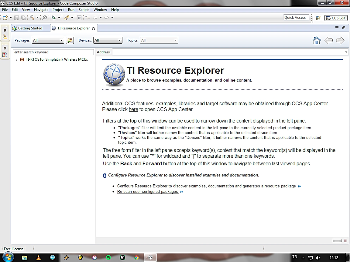

    Are you able to import the project from resource explorer?
  • i tried to import projects through ti resource example but ble stack for simplelinkMCUs is not exist
  • Can you delete the folder c:\ti and then reinstall ccs6.1 and BLE stack 2.1?
  • i did it but nothin changes.
    why the ble examples ar not exist? Main problem is this?
  • can you click on Window, and then navigate to the following section?
    If it's possible, could you delete the original installer, and download again?
