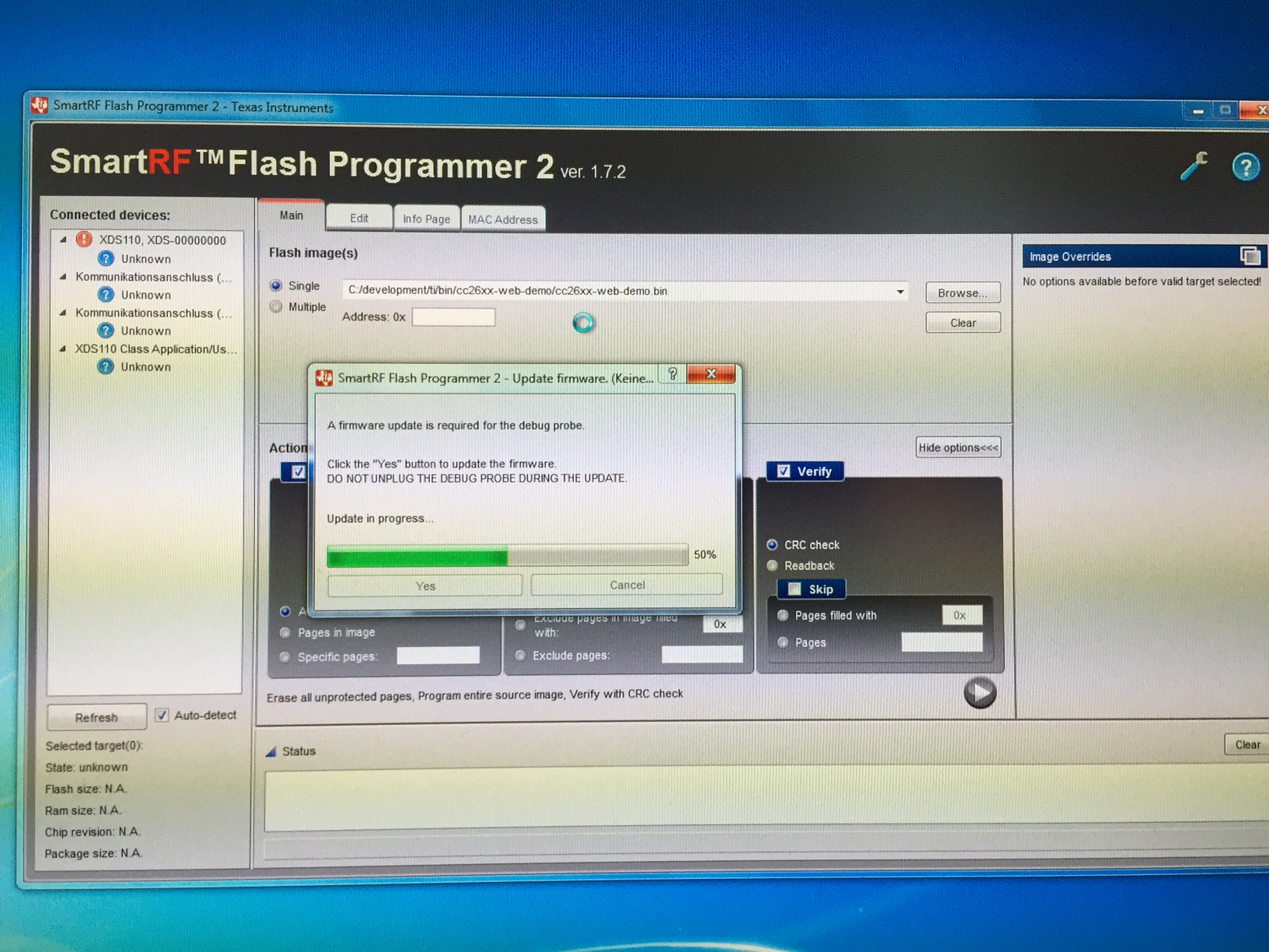

I set up a brand new Windows7 PC and installed the "SmartRF Flash Programmer 2" (Version 1.7.2) in order to flash the Sensortag 2: cc2650stk
I have also bougth the SimpleLink SensorTag Debugger DevPack to carry out the task.
However ... when i connect the DevPack (with or without the Sensor Tag attached !!! With or without the battery !!!) to the PC using the USB cable, the "SmartRF Flash Programmer 2" Software list the DevPack with an red exclamation point. When i select the item ("XSD110, ...") a dialog pops up, telling me that a firmware update is required for the debug probe.
When i click "Yes" ... it jumps to 50% and get stuck there. I have to kill the "SmartRF Flash Programmer 2"...
WTF...

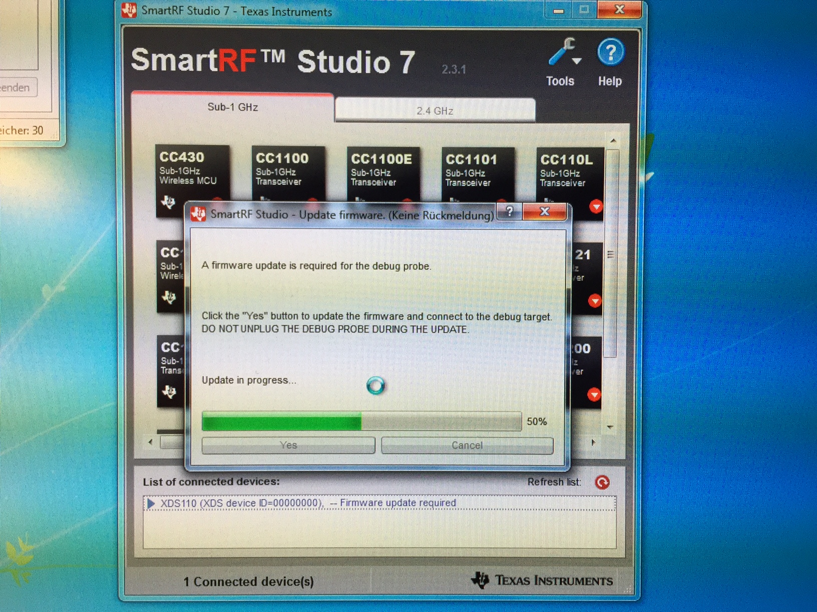

  • By the way... I get the same result using the "SmartRF Studio 7" Software...
  • The trick mentioned in the paragraph "Device Firmware Upgrade" mentioned here Debug DevPack User Guide SensorTag with Debug DevPack doesnt help...

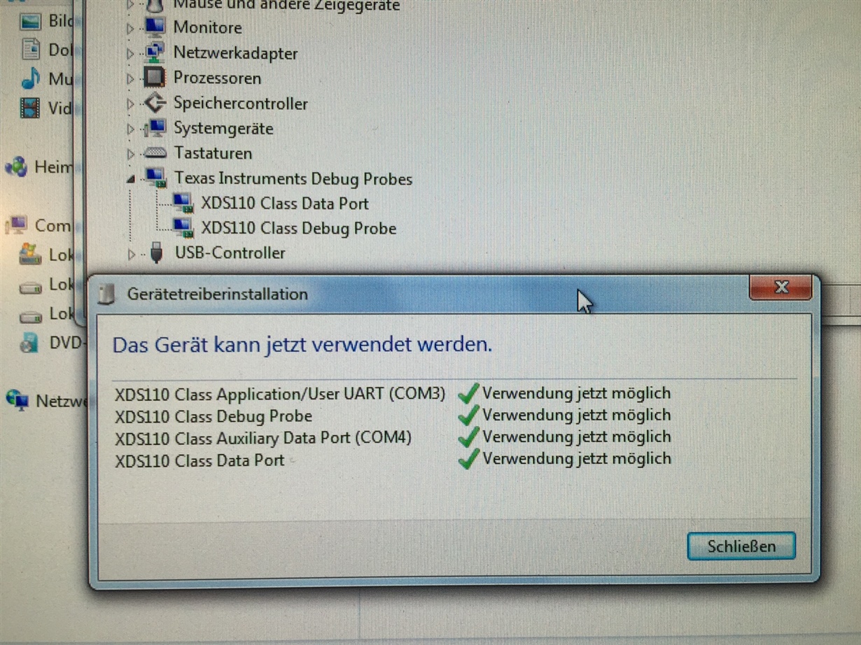

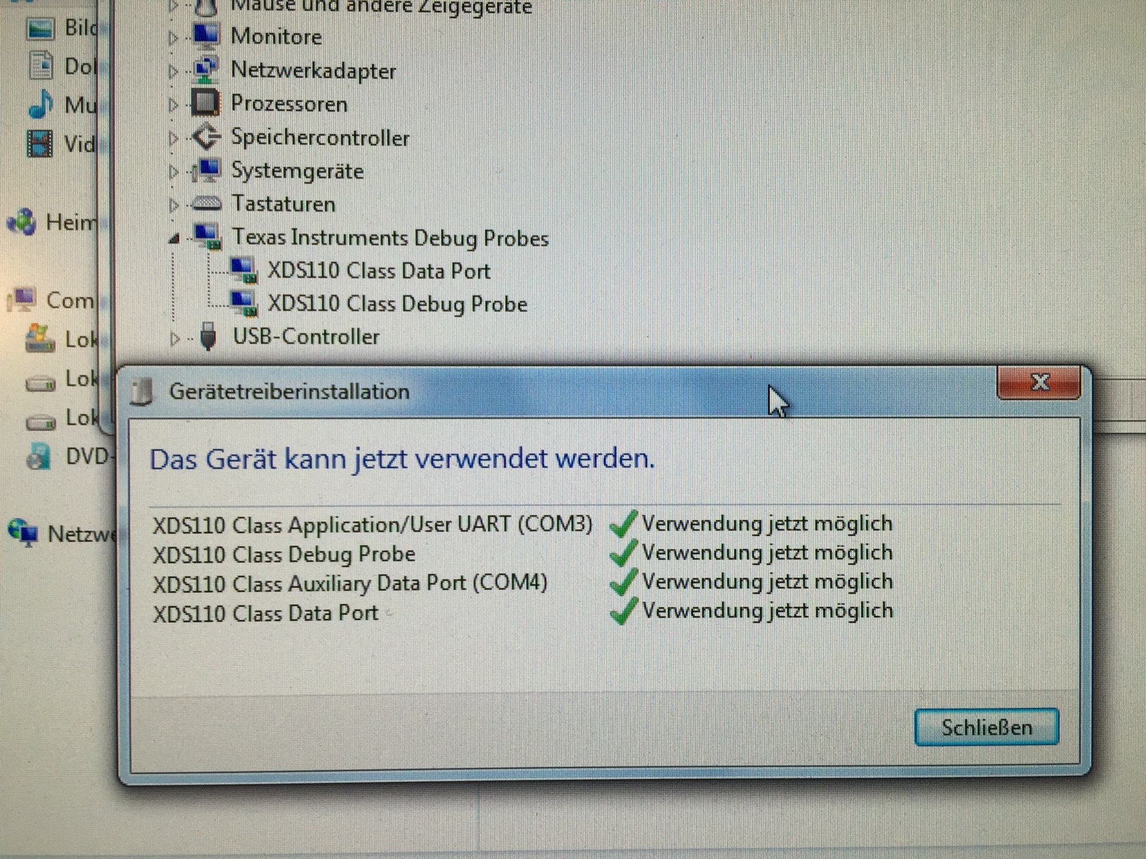

    2. The XDS110 Debug Probes Came with the "SmartRF Flash Programmer 2". Just in case something went wrong i installed the
        complete Code Composer Studio (adding the XDS110 Debug Probes).
        As far as i can see, the debug probes are up and running. Pls see screenshot below.

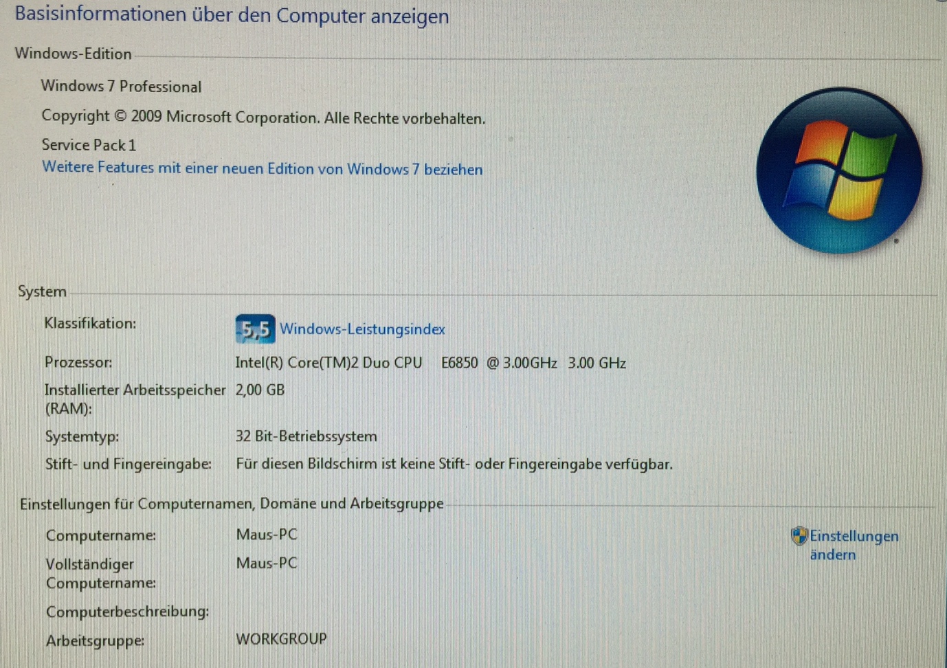

    3. My PC hardware isn't the very newest, which dfinitely means, that Windows has all the drivers on board.
        And the Win7 installation made no problems. Pls see screenshot below for details.
        Its an installation on native hardware. No virtual machine.

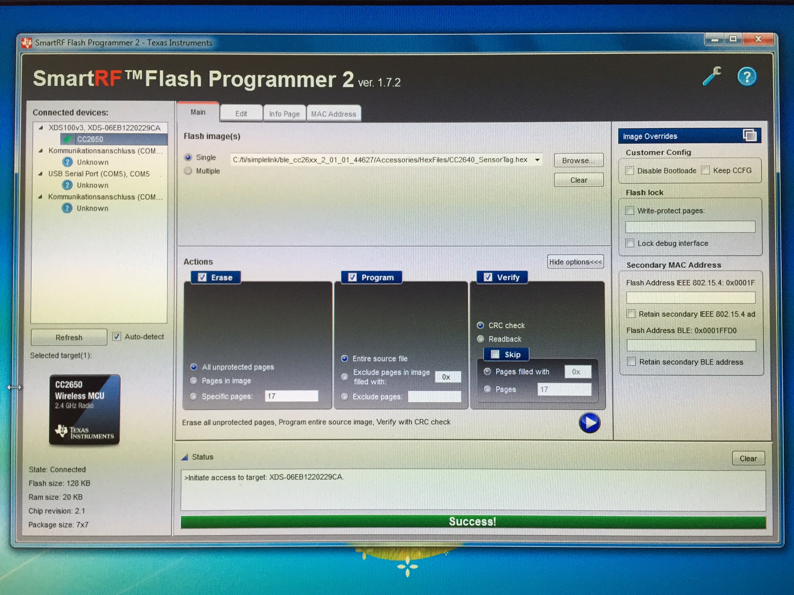

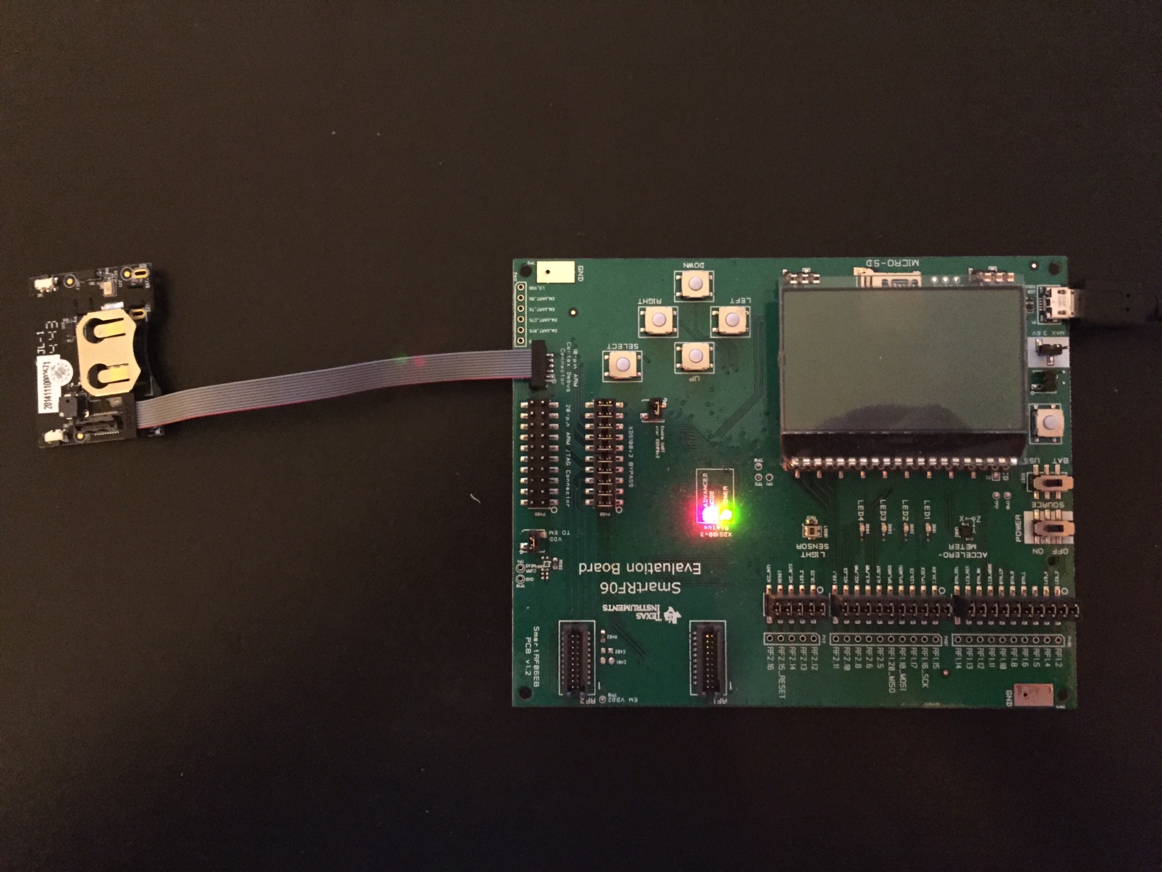

    In the meantime i succeded in flashing the SensorTag 2, using the "SmartRF 06 Evaluation Board".
    I tried to flash the SensorTag 2 with the TI pre installed demo firmware, found in the "Bluetooth Low Energy Software Stack"
    , that can be used together wit the iOS SensorTag App from the App Store (ti/simplelink/ble_cc26xx_2_01_01_44627/CC2640_SensorTag.hex).
    Unfortunately with no success. The iOS App didn't find the Sensortag... But that is a later problem... ;-)

    The screenshot below shows the SmartRF Flash Programmer 2 using the "SmartRF 06 Eval Board".
    The picture below shows the Eval Board and the connected SensorTag 2
    The picture below shows the device manager of my Win7 PC
    The picture below shows the essential data of my Win7 PC.
    (In german, but i think it's still clear, what it says)
