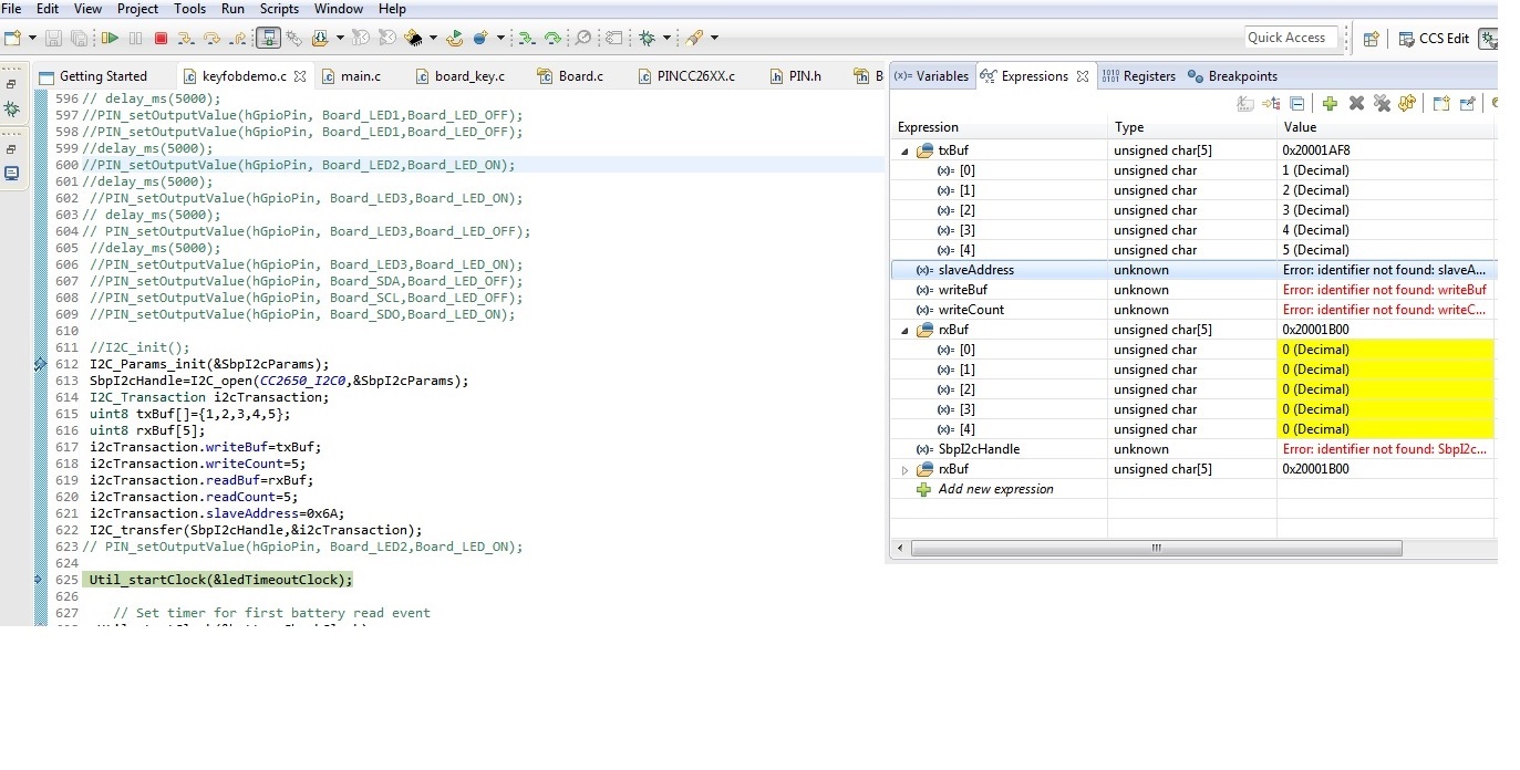

  • Hi Christin,
    I have added this in keyfobdemo_init(). I have specified the slave address as D4 of LSM6DS3.I tried to transfer some data through I2C , but after debugging i cant see anything in rxBuf.
    I2C_Params_init(&SbpI2cParams);
    SbpI2cHandle=I2C_open(CC2650_I2C0,&SbpI2cParams);
    I2C_Transaction i2cTransaction;
    uint8 txBuf[]={0,1,2,3,4};
    uint8 rxBuf[5];
    i2cTransaction.writeBuf=txBuf;
    i2cTransaction.writeCount=5;
    i2cTransaction.readBuf=rxBuf;
    i2cTransaction.readCount=5;
    i2cTransaction.slaveAddress=0xD4;
    I2C_transfer(SbpI2cHandle,&i2cTransaction);

    The SW might be too optimized to see content in rxBuf. You can try :
    1. declare rxBuf as static
    2. use logic analyzer to check your TX and RX line.
    3. check if I2C_transfer returns Success or Fail.

  • Hi Christin,
    I tried the below code and the I2C transfer is happening for 5 iterations and each time i am able to turn On LED, But each time i am receiving zeros in the rxBuf instead of 1,2,3,4,5
    /I2C_init();
    uint8 txBuf[]={1,2,3,4,5};
    uint8 rxBuf[5];
    i2cTransaction.slaveAddress=0x6A;
    while(1)
    if(I2C_transfer(SbpI2cHandle,&i2cTransaction))
    PIN_setOutputValue(hGpioPin, Board_LED1,Board_LED_ON);
    Best Wishes
    Mark
  • Hi Christin,
    I did some experiment with the code and tried changing from txBuf[]={1,2,3,4,5} to some different set of value txBuf[]={8,8,8,8,8};
    Then when i debug its showing the previous txbuf values in rxbuf ie is 1,2,3,4.5.
    The problem is i think its not reading the exact memory where it was written. Can you tell what is going wrong here?
