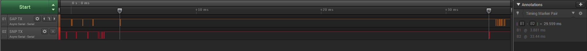

  • Follow up:
    I got a logic analyzer and now I'm seeing this behavior on the bus:
    Above seen is the reset handshake, power up indication and then the HCI reset sent from the SAP to the SNP.
    After the first NPI packet , the SNP is responding to a CHIRP after a long delay of about 30ms. Is this normal? I didn't change the SNP code.

  • The traces I used using the SWV were on the SAP on the STM32 MCU. As I've disabled it, it's not an issue and the MCUs are responsive.
    The capture from the logic analyzer is showing something else. The power up in was sent and then it's time for the SNP reset, like you've mentioned. What you see is the chirp from the SAP, a 30 ms delay, chirp from the SNP, and the reset command. I see the delay caused by the CC2650 reset later and that is about 100ms delay.
    The 30ms delay is puzzling.

    https://e2e.ti.com/cfs-file/__key/communityserver-discussions-components-files/538/1-MHz_2C00_-2-M-Samples-_5B00_8_5D00_.7z
  • This delay is indeed coming from the CC2650. Changing optimization of the SNP project modifies the delay. When the optimization is low, the delay is about 30ms, as shown in the earlier logic trace. When I change the optimization to high (size/speed) then it comes down to ~22-24ms. I've attached a trace of a run with high optimization.
    Is there any logic trace that you can provide me with to use as a reference?
    Thanks.
    https://e2e.ti.com/cfs-file/__key/communityserver-discussions-components-files/538/3-MHz_2C00_-6-M-Samples-_5B00_45_5D00_.7z

  • I was playing with the optimizations just to understand the protocol behavior. I'll leave the optimization on high from now on.
    It seems that this behavior is the same in your trace - that it takes ~24ms for the cc2650 to respond to a chirp.
    This is affecting severely on the NPI throughput and BLE throughput.
    Any idea on where is this coming from and how to lower this delay?
    Thanks.
  • So the delay is coming from the NPITLUART_openTransport function's loop:

  • Next issue I'm encountering with the SW handshake:
    1. SNP (cc2650) sends a chirp
    2. SAP ACKs the chirp within 90-150us
    3. read callback is not registered on the SNP
    4. protocol continues with chirp timeouts from the SNP forever
    This behavior does not happen in the same place at the same time, but it's occurring seldom.
    Not sure about it, but this fault looks like it's happening when the SAP starts sending a NPI packet after successful packet transmission from the SAP.
    I'm attaching a logic trace of a sample failure.
    I've added to the SAP protocol ability to acknowledge timeout chirp, even if the SAP already chirped back already.
    Also, for debug purpose, I've removed the SNP reset from the initialization protocol. It does not affect the bug occurrence.
    I'll appreciate the help.

  • Hi Gregory,
    I have review your logic trace and agree with your analysis. Can you try enabling NPI_SW_HANDSHAKING_DEBUG which will toggle a GPIO during the critical section where a chirp may be missed?
    This can provide some insight as to why the SNP may be missing the chirp. In any case it should be handling the repeated chirps.
  • I've added the symbol SWHS_DEBUG. It changed in commit d5421b5c.
    Attached is the logic trace. This time it happened after connecting to the BLE central and after sending a few dozen notifications.
    https://e2e.ti.com/cfs-file/__key/communityserver-discussions-components-files/538/6-MHz_2C00_-1-B-Samples-_5B00_7_5D00_.7z
