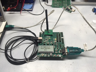

  • Can you take a picture show me how you connect all these SmartRF05 and USB to serial things?
  • Attached is the diagram requested of the connections between the SmartRF05EM and PC (serial - USB and USB - USB). I embedded in this post. Did not now how to send attachment. Hope it shows  up
    As mentioned, all the port configurations in PC Device Manager are the same as the Btool and BLE Device Manager even when trying different combinations The Central SmartRF has the HostTestApplicationAl load. and the Serial port switch enabled.  Please let me know what is missing or wrong with our configuration. --Alejandro

  • Attached is the picture of cable connections.
    A recap of my set up is
    usb to SMARTFR05 and SMARTFB05EM powered up
    RS232 serial cable connected to SMARTFR05 and USB to PC.
    Tryed with RS232 switch enabled and disabled with same results.
    On BTool as per document
    PortCom3 –USB-Serial CH340
    Baud in document says 57600  used 115200 per suggestion (both same results)
    Flow None (doc says CTS/RTS but PC port does not have that option)
    Parity None
    Stop Bits One
    Data Bits 8
    Device Manager on PC
    sees the usb-serial connection, error free
    Same as above (no Flow CTS/RTS option on PC so using None)
  • Every thing looks correct. Can you download and install TI BLE device monitor from processors.wiki.ti.com/.../BLE_Device_Monitor_User_Guide and test with it instead of Btool?
