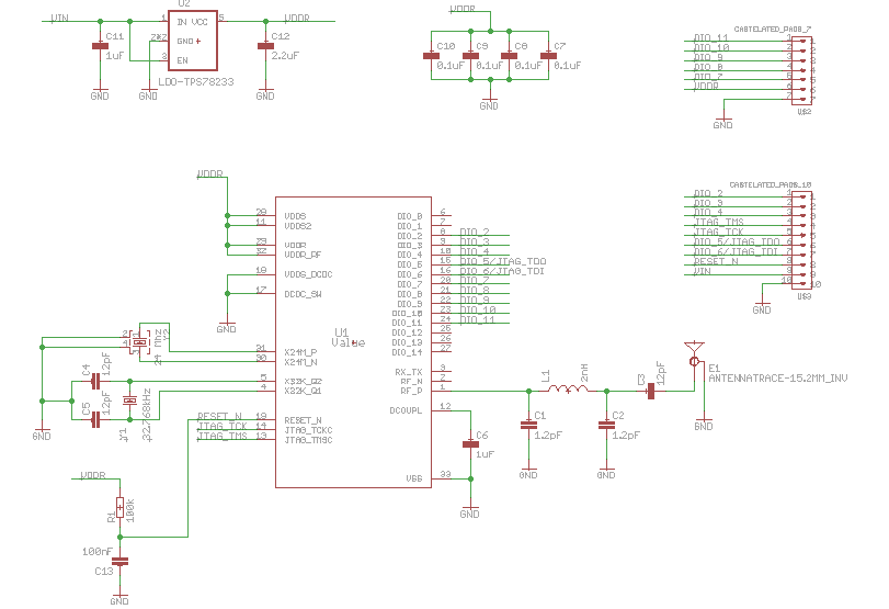

  • have you tried bypassing/removing your DCDC and used external power? Or tried adding a bead from after the DCDC like in our ref design? How high capacitance did you try?

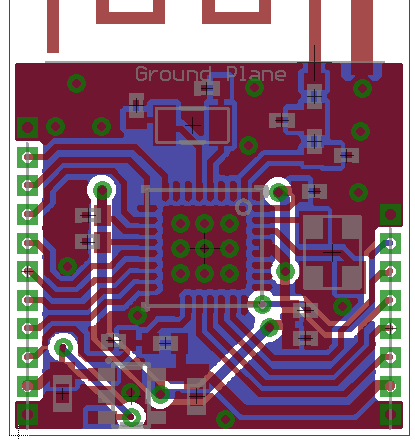

    Your schematic looks ok, did you disable the DCDC in SW as well? I do not see anything in your layout that I would suspect causing this either. For future versions of the PCB, to improve performance though, you can consider adding antenna tuning components, all RF comp should have separate vias to GND and there should be no routing between decoupling GND vias and the vias under the chip. Also, routing under the crystal traces is not recommended and distance from the RF pins to comp should be kept to a minimum. Also decoupling caps should be placed close to the pin it is to decouple.

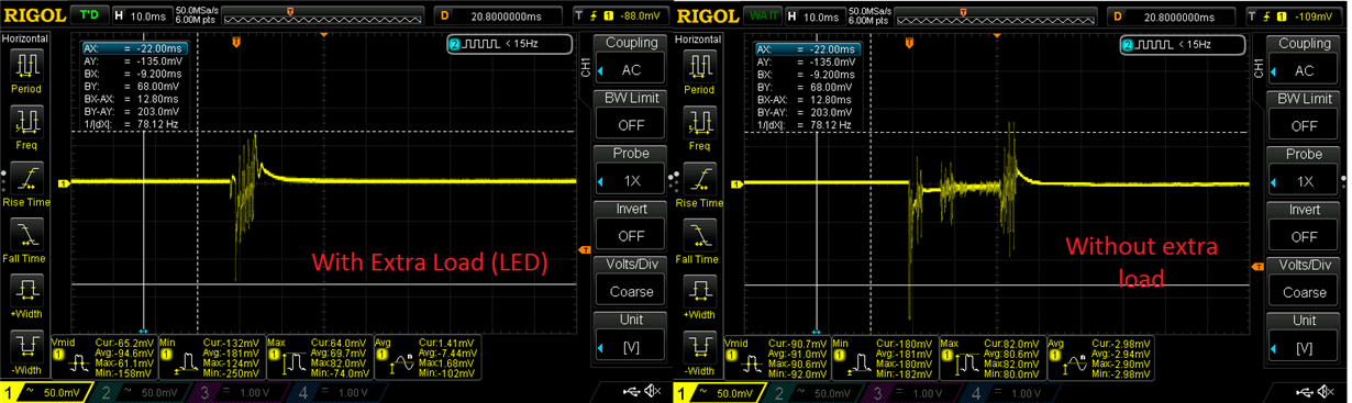

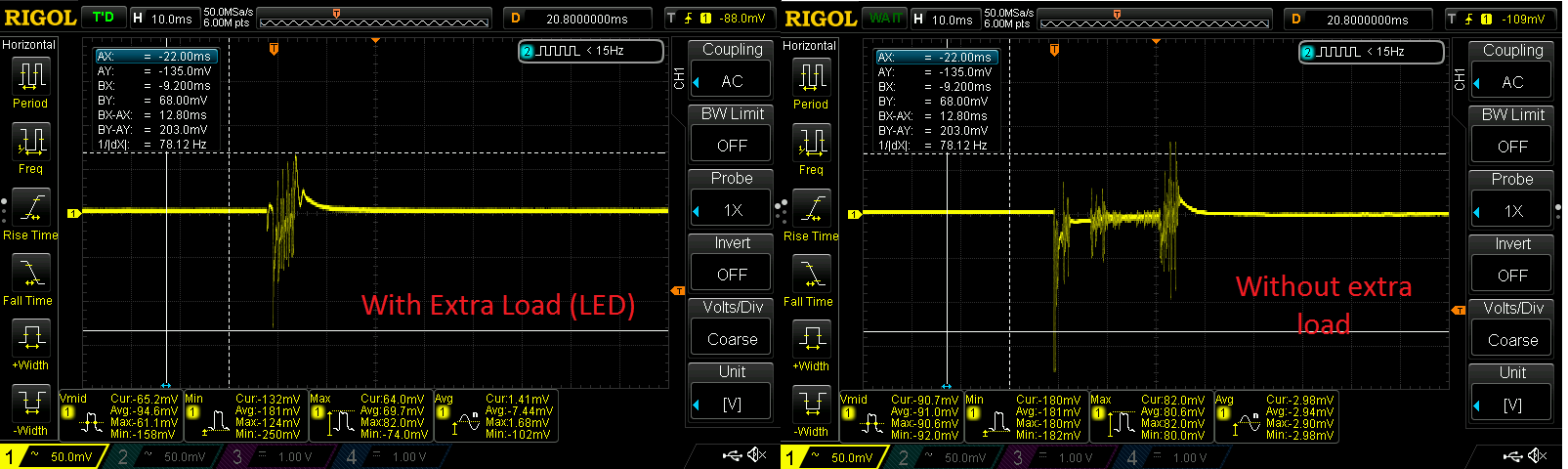

  • i think i know where the problem is. I used an oscilloscope to measure VDDR as CHS sugested and i obtained the signal when the advertising brust ocurr:
    As you can see when the load is inserted the drop in voltage is less than without load so i think that when the brust ocurrs it drops below the device minimun and the device resets, thats why there are more brusts after the first one (the device is reseting every advertising period!). that don't explains why i can connect to it.

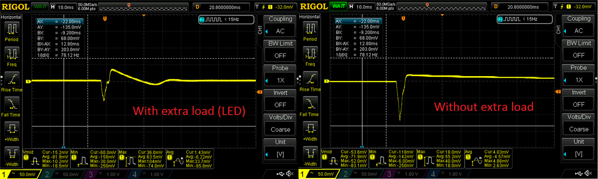

    i put some capacitor extra (10uF) to the TSP782 output but i keeps reseting, so i used a 100uF electrolitic capacitor and it works. Images with 100uF electerolitic capacitor:
    The brust is smaller so it dosen't drops below the limit.
    Oviusly the 100uF is not the solution, i need a better filter. what do you sugest me to use to minimize the efect of the brust? you said a bead, but i have no experience in this, can you tell me how to choose the right one?

    As I can see, your original circuit will fail without doubt. You should put at least 30uF close to VDDR. And another 10uF for system. Btw, as mentioned by CHS, the trace under crystal is pretty bad. You may encounter unstable issue in reliability test. I would recommend you to do a new layout.
