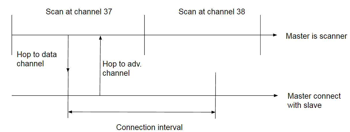

I have a question about the device be scanner or master role.
At first, scanner should scan the MAC address of advertisers on the ADV channels.
Then, initiator can connect with all advertisers by CONN_REQ alternately.
If master want to scan other devices, it will disconnect from slaves which is connecting or not.
It means that devices can be master, scanner, and initiator, right?
