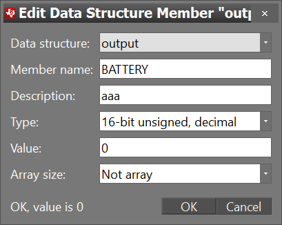

1.I am trying to use SCS to test the ADC function of CC2640, I added a Battery into the output data structure(shown in figure 1), why there is a error in the second page?
2. I tried to use utilIncrAndWrap function like in the "ADC data logger" example, the SCS report an error. can I directly use it or I have to configure some settings?
Thanks!

    Can you show me the details of your RAM variable output.BATTERY?
    Try using lower case letters in stead (battery).
  • Hi Eirik,
    Thanks for your quick reply! the picture below is the details of this variable.
    Di
  • Lower case works! thanks!
  • Great,
    1) It was indeed a bug and will be fixed in a future version.
    2) Go to task panel and enable Utilities -> Math and Logic.
