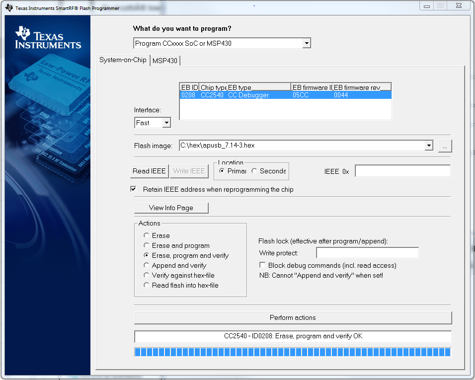

    Shown below is the SmartRF Programmer for the CC2540, UI version,
     I
    a)  Is the "Write Protect" field where I would protect the BIM sector?
    b) Is the value zero based or one-based.  i..e, should it be 0 or 1 for BIM?  I think it's zero-based and consequently 0 for protecting BIM, but please confirm.
    c) From the command line of SmartRFProgrammer, i.e.,  SmartRFProgConsole.exe, which option achieves the same thing as protecting from the SmartRFProgrammer UI?  Is it LP(0)? (of course, assuming 0 is for protecting BIM)
    I will verify this in code as you suggested in SWRU191 chapter 3.4.
    In the "Write protect" field, you specify the pages you want to protect. For example, if you want to protect page 0 and 2 through 5, you specify
    0,2-5
    Yes, that's correct. The LP(x-y) option is available for CC253x and CC254x devices. The CLI will print out the documentation if you run SmartRFProgConsole.exe without any arguments. Excerpt:
    LP(x-y)  Write protect flash pages from page x to page y.
             Several ranges can be given separated with a comma:
             E.g. LP(0-26,48-126), LP(0,1,2,8-10).
    Br,
    TIABO
  • Thanks TIABO for your quick response.
    This takes care of it. I programmed the device using "SmartRFProgConsole.exe S EPV F=foo.hex LP(0)".   I was able to verify it by reading back the last page using "SmartRFProgConsole.exe S RP=127 F=read5.bin" .  I saw one bit being flipped to zero, in the last 16 bytes of read5.bin.  If I omitted the LP(0) in the programming command, the bit was a 1.
    Much thanks again.  I would have marked your response as VERIFIED but I don't see the verify button.
