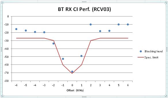

We have customer project with CC2564B chip and last week we got the second build from production. All ATE measurement cases was in the specification limits except CI Performance of BT classic and EDR. It Fails always when interfering signal is 2 MHz below the wanted channel. Fail not depend of used channel.
We measured this also manually and got the same results.
Below chart of test results.
Have you any idea what is the root cause of this behaviour? Is it possible to tune RX-filter in the chip by the code?
