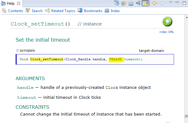

  • I have already implemented it using 2 hours clock timeout increment a variable and comparing of certain hours have been passed ..
    but the point is that i did watched uint32 in the "Clock_setTimeout" function it should be mentioned somewhere max value of timeout we can pass in that function :/
    Nice.
    If you open help (F1) in CCS and search for the function you will find some details. Remember that the timeout is in clock ticks and the clock tick period (Clock.tickPeriod) is set in the project TI-RTOS config file (.cfg), meaning it can vary. When system tick period is set to 10 us the maximum duration will be:
    (2^32*10 us)/(1e6*60*60) = 11.930465 Hours.

    I figured out the calculations also by applying break point
    I think this calculation for max timeout should be mention in the guide or at least as a warning of overflow in the clock construction section of software developement guide
