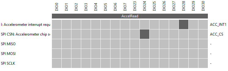

I am trying to use SmartRF06 on-board accelerometer via SPI from Sensor Controller Studio and cannot figure out how to map MISO, MOSI and SCLK pins. According to SmartRF06 Evaluation Board User’s Guide (SWRU321A) those signals are mapped to RF1.20, RF1.18 and RF1.16 connector pins respectively.
According to SimpleLink CC2650 EVM Kit 7ID (CC2650EM-7ID) v1.2.6 Design Files those lines correspond to CC2650 controller's pins DIO_8, DIO_9, DIO_10, but they are not available in the SCS I/O Mapping tab.
How can I configure SCS for using these SPI pins? Or what is the valid configuration for using SmartRF06 accelerometer?
