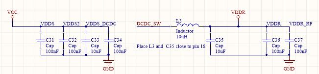

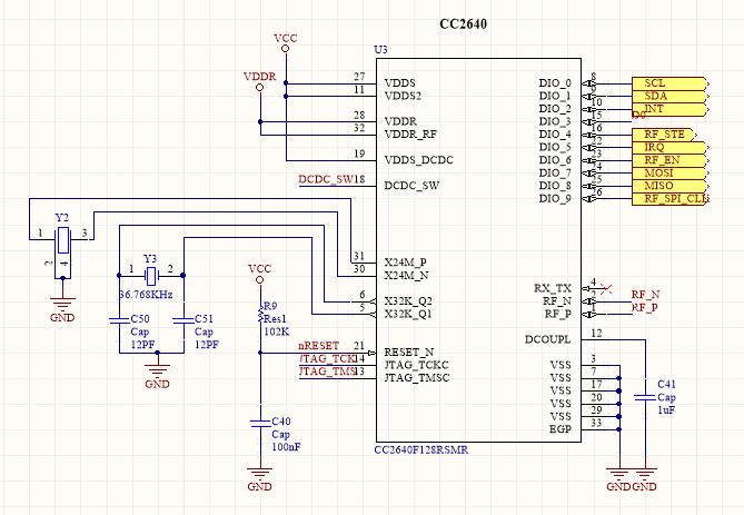

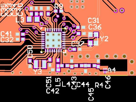

The relevant schematic part and the PCB layout are attached for better reference:
1/POWER SUPPLY
2/MCU
3/ ANTENNA (SINGLEENDDED)
4/PCB

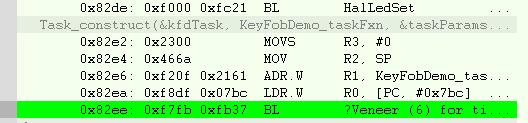

    Your description doesn't match the screen shots of the task construct debug session (e.g., you describe using SBP but the snapshot shows keyfob demo), so I suspect there are other variables that need to be accounted for but not described in your OP.

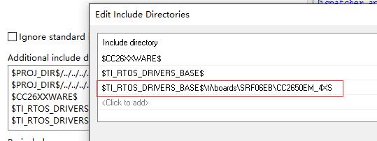

    Please take the the BLE-Stack v2.1.1 SBP project, change the board file include path to pick up the CC2650EM_4XS board file (as per guidance in the SW Dev Guide SWRU393), disable the LCD and SPI drivers in the App project settings. Next, remove all pins from your BoardGpioInitTable so that just PIN_TERMINATE is listed.

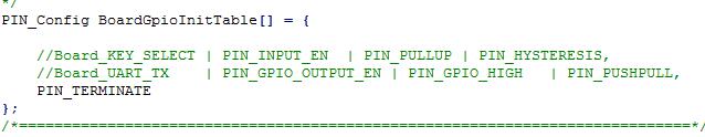

    Oh I attached the wrong snapshot. I ran both the peripheral and the modified keyfob project on my custom board and the same problem exit: it could not enter the  taskFxn().
    As you suggested, I took the BLE-STACK v2.1.1 SBP project, changed the board file and included the path to pick it up, and disabled the LCD and SPI drivers:
    However, the program was still not able to enter the taskFxn().
    I ve set the Code Optimization level to the lowest, but I cannot single step into the TaskFxn(). I can only see it ran in the Disassembly window.

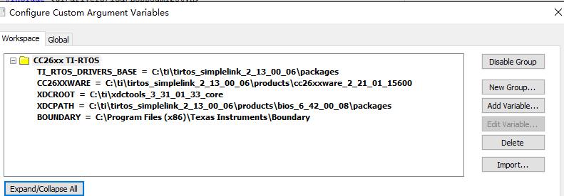

    I included the driverlib files, but when making, an error occurs: cannot open source file "diverlib/aon_iocc.h". this is my Custom Argument Variables setting:
    You should not delete the Power_setConstraint part of code in the main.c. The purpose of deleting POWER_SAVING from the predefined symbol is that in the main.c if the program sees that POWER_SAVING is not defined, therefore device does not go to sleep.
    Also you have typo in diverlib/aon_iocc.h --> should be driverlib/aon_ioc.h

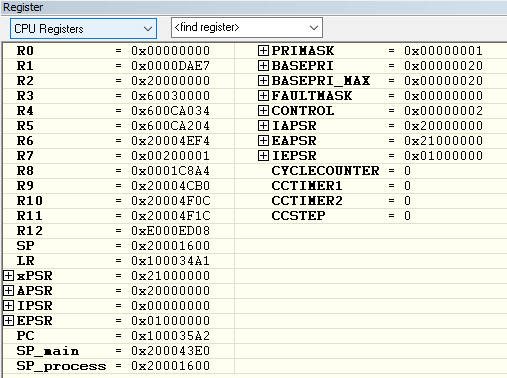

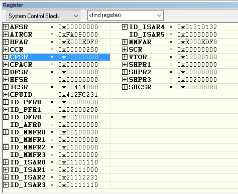

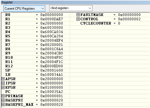

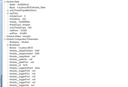

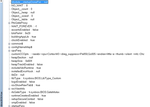

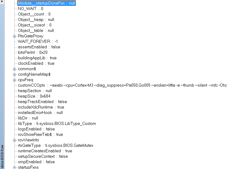

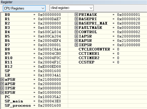

    Can you follow the steps in Chapter 9 of the Software Developer's guide under Deciphering CPU exceptions and take screenshots of the registers and ROV at the time of failure?
  • Hi Sean,

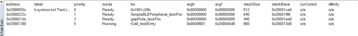

    I noticed that when the program runs to the BIOS_start() function, the TI-RTOS->Task->basic subview shows that the mode of the SimpleBLEPeripheral_taskFxn is ready. But when I single step into the BIOS_start(), which is supposed to reach SimpleBLEPeripheral_init(), instead it seems to enter an infinite loop. So I figure that the task is constructed but something went wrong in the BIOS_start()?
    Below are the screenshots of some of the register and ROV subviews (which i think might be relevant) at the time when I single step into the BIOS_start():
    BR.
    shuting

  • There is no fault reported from the register readout and TI-RTOS task view looks right to me, the device should be advertising.
    Can you set #pragma optimize=none on the simpleBLEPeripheral_init function and see if you can step into it?

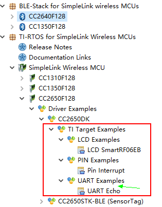

    Can you just try simple example in our TI-RTOS, like pin_standby, pin shutdown to see if your device can enter standby or shutdown without problem?
    The examples can be found in CCS resource explorer.
  • Hi Christin,
    I cant find the pin_standby nor the pin_shutdown example in the CCS resource explorer, but the pin_interrupt example. But there is no buttons connected to any DIOs on my custom board. So I can't test those example involving bottom-pressing action. However, I did test the UARTECHO_CC2650F128 example in the TI-RTOS and It works fine.

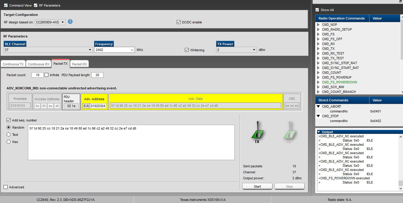

  • I cannot see any show stoppers in the HW design. The RF layout is not optimal, but this will not break SW execution.
    To verify if the 24 MHz crystal is running properly, you can try to control the radio from SmartRF Studio. If the oscillator is not starting you will get an error message in Studio.
    Cheers,
    Fredrik

    I ran it and selected the Packet TX and started the transmitting with the default setups. I noticed in the Output window all the status indicated IDLE during the operation. So Clearly the radio part doesn't work. You mentioned that if the oscillator is not starting i will get an error message but I did not noticed any notification. Or maybe I did not know where to look for.
    So I m not sure if it's the 24MHZ XTALS or the antenna. I attached a snapshot of the Control panel below. May you have a look?
    But the way there is no external loading capacitance on my board for the 24Mhz Xtal and I have enabled the XOSC cap-array delta and Set its value to match the requirement capacitance of 8 pf for the Xtal. But I could not find the DDI0-OSC ANABYPASSVALUE1 register to check out the value. I went through all the registers in the IAR registers window. Where do I find it?
