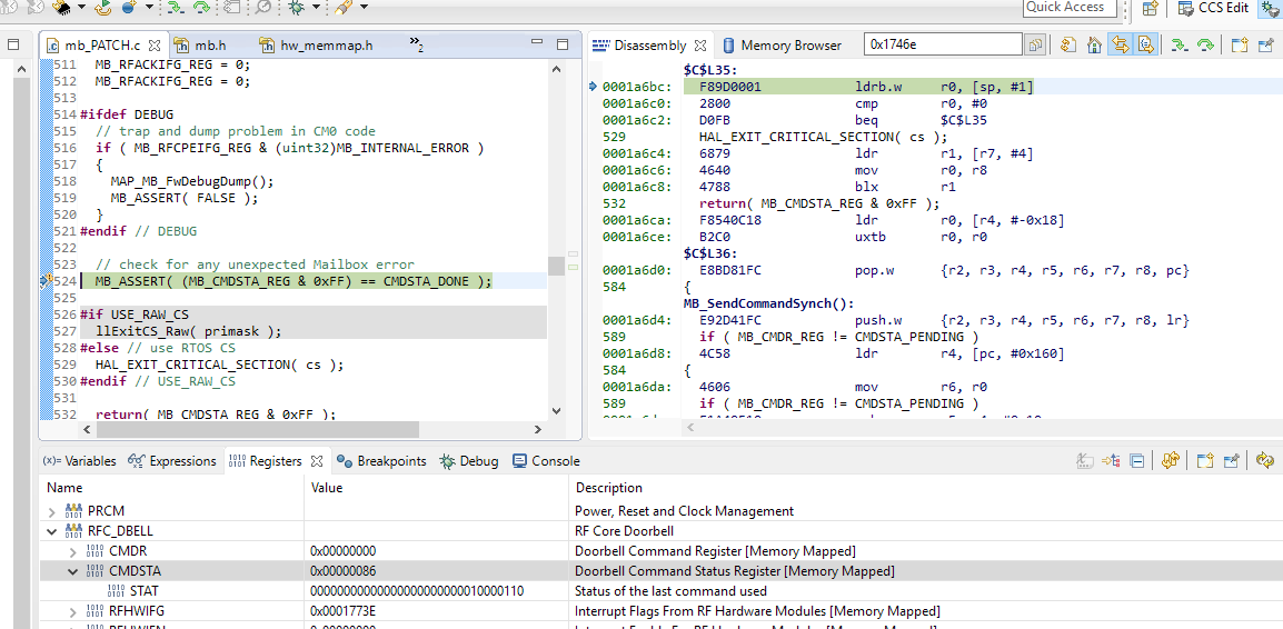

when trying to implement multirole feature in my CC2640 project (adding observer to a peripheral device) I see a crash of the application approx once in 48h. Crash means no more advertising, application stops. When debugging into a crashed device, I see an assertion fail in line 524 of mb_Patch.c
When reading out the CMDSTA register, I see 0x86 (SchedulingError)
What would be a proper reaction on this case? The current while(1) loop helps to debug the issue, but my device is not reactive any more. Is it possible to just ignore the issue and continue normal operation? Would a system reset be appropriate?

    Actually, at this moment, I have kind of a workaround: I only start discovery as a reaction of a Advertising end event (using HCI_EXT_AdvEventNoticeCmd). With this, I don't run into the SchedulingError issue any more, but approximately in the same time period (once a day) my device stops advertising. I monitor this with a timeout of advertising and as a reaction reset my whole device. For now, I can live with this workaround, because the field test will accept the little blackouts, but the final device need to do this properly.
