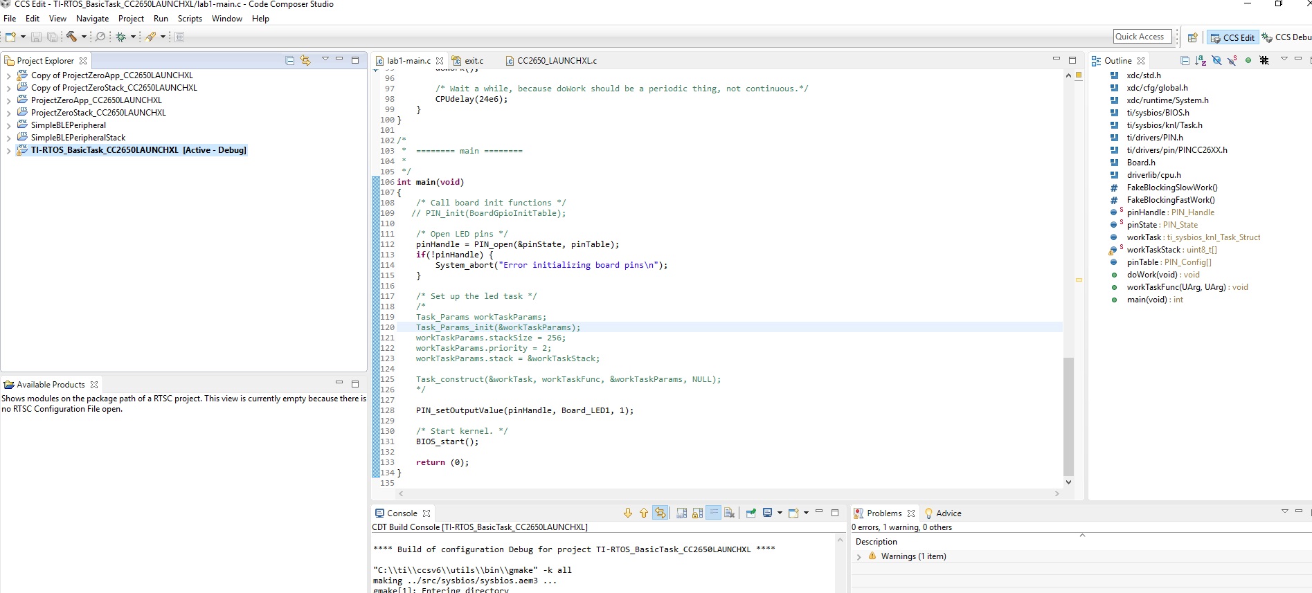

I am a newbie in TI-RTOS world, I have my  development board based on CC2640 device. I am trying to blink an LED that I connected to DIO3. I have a CC2650 Launchpad and I am running the Lab1 (BasicTask) example which I found in TI SimpleLİnk Academy.
I have changed the pin number on board.h file because the led on my board connected to DIO3 and the led on cc2650 launchpad is connected to DIO6. I can successfully upload the code to my custom board, using the onboard xds110 of launchpad (I am using jumper wires between my board and launchpad in order to program my custom board using the Launcpad's onboard xds110)
However when I press the resume button on CCS Debug window (so that the pragram that I successfully loaded into my custom board will run and blink the led), the program aborts. I tried the program the CC2650 launchpad before any modification on the board files and the led blinks succesfully. This is the Lab1(BasicTask example) project that I am trying to modify for my custom board ;
software-dl.ti.com/.../tirtos_01_basic.html
In the RTOS Object Viewer, it seems like the task(which blinks LED) never runs. I am attaching the debug window screenshut below ;
And this is what I get on Console after runnig the progrom on CCS debug window ;
[Cortex_M3_0] {module#38}: line 1087: error {id:0x120000, args:[0x4028, 0x0]}

    Can you try to move the LED toggle into main.c before bios_start() so that we know that you can actually control the device?

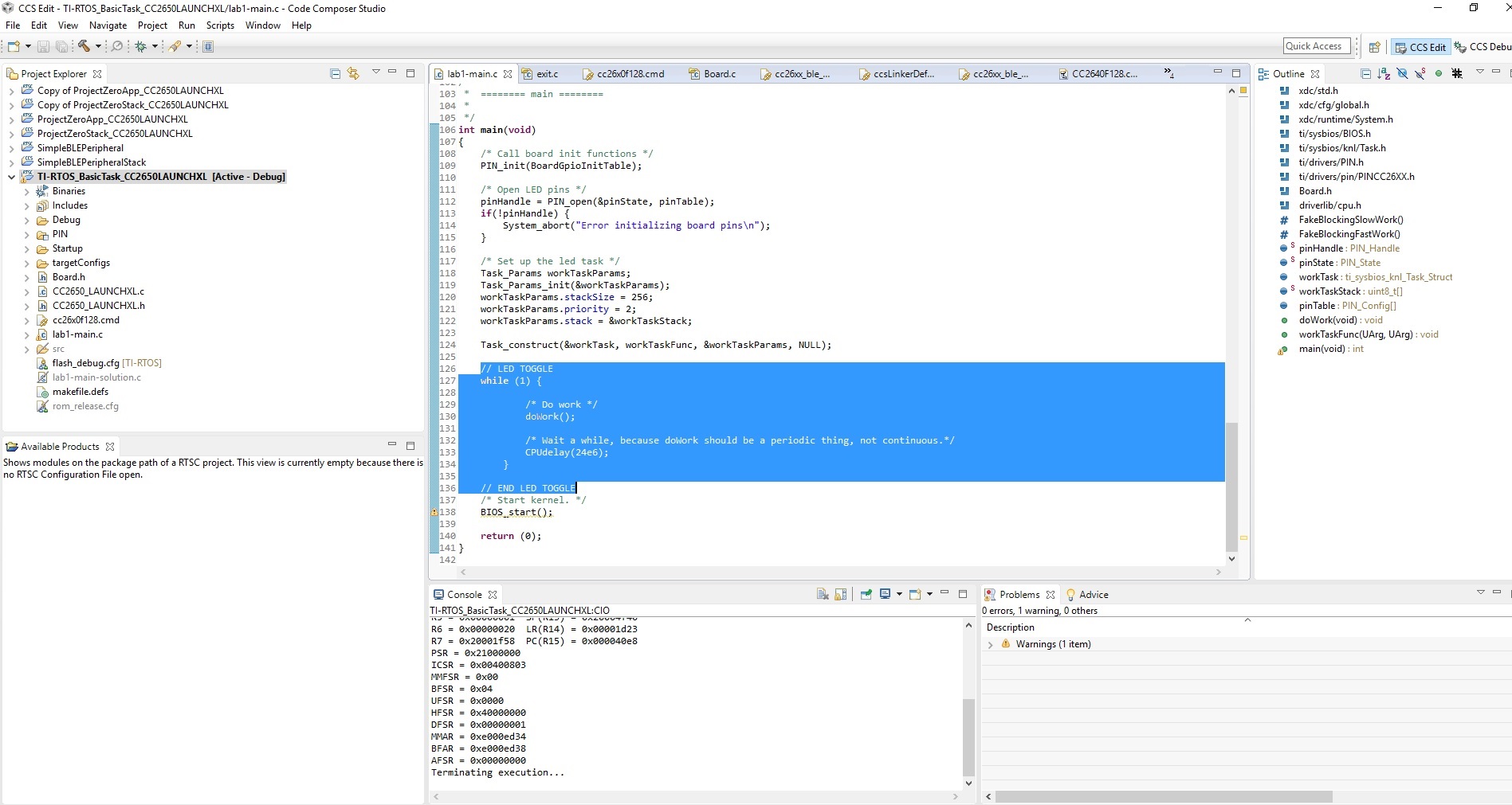

  • I copied the related piece of code  right beforr bios_start() as seen below ;
     And this is what I am getting when I try to run it on the debug window ;
    The led on my custom board does not blink again.
    Can you please let me know what do you mean by "controlling the device".. Does this result mean that the code does not downloaded into the cc2640 ? Please note that I am getting no error while downloading my code into my custom board. It seems to be downlaoded into my board successfully..

    Can you just use Pin_setOutputValue() in your main.c instead of the while (1), and also commend out the task construct.
    The whole main should have only PIN_open, Pin_setOutputValue and then bios_start.
    After you enter bios_start, can you also check the current on your custom HW to see if the device actually goes into standby mode?
    I commented out the task construct and only used PIN_open, Pin_setOutputVlue and then bios_start as can be seen below (I also tried without commenting out the "PIN_init(BoardGPIOInıtTable" but there was no change in the results that I summerized below)  ;
