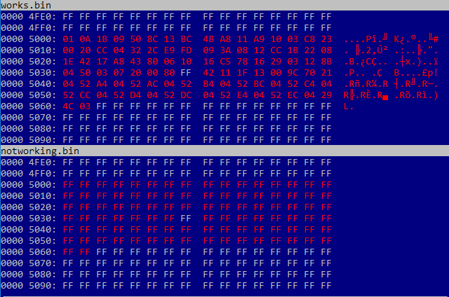

  • Can you generate hex image and program into 2 devices. Read out the flash content by flash programmer 2 to compare see if there is something with JTAG on the second board?
  • Hi Christin,

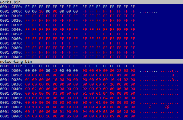

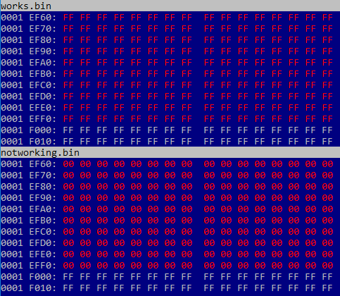

    I did as you proposed and read all flash image to a binary file for both circuits. I then compared them with a binary compare tool and there were different parts. I added the different parts of the binary files below.
    Here the working circuit is "works" and the problematic circuit is "notworking". The addresses between the second snippet and the third one are almost all zeros, so the rest is also different from each other.
