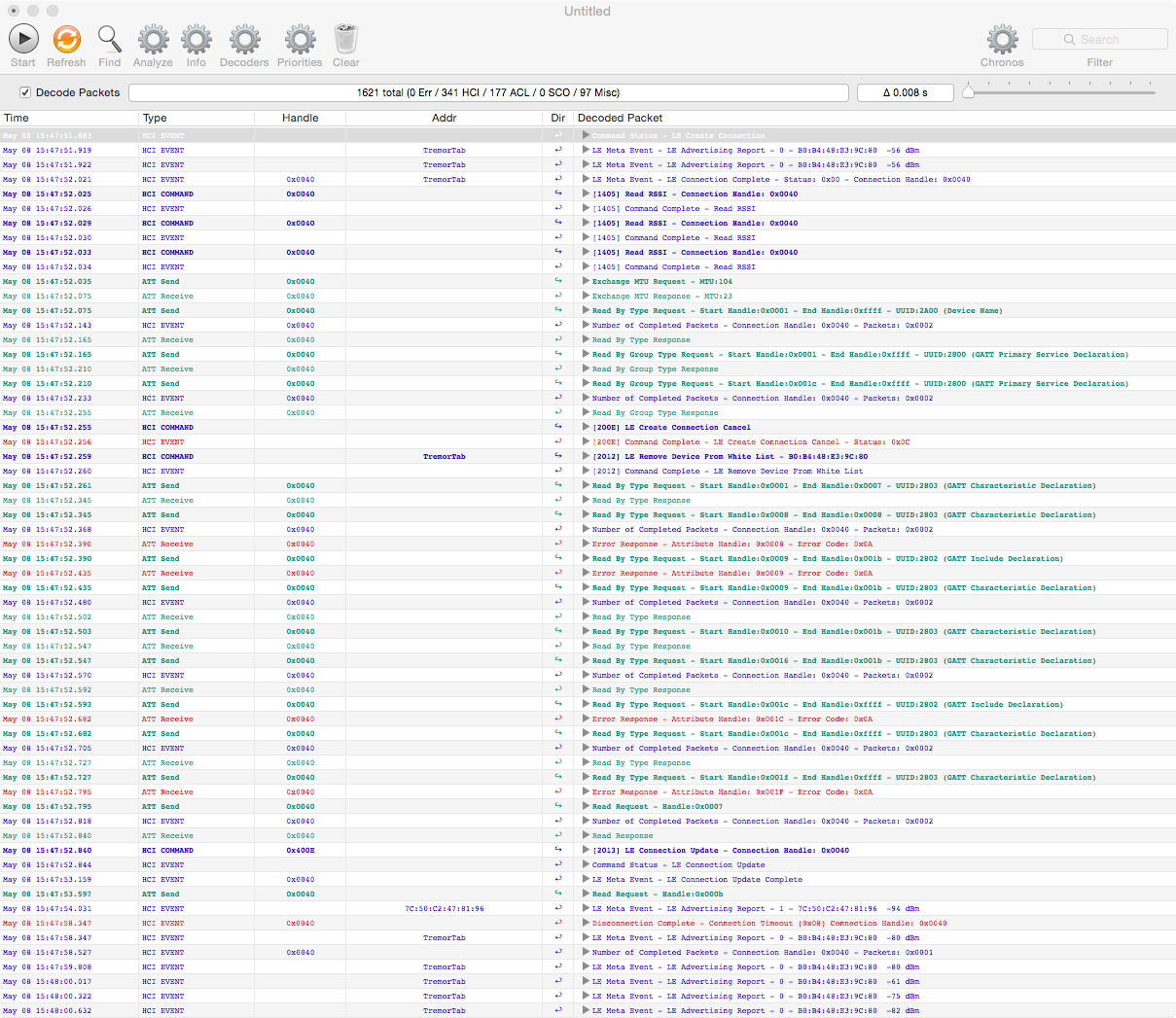

    I don't have access to a Packet Sniffer at the moment (I am trying to get my hands on the 2541 dongle). I have used the Mac Developer Tools' Packet Logger though, which basically logs everything from the Mac's point of view.
    There are a couple of commands that it is logging that I am unsure about: firstly - LE Create Connection Cancel, that my device sends is basically rejected by the Mac with status disallowed - I tried Googling what this command is supposed to do but I couldn't find it.
    Secondly - there is a read request at 15:47:53.597 that appears to go unanswered - then the connection times out after that (exactly five seconds after, which the default supervisor timeout period for the Mac - I don't think this can be changed?). My thinking is that there is no packet transmitted from the device after this request, and it is this read request is causing an error on the device (a packet sniffer would confirm my suspicions here).

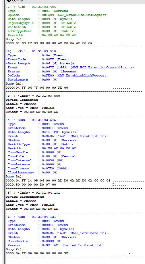

    This is somewhat confirmed by using a CC2650-EM and SmartRF06 board and BLE Central flashed to it, I can connect (intermittently) and it either fails to connect sometimes with code 62 or disconnects with code 08 (timeout), and similarly using HostTestApp + BTool (see screenshot).
    If this is an issue with the timing and crystals, what options do I have in software to rectify this, (as in the long term I will obviously redesign the board and include a low speed crystal)? I have tried increasing the clock +/- accuracy in the firmware, but this hasn't had any noticeable effect on the issue.
