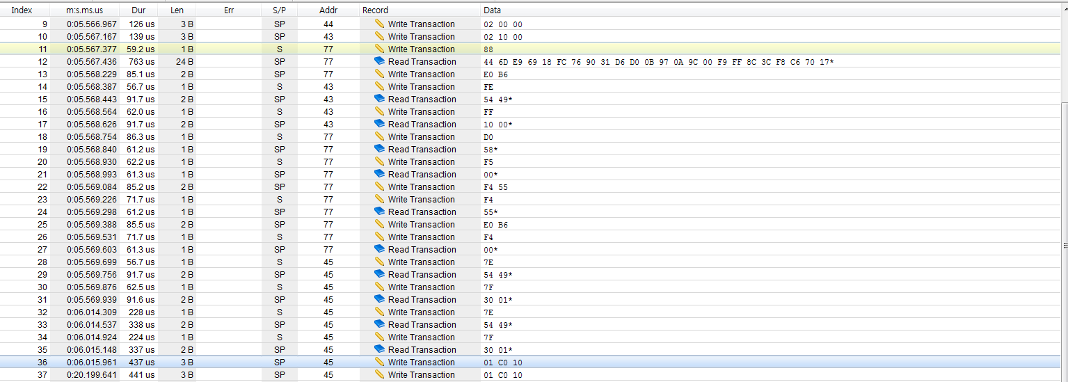

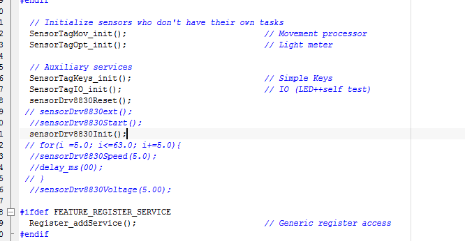

Hi Motor Applications Team
Because it may be a hardware problem, it bought as a new product..
I try to control a DC motor using cc2650STK and drv8830EVM.
What drv8830EVM is classified as an external sensor?
According to the datasheet opt, tmp, such as sensors that are specified interface ID, device ID.
A sensor for use in accordance with 0, 1 value in the interface ID is different.
drv8830EVM do it is to use the interface of either 0 or 1?
processors.wiki.ti.com/.../CC2650_SensorTag_User's_Guide
In accessing I2C devices from the link above, it is referred to the internal device address.
Drv8830EVM driver is also internal sensor?
Unless it's, device ID do I need for an external sensor is handled in sensortag?
I would like to operate the motor in the I2C communication.
Attach a position to run the driver source.
Blow is sensorTag.c

  // Initialize sensors who don't have their own tasks
  SensorTagMov_init();                            // Movement processor
  SensorTagOpt_init();                            // Light meter
  // Auxiliary services
  SensorTagKeys_init();                           // Simple Keys
  SensorTagIO_init();                             // IO (LED++self test)
  sensorDrv8830Reset();
 // sensorDrv8830ext();
  //sensorDrv8830Start();
  sensorDrv8830Init();
 // for(i =5.0; i<=63.0; i+=5.0){
  //sensorDrv8830Speed(5.0);
  //delay_ms(00);
  //sensorDrv8830Voltage(5.00);

I used a beagle i2c analyzer.
But the results are bmp, opt for slave address, slave address of drv8830 did not appear.
This means i2c communication did not occur. (Cc2650STK, drv8830 is a new product)
If so, the accompanying source code is the problem?
Please help me
Thank you.
