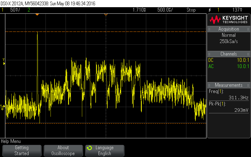

I'm trying to amplify the cc2541 TX and RX signals by calling the following HCI functions:
HCI_EXT_SetRxGainCmd(HCI_EXT_RX_GAIN_HIGH);
HCI_EXT_SetTxPowerCmd(HCI_EXT_TX_POWER_4_DBM);
For some reason, I don't see any improvement in performance (in either RSSI signal strength or the connection distance).
I'm calling the above functions at the end of osal_init_system().
When measuring the current consumption of the cc2541 during BLE activity, I can see an increase between standard mode and high-gain/high-power mode as can be seen in the attached images below.
How is it possible that the TX/RX signals are amplified but I can't see any range improvement ?
Am I missing something here ?
Nadav
CC2541 current consumption during BLE activity:
RX/TX standard mode:
RX high gain mode:
RX high gain mode + TX high power mode:
  • Hi Nadav,
    The maximum output power of the CC2541 is 0 dBm, so calling HCI_EXT_SetTxPowerCmd(HCI_EXT_TX_POWER_4_DBM); will simply default to the 0 dBm setting.
    Current consumption for RX high gain and standard gain is outlined in the datasheet.
    The difference in sensitivity between SG and HG is 6 dB, which should give you a theoretical doubling of the line of sight range. How much improvement you actually achieve will of course depend on your environment.

  • Hello Nadav,
    The maximum specified output power of the CC2541 is 0 dBm. So, setting to 4 dBm (CC2540 maximum) is not supported. If higher output power is desired, please consider using a range extender, such as CC2590 for up to 10 dBm TX power.
