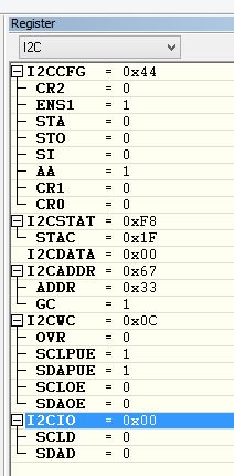

Reported below is the I2C status during the problem; I don't see anything unusual register wise.
To manually exit this issue I have to set the OVR =1, enable pull up for both SCL and SDA, enable output, setting SCLD, SDAD to 1, setting ENS1 =0.
At this point the I2C bus recovers.
To have IC starting to work again on the CC2541 acting as a slave device I have to set back OVR =0, and  ENS1 =1.
This sounds like some sort of CC2541 internal supply issue, I need insight on how to address it.

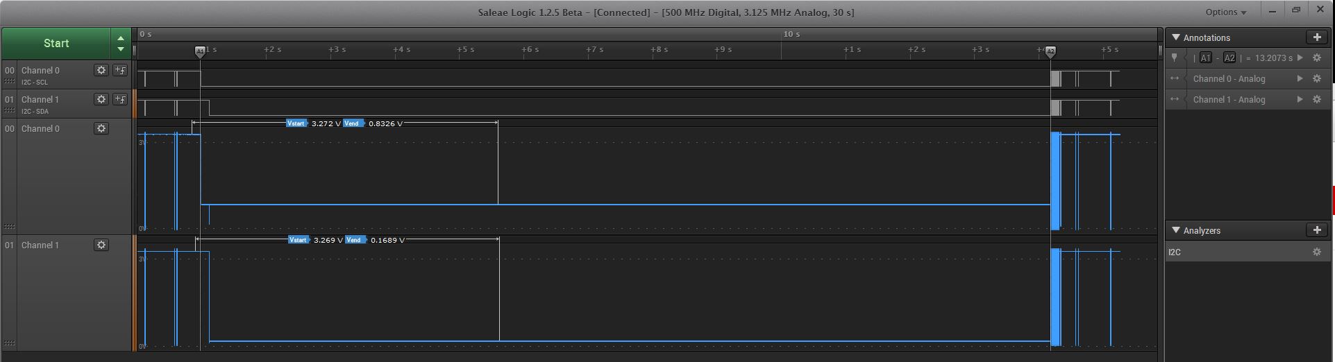

    This sounds very strange. Does the 0.8 V level match your external pull-up value if we assume the pin for some reason enables the internal 20k pull-down? Do you have an oscilloscope plot of the voltage drop you could share?

  • Hi Fredrik,
    ( Please note that of course this is a CC2541, I can't find the wrong thread title).
    Check the image below.
    The external pullup is 4.7k and we have a CC2640 in our system with pullup enable, with I think around 15 k of resistance which should give roughly a 3.5 k an equivalent pullup. The value should be much higher if considering that the "1" voltage is 3.3V.
    Please check the picture below:
    The issue disappears when the phone disconnects.
    I have a cheaper non-TI dongle where this problem is not happening.
    Also I'm currently providing the supply 3.3V directly with two wires soldered on VCC and GND pin of J1.
    Paolo
