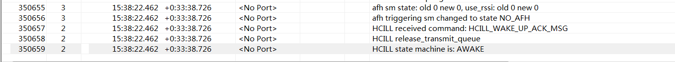

    I use the CC2564 chip , the bluetooth stack is "CC256x STM32 Bluetopia SDK" , the profile is SPP, when I use android phone app connect this SPP, then I distance for bluetooth disconnect , and then stand back nearly for bluetooth reconncet , and so on.... , but after some hours, the bluetooth stack will die , and the android phone don't connect the SPP profile , the device don't send any commond , as all command return -14.

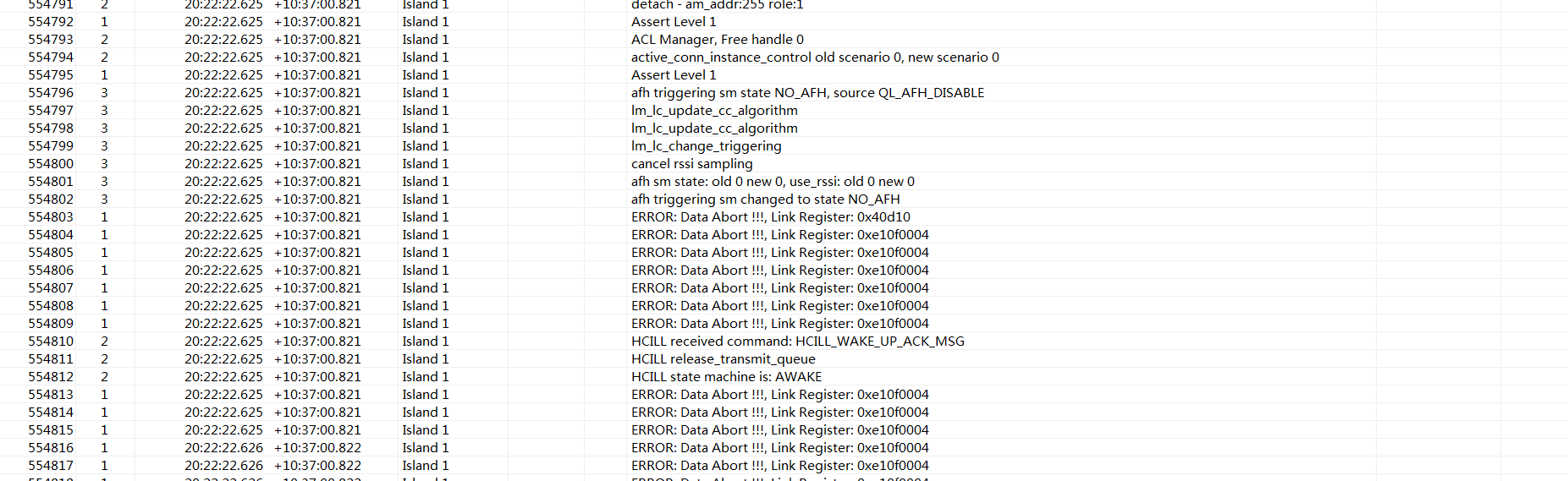

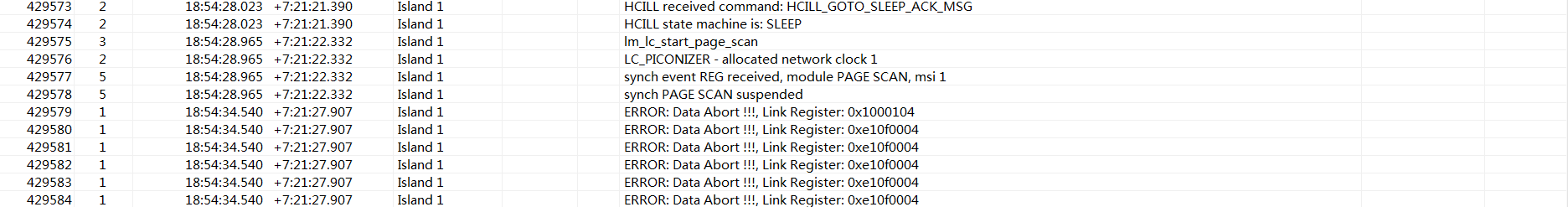

when it die , I get the CC2564 LOG is :
the complete LOG file is (it contains four files):
