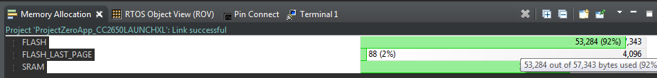

A second question, when I compile in CCS, it shows that the code uses almost 100% of the flash, why? 53kb is not the 100% of the 110Kb of the CC2650, is it because of the BLEStack?? But if so, whith this very basic project we're filling almost the whole flash, leaving no room for any useful application.
Why is the Flash separated in Flash and flash last page?
