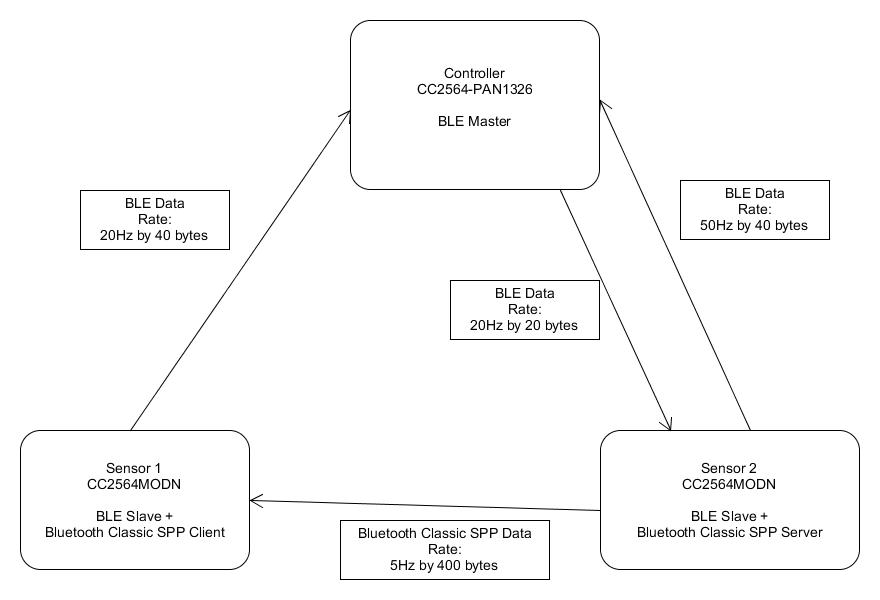

    This is a good a question and I should have started form my original problem. I use it to recover from a inability to connect to another bluetooth
    device of the same kind. (CC2564modn)
    Two sensors siting next to each other on my desk, the same hardware. I use blootooth classic SPP profile to open port
    SPP_Open_Server_Port on one sensor
    then on the other sensor I use:
    SPP_Open_Remote_Port
    Then I send some data.
    But sometimes the open remote port function times out without establishing any connection, does not matter how many times I try
    (in the loop: if it has timed out then try again and again........) (I do get a callback saying: timed out)
    I am not able to do anything to make it connect again except if I power cycle the connecting (open remote port) sensor,
    then It connects straight away. So I figured out that That I would need to reset the Bluetooth chip and reconnect.
    If you could help me with this one which is my real problem I probably would not have to reinitialize bluetopia.

  • Scenario 1: BLE data OFF
    I have tested the scenario where data from Main Controller is not being sent at all.
    All I do is I connect and disconnect (every 3 seconds) from Sensor 1 to Sensor 2 using SPP Classic. I cannot see any problems with that establishing connection/s for 12 hours of testing.
    Scenario 2:  BLE data ON
    As soon as I start sending data over BLE between Controller and sensors I am not able to establish SPP connection between the Sensor 1 and Sensor 2 – it always time outs.
    Could you advise what could be the reason for Bloetooth classic not being able to establish connection in this case?
    I can see some obvious ones like antenna time bandwidth time....... ?
    But I don't think that bandwidth has not been exhausted here.
    What sniffer can I use to gather some logs for bluetooth classic SPP?
    What could potentially be done to make it work?
    Thanks you
    Rafal Witelus

  • my connection params for BLE are:
    21 and 25 mili seconds - for intervals.
    MTU 131

  • Could you please advise which BT sniffer should I use to analyze the problems?
    Would this one be ok?
    www.fte.com/.../BPA600.aspx
    Rafal Witelus
