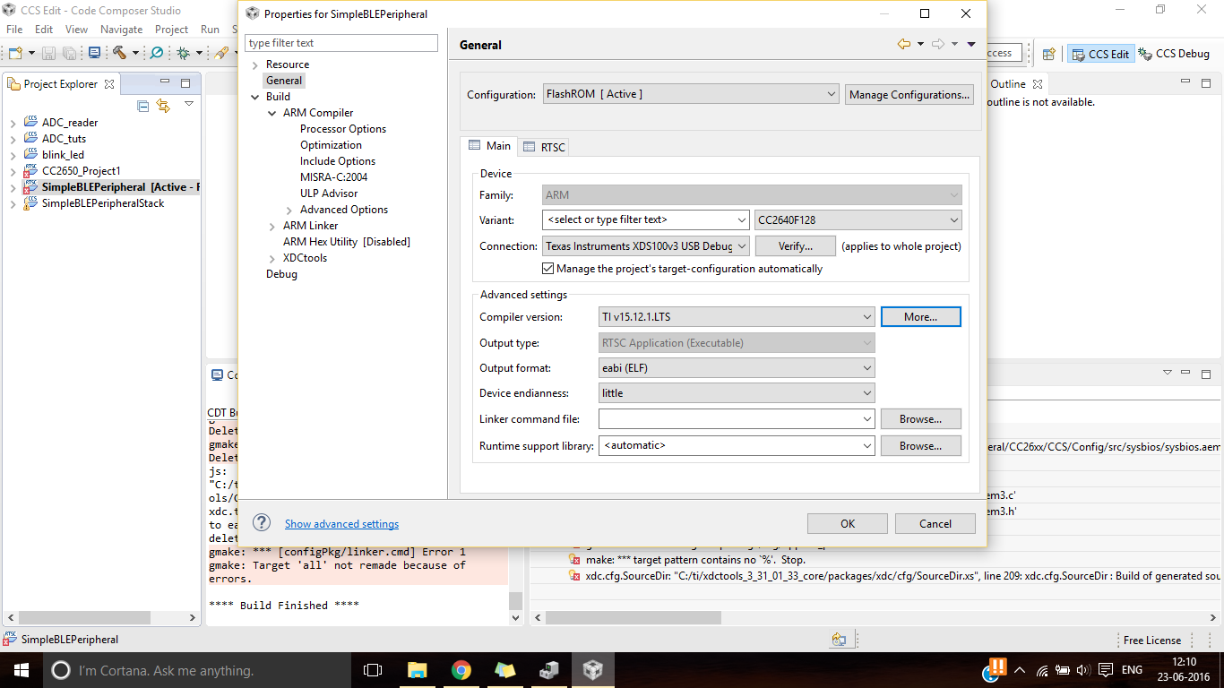

    See a snapshot of settings with which we are building project
    Now I am getting following errors when I am trying to build SimpleBlePeripheral project
    Description Resource Path Location Type
    gmake: *** [C:/ti/simplelink/ble_cc26xx_2_01_01_44627/Projects/ble/SimpleBLEPeripheral/CC26xx/CCS/Config/src/sysbios/sysbios.aem3] Error 2 SimpleBLEPeripheral C/C++ Problem
    gmake: *** [configPkg/linker.cmd] Error 1 SimpleBLEPeripheral C/C++ Problem
    gmake: Target 'all' not remade because of errors. SimpleBLEPeripheral C/C++ Problem
    gmake.exe: *** [package/cfg/appBLE_pem3.xdl] Deleting file `package/cfg/appBLE_pem3.c' SimpleBLEPeripheral C/C++ Problem
    gmake.exe: *** [package/cfg/appBLE_pem3.xdl] Deleting file `package/cfg/appBLE_pem3.h' SimpleBLEPeripheral C/C++ Problem
    gmake.exe: *** [package/cfg/appBLE_pem3.xdl] Error 1 SimpleBLEPeripheral C/C++ Problem
    gmake.exe: *** Deleting file `package/cfg/appBLE_pem3.xdl' SimpleBLEPeripheral C/C++ Problem
    make: *** target pattern contains no `%'. Stop. makefile /SimpleBLEPeripheral/FlashROM line 77 C/C++ Problem
    xdc.cfg.SourceDir: "C:/ti/xdctools_3_31_01_33_core/packages/xdc/cfg/SourceDir.xs", line 209: xdc.cfg.SourceDir : Build of generated source libraries failed: exit status = 2: appBLE.cfg /SimpleBLEPeripheral/TOOLS C/C++ Problem
    This project was created using a version of compiler that is not currently installed: 5.2.4 [ARM]. Another version of the compiler will be used during build: 15.12.1.LTS. Go to 'Help > Check for Updates' page to check for updates and visit <a href="liveaction:OpenAppCenter">CCS App Center</a> to get the latest compilers. Go to 'Help > Install New Software...' to install older compilers. Alternatively, migrate the project to one of the available compiler versions by adjusting project properties. SimpleBLEPeripheral properties Problems
  • What's your CCS version? Maybe try to remove your CCS and install the latest CCS version which is 6.1.3 now.
  • I am using CCS latest version 6.1.3.
    I think problem is this following error. Please suggestsolution  if you can
    make: *** target pattern contains no `%'. Stop. makefile /SensorTag/FlashOnlyOAD line 77 C/C++ Problem
    I am an intermediate level of programmer in CCS, I have taken care of all trivial things.
  • Do you follow section 2.6.3.1 Configure CCS in CC2640 Develop's guide ( www.ti.com.cn/.../swru393c.pdf )
  • Please somebody raise this errors, I have not been able to figure out this errors.
    Our development process has been stagnated from past 3 days.
    Please raise this issue.
  • Which BLE Stack version do you use? Is it latest BLE Stack V.2.2?
  • Hello Jayesh,
    Please install the SDK to the default C:\ti location and confirm the projects build as prescribed in the CC2640 SW Developer's Guide (SWRU393). If you still encounter failures, please attach your complete build log file (do not copy/paste).
