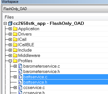

  • Yes, you can use the battery service (battservice.c).  I'm not sure what you're doing wrong but the battery service is definitely included with the 2.2.0 sensortag project. Here are the files in the IAR project:
    Here is the service as discovered by BTool:

    I apologize for not being more specific.  I'm using the TI cloud tools to build the sensortag example and flash the CC2650.  As far as I can tell, the cloud version of the sensortag example doesn't include the battery service.
    The local version does have the battery service.  Unfortunately, I cannot successfully build the example using the local Code Composer Studio version 6.13.  I spend most of my time searching for solutions to problems  that I have encountered with CCS 6.13.  My latest problem is...

    So, I believe my question should be... is there anyway to add the necessary files to the cloud sensortag example to enable battery service?
    Thanx
  • Yes I would recommend just using the same method that the local version uses. The easiest way to find this would probably be to diff the two application files (sensortag.c).
    For a better functional understanding, you could go through the simpleLink academy (software-dl.ti.com/.../overview.html) which describes how to add a service. There is also useful information in the GATT section of the SDG: www.ti.com/.../swru393
