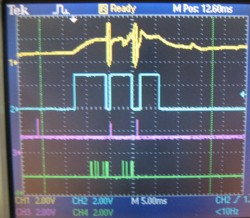

  • I have some more information regarding this post.
    In my application I am using the CC1310 device as an interface between an SPI link and a proprietary RF network. Information received over the SPI link (typically at 4Hz) is transmitted onto the wireless network and information received from the wireless network (typically at 1Hz) is passed onto the SPI link. The SPI in the CC1310 is running in slave mode using callbacks and with RETURN_PARTIAL enabled.
    Whilst developing the SPI code, a 'dummy' sentence was generated in software to simulate a reception over RF and this was output onto the SPI link. Sentences received over the SPI link were buffered ready for RF transmission, but no transmission was made. This code was developed with TI-RTOS v2.16.01.14 and was working as desired.
    The move to TI-RTOS v2.20.01.14 co-incided with the replacement of the dummy SPI sentence by real RF communications on our proprietary network. So now, 'real' sentences received from the RF network are transmitted onto the SPI port and the received SPI sentences are passed onto the wireless network. It is this combined RF and SPI code that causes the exception (which appears to come from the SPI code) after several seconds of correct operation.
    When I reverted to TI-RTOS v2.16.00.06, I found that this also generates the exception when the RF code and SPI code are run together.
    I have today confirmed that the SPI code using dummy sentences runs correctly with both v2.16.01.14 and v2.20.00.06 of the TI-RTOS.
    I have also seen that our radio code runs quite happily on both versions of TI-RTOS when the SPI functionality is not activated, so it seems that the issue I am seeing is not related to having upgraded the TI-RTOS, but rather to having both the RF and SPI code running at the same time.
    When both the RF and SPI code is active, the exceptions are not generated immediately. There can be up to 30s of correct operation (RF & SPI) before the exception occurs, so it is not easy to use breakpoints to trap the exception behaviour.
    The RF code and SPI code are both running in the same background task. Whilst the RF code is active, a CTS line is asserted to prevent SPI sentences being received from the SPI master.
    After the short period of RF comms, the CC1310 is doing very little for the rest of the second, and is dedicated to receiving data over the SPI port. The product is capable of doing bi-directional RF comms and then receiving SPI sentences during the time that the RF code is inactive.
    After the receipt of each RF sentence (typically three sentences are received in a 20ms period), the payload of the RF sentence is transmitted over the SPI link. It is this functionality (enabling the transmission over SPI of the data received over RF) leads to the exception. The SPI transmission is much shorter than the radio reception operations (SPI runs at 3.75Mbps and radio runs at 76.8kbaud) so there should be enough time to complete each SPI transmission whilst the next RF sentence is being received.

  • Hi Richard,
    Thanks for the suggestions.
    Please see the following scope image:
    Channel 2 is the Rx activity from the radio (GPO0 driven by the RF core), channel 3 is the time spent in the SPI callback and channel 4 is the time spent in the RF callback.  It really doesn't look like there is an issue between the two callback functions.

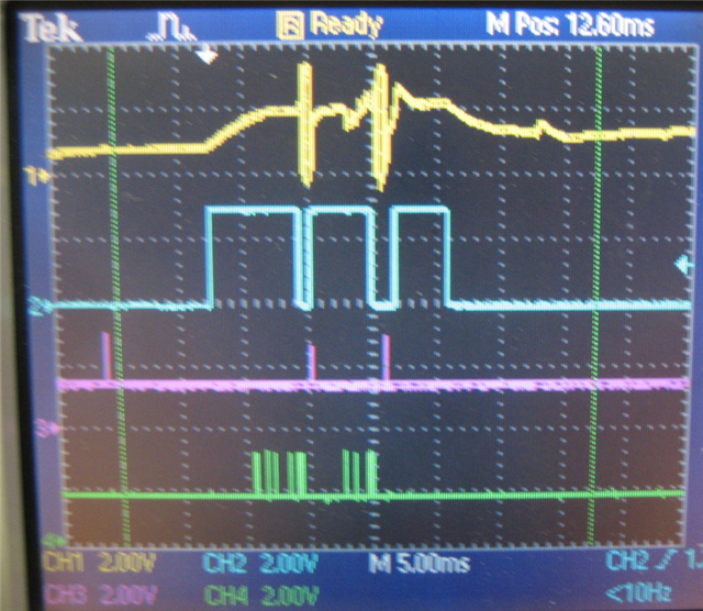

    Here is the equivalent image that is captured when the exception occurs:
    There is no obvious issue with the callback functions either getting longer or clashing, so I don't feel that there are any clues here.  I'll try adjusting the interrupt priorities as you suggest and let you know if that makes any difference.
    Chris
  • Hi Richard,
    Your first suggested test with changing priorities was to adjust the swi priority of the SPI driver to 1. I tried this and re-ran the code ... and it has now been running for 10 minutes without the exception occurring. I need to do some more thorough testing next week before jumping to anyu conclusions ... but it has certainly made a significant improvement to the behaviour of the code.
    Does this imply that the exception was caused by contention between Swis from two different sources that had the same priority level?
    Thanks for your assistance.
    Chris
  • This is an excellent idea! I think you are getting closer. Looks like the RF callbacks in the 3rd RX activity (packet?) are not executed as well. Since you have already included the driver source files into your project: Please move one or two of your test channels to entry and exit of SPICC26XXDMA_swiFxn() and also to swiFxnHw() in the RF driver. Then maybe also to the hwi's to get the full picture.
    • I wonder if instead of prioritizing the SPI, the RF core handlers must be prioritized.
    • How does your RX command(s) look like? Are these 3 subsequent RX commands? I assume so because the LNA is disabled after each packet. Therefore, is the RF core maybe running a power cycle? This causes a lot of interrupts and time dependencies.
    • Do you explicitly set RF_Params::nInactivityTimeout?
