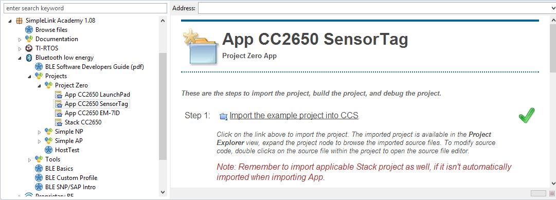

  • I forgot to show the path to the project, here is how i went to the project
  • I have seen the same issue with my notebook which is win10+BLE Stack 2.2 + Simplelink Academy 1.08 but my colleague uses Win 7+BLE Stack 2.2.+SimpleLink Academy doesn't have this problem. Don't know why Win10 and Win7 make difference. Hope someone from TI can verify this.
  • I am using Windows 8.1. I guess it does not work on 8.1 too. I hope someone tells me more about how to tackle this issue.

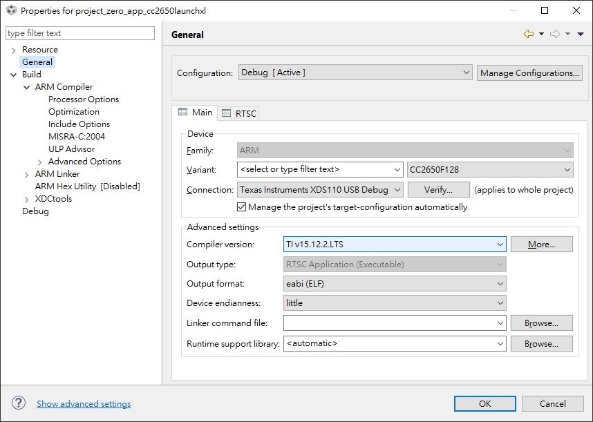

  • Hi Shantam, YiKai,
    Which version of the TI ARM Compilers are you using?
    We recommend building BLE Stack v2.2 projects with TI ARM Compiler version 5.2.6. Refer to Section 2.6.3.2 “Installing a Specific TI ARM Compiler” in the BLE Software Developer's Guide (http://www.ti.com/lit/ug/swru393c/swru393c.pdf) for the procedure to install TI ARM Compiler version 5.2.6.
  • @RachelP, I use ProjectZero in Simplelink Academy 1.08 and it uses TI v16.6.0.STS as default compiler. Do you try ProjectZero in Simplelink Academy 1.08?
  • @RachelIP , After I switch to TI ARM Compiler version 5.2.6, I get the following compile errors. Can you help?

  • After I change Compile version to TI v15.12.2.LTS, it works fine.
  • Hi YiKai,
    We recommend using the TI ARM Compiler v5.2.6 because that is the version BLE-Stack v2.2.0 was tested and verified with. The compile errors you are seeing in Project Zero are due to differences between IAR and CCS. It won't compile but it doesn't affect functionality so in the latest version of the SimpleLink Academy install (1.8.2), we suppress those errors. You can do this yourself by adding 16004 to your --diag_suppress list in the project options.
    BLE-Stack v2.2.0 has compatibility issues with TI ARM Compiler v16.6.0. We do not recommend using this compiler for any project that uses BLE-Stack v2.2.0.
    We have not done extensive testing with TI ARM Compiler v15.12.x so while you may be able to use it, we note in our BLE-Stack 2.2.0 release notes that they are not compatible (http://focus.ti.com/download/freetools/release_notes_BLE_Stack_2_2_0.html#Known_Issues) and recommend using TI ARM Compiler v5.2.6.
  • Get it! Just have a try with your suggestion and it works fine.
    Thanks a lot!
