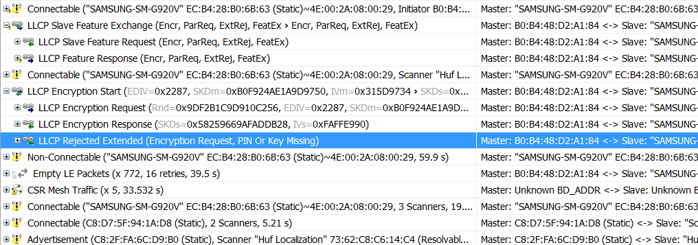

  • Hello Ji Won,
    Do you have a sniffer trace of this behaviour?
    Best wishes
  • Yes, I have. please refer to the attached image.
    Strange things are data transferring seems to be OK.
    just the return value of pairing is failed. So, no bonding information is on iPhone Bluetooth setting.

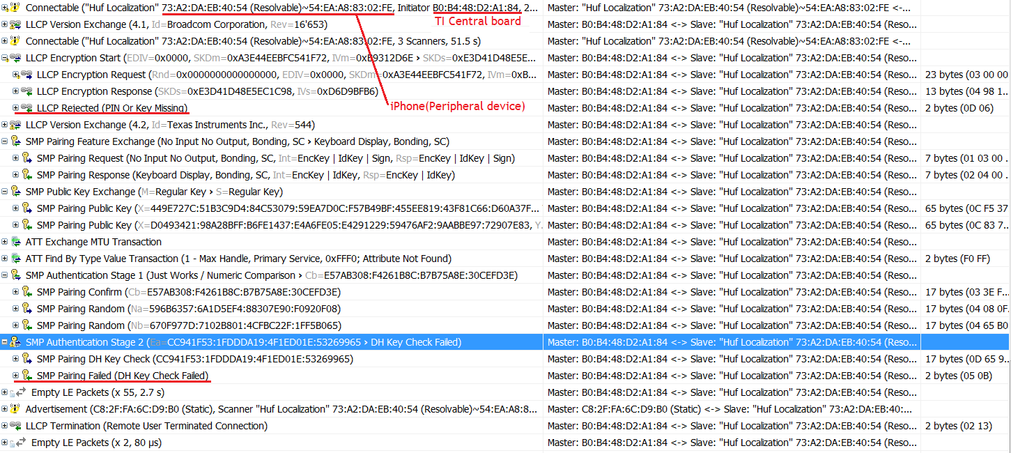

    And, I tried to use 'just works' and 'passkey' mode, the same situation happens when user deleted the paired and bonded information from the iPhone.
  • As you can see on the below image, no more process when encrypt start is rejected.
    This case is generated by using Android phone using static random address along with 'just works' mode.
    No information with related to pairing OK or not through the below logs. I cannot see any bonded information from the Bluetooth setting menu of Android Phone.

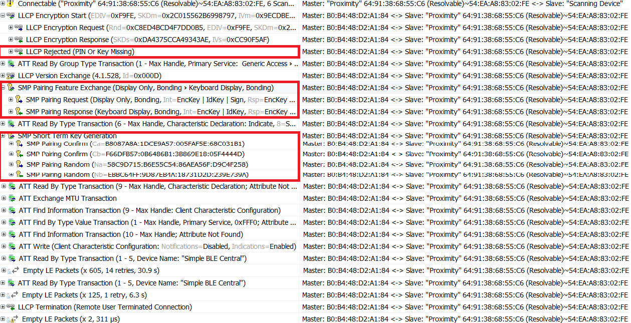

  • I tried to find out the reason why key missing and re-pairing issue.
    It still has the same situation under the BLE v4.2 Features in '‘build_conf.opt’ file.
    And I came to see another issue with privacy policy.
    /* BLE v4.1 Features */
    /* -DBLE_V41_FEATURES=L2CAP_COC_CFG+V41_CTRL_CFG */
    /* -DBLE_V41_FEATURES=L2CAP_COC_CFG */
    /* -DBLE_V41_FEATURES=V41_CTRL_CFG */ /* default */
    /* BLE v4.2 Features */
    /* -DBLE_V42_FEATURES=SECURE_CONNS_CFG+PRIVACY_1_2_CFG+EXT_DATA_LEN_CFG */
    After disconnecting, just where erasing the bonding information from iPhone, and when discovering to reconnect the same iPhone, listed device address is not resolvable address, but public address of iPhone device. my understanding is that this is not totally proper for privacy policy.
    the key missing is again indicated, finally returns 'Pairing fail:0x0b' .
    What should I do ?
    Please refer to the below log.

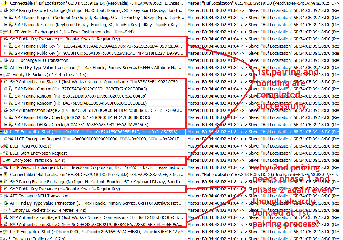

  • Thanks for the patch. but doesn't work. the same situation.
    1st pairing and bonding are done successfully.
    And then, I deleted the paired and bonded information from iPhone’s Bluetooth menu.
    And again, discovering and pairing are done by central device.
     Please see the below log data and analyzer data.
    Connecting
    0x54EAA88302FE
    Connected
    0x54EAA88302FE
    MTU Size: 23
    MTU Size: 65
    Pairing fail: 0xb
    Disconnected
    Reason: 0x13

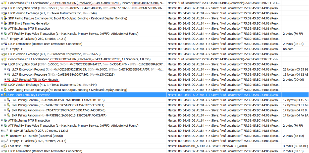

  • I don't think so that legacy pairing does work.
    Using legacy pairing method,
    1st pairing and bonding with PRA are done successfully.
    Discovering...
    Devices Found 4
    <- To Select
    Device 1
    0x4F2393EB804C
    Connecting
    0x4F2393EB804C
    Pairing started
    Connected
    0x4F2393EB804C
    MTU Size: 23
    Pairing success
    Bond save success
    Device 2
    0x49F4EA8DAD23
    Disconnected
    Reason: 0x13
    I deleted the bonded information from iPhone menu.
    At this point, the PRA is changed to new PRA 0x753945BC4486.
    Discovering...
    Devices Found 4
    <- To Select
    Device 1
    0x753945BC4486
    Device 2
    0x49F4EA8DAD23
    Device 3
    0xC82FFA6CD9B0
    Device 4
    0x08DF1F9A671A
    Device 1
    0x753945BC4486
    Discovering...
    Devices Found 4
    <- To Select
    Device 1
    0x753945BC4486
    Device 2
    0x49F4EA8DAD23
    Device 3
    0x08DF1F9A671A
    Device 4
    0xC82FFA6CD9B0
    Device 1
    0x753945BC4486
    Connecting
    0x753945BC4486
    Connected
    0x753945BC4486
    MTU Size: 23
    Pairing fail: 0x3a
    Disconnecting
    Disconnected
    Reason: 0x16
    Connecting
    0x753945BC4486
    Connected
    0x753945BC4486
    MTU Size: 23
    Pairing fail: 0x3a
    Device 2
    0x49F4EA8DAD23
    Disconnected
    Reason: 0x13
    Pairing is failed.

  • this problem happens regardless of legacy or secure connection configuration.
    0. the application and stack images are programmed to make it possible for 1st perfect pairing and bonding operation.
    1. discovery the advertising devices
    2. select iPhone device with PRA,
    3. after 1st pairing and bonding process successfully with iPhone, the bonding information is stored on both of devices(TI central board and iPhone) for the next future connection.
    4. still no discovery again, still using the existing discovered device lists,
    5. two problems are showing with your pairing and bonding operation.
    A. why your pairing operation always brings up the pairing request window for user to push 'pair' button even though the same address stored as a bonded information.
    => my guess is because your pairing and bonding process are operated based on still the PRA as advertising address is being used at this point.
    => when and after discovery again by pushing the 'up' button, the advertising device list is updated to the public identity address, not PRA. From this point, no more the window for user.
    B. As you know, after bonded, no more phase 1 and phase 2. only phase 3 should be used. But, why your process makes user push the 'pair' allowing button. It seems to be related with phase 1 and 2.
    6. disconnected.
    7. discovery again.
    8. public identity address is scanned and listed on the scanned device list.
    9. select the iPhone device with the public identity address
    10. pairing and bonding process are OK and no more the window for user.
    11. deleted the bonded information from the Bluetooth menu of iPhone.
    12. always pairing failed.
    But, if the is no discovery again by pushing the 'up' button, and even though the bonded information is deleted from the Bluetooth menu of iPhone, when you tried to pair with iPhone, which still shows the PRA, not public identity address, it will be paired and bonded again without skipping the phase 1 & 2.

  • Yes, I am always performing discovery again with my central device to find the iPhone. And I'm never seeing the pairing issue as stated in previous posts.
    Regarding your point A from above...your guess sounds correct. If you don't want to see the pairing window, I would recommend always performing discovery again before reconnecting.  If you don't want to do this, you can modify the code to, after a bond occurs,change the PRA in the device list to the resolved public address.

  • Regarding "Where is the "listed device address" that you are referring to? And why is this a problem?" you mentioned,
    I understood why it is not a problem.
    when -DBLE_V42_FEATURES=SECURE_CONNS_CFG+PRIVACY_1_2_CFG option is used, after bonded, the devList automatically changed to the resolved address for the RPA used as an advertiser address(AdvA). So, the address type is not '0'(Public device address) but '2', which indicates Public Identity Address corresponding to Resolved Private Address and Sub Address type is indicating still RPA.
    If I don't want this above one, PRIVACY_1_2_CFG shouldn't be used.
    If -DBLE_V42_FEATURES=SECURE_CONNS_CFG+PRIVACY_1_2_CFG should be used, when disconnected after 1st pairing process, I added the discovery operation. Through this approach, the 2nd pairing won't have the phase 1 & 2 again as public identity address(corresponds to resolved private address) of iPhone 5 device is being used. Let me know if there is more better approach to skip the phase 1 & 2 after 1st paired and bonded.
    Still, the key missing problem is not solved with your patch library.
    BR,
    Ji Won
  • v2.2.1.18 SDK solved this key missing error case. so, I will close this question.
