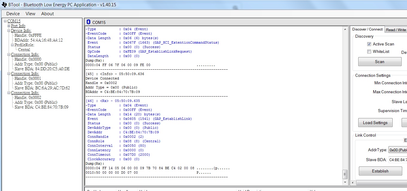

    I got an CC2650SensorTag and I had the same problem.
    I will try to explain each step I do. At moment I have two peripherals(SensorTag and SmartRF06 with Simple_peripheral) and one central SmartRF06 with HostTest.
    I start Btool and connect with HostTest.
    Push the button "Scan" and find both.
    Push the button "Establish" with the first Device and can connect.
    Next I choose next "Slave BDA" with the Combobox and try again to click the "establish" button.
    But then Pop up the message "GAP_EstablishLinkRequest Failed. There Are No Resources Available."
    Count the address handler automatically? Or where must I count this?
    If I start Btool, the GAP_DeviceInit Show signCounter 1... I changed it, but I have the same Problem.
    I hope this info helps to find a solution what I did wrong.

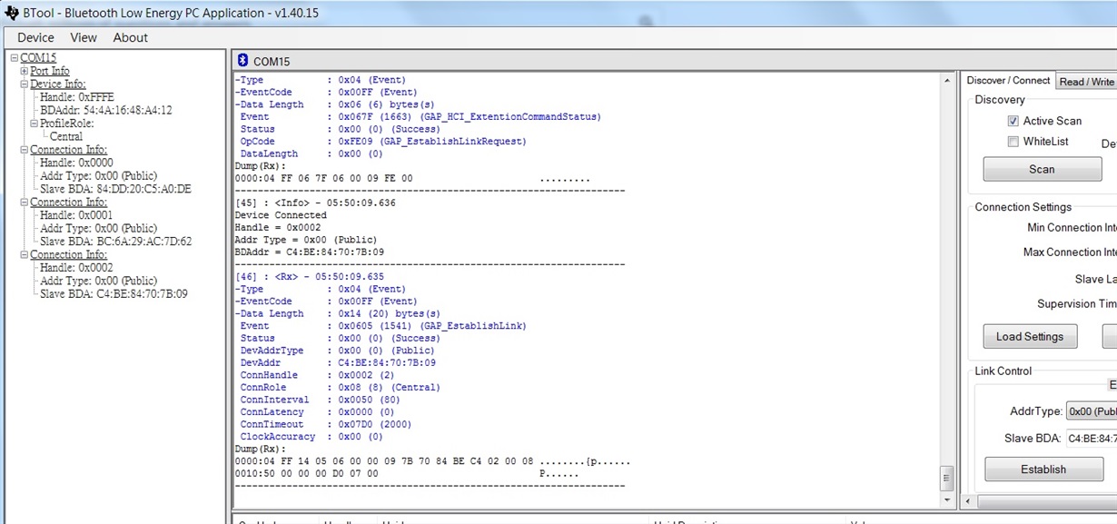

    I tested the multirole stack and I can connect with both devices. So it must be my configuration...
  • For your reference, I just test with my BLE kit. I use BTOOL and see it can connect to one CC2650 SensorTag, one CC2541 Keyfob, and one CC2541 SensorTag without problem.
  • Hi Chen,
    I believe you that it works. But which stack do you use? What are the configurations of your device-initialisation? Ando do you do exactly the same steps like what I said?
    But you used the same ConnInterval config...
    You did only change the Addr Type and pushed establish again?
    Could you give your Uart-output?
    thanks for the help.
  • Yes, I do the steps as yours
    and I can get my CC2650STK connected without problem. I attach my log for your reference.

    [22] : <Tx> - 10:27:41.403
    -Type           : 0x01 (Command)
    -OpCode         : 0xFE09 (GAP_EstablishLinkRequest)
    -Data Length    : 0x09 (9) byte(s)
     HighDutyCycle  : 0x00 (0) (Disable)
     WhiteList      : 0x00 (0) (Disable)
     AddrTypePeer   : 0x00 (0) (Public)
     PeerAddr       : C4:BE:84:70:7B:09
    Dump(Tx):
    0000:01 09 FE 09 00 00 00 09 7B 70 84 BE C4          ........{p...
    [23] : <Rx> - 10:27:41.421
    -Type           : 0x04 (Event)
    -EventCode      : 0x00FF (Event)
    -Data Length    : 0x06 (6) bytes(s)
     Event          : 0x067F (1663) (GAP_HCI_ExtentionCommandStatus)
     Status         : 0x00 (0) (Success)
     DataLength     : 0x00 (0)
    Dump(Rx):
    0000:04 FF 06 7F 06 00 09 FE 00                      .........
    [24] : <Info> - 10:27:41.455
    Device Connected
    Handle = 0x0000
    Addr Type = 0x00 (Public)
    BDAddr = C4:BE:84:70:7B:09
    [25] : <Rx> - 10:27:41.449
    -Data Length    : 0x14 (20) bytes(s)
     Event          : 0x0605 (1541) (GAP_EstablishLink)
     DevAddrType    : 0x00 (0) (Public)
     DevAddr        : C4:BE:84:70:7B:09
     ConnHandle     : 0x0000 (0)
     ConnRole       : 0x08 (8) (Central)
     ConnInterval   : 0x0050 (80)
     ConnLatency    : 0x0000 (0)
     ConnTimeout    : 0x07D0 (2000)
     ClockAccuracy  : 0x00 (0)
    Dump(Rx):
    0000:04 FF 14 05 06 00 00 09 7B 70 84 BE C4 00 00 08 ........{p......
    0010:50 00 00 00 D0 07 00                            P......
  • Hi Chen,
    I compared the BTOOL.TXT with my output from btool. It is the same.
    So I think the problem is in the stack. I use the latest version (2.2 from 21-JUN-2016 ) and changed nothing. Which version do you have?
  • I test both BLE Stack 2.2 and 2.1 and all of them work fine.
  • Hello Christian. Has this been resolved?
    If you are building host_test from CCS (BLE-Stack v2.2.0), please add the following to the predefined symbols in the App project:
    MAX_NUM_BLE_CONNS=8
    Best wishes
    Edited - corrected to add the predefined symbol
  • Thank you JXS.
    But what about the HEAPMGR_SIZE predefined symbol?! I read "Cc2640 MultiRole Demo" and "CC2640 Central to MultiPeripheral" sample from BLE Wiki, they both mention to the relationship between MAX_NUM_BLE_CONNS and HEAPMGR_SIZE.
    By default, the HEAPMGR_SIZE is predefined with 0. So if I add predefined symbol as you suggest, how should I define the HEAPMGR_SIZE?!
    #Update:
    I have tested with some HEAPMGR_SIZE predefined numbers and see that the maximum HEAPMGR_SIZE number I could predefine is 8619. Over that number, IDE will return error: "Program will not fit into available memory. run placement with alignment fails for section ".stack" size 0x400".
    So I stopped at HEAPMGR_SIZE = 8610, and tried using BTool to connect with my 8 sensor nodes. First 7 connections were established successfully. But at the 8th connection, BTool returned me: "GAP_EstablishLinkRequest Failed. There are no resources available". So I guest the real maximum connection number is 7.
    Could u confirm it for me?!
    Best Regards.
