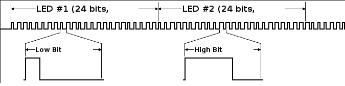

  • Hi Chirstin,
    i need to generate a sequence of pulse to transmit code 0 and code 1 following the following timing diagram by toggling 1 I/O on CC2650
    tolerance for each pulse is only around +/- 150 ns. Hence, i need a fast I/O toggling using precise timer intterupt which has smallest resolution of 0.5 us (500 ns)
    If i use PWM driver as you suggested, will it help? because it seems like the limitation on how fast we can toggle an I/O from high to low / low to high on CC2650

    If we keep adding data processing logic to control the sequence and control the waveform of code 1 and code 0 inside Timer0Isr, the delay is getting bigger and bigger and make it very difficult to has precise sequence of code 0 and code 1.
    Please let me know if there is a better way to achieve this. I want to use CC2650 to transmit 24 bit sequence of code 0 and 1 following the timing diagram in my previous post.
