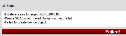

  • Hi Fredrik K..
    Yesterday, I programmed CC2650 SensorTag with CC1310 Launchpad successfully.
    Everything worked good yesterday , and than suddenly - it stop working ...   Now i cannot program CC2650STK ..
    I have no any idea about this problem. I did not change anything.
    (the same problem ---> )
    Can you help me again Fredrik K ?
    Thank you..

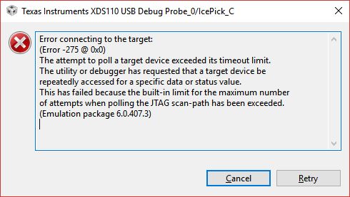

  • I tried to program CC2650 through th SmartRF Flash Programmer2.
    I can connect CC2650
    but when i try to erase, error occur..
     I read wiki page, which you shared.. Unfortunately it did not understand what i must do ?
  • I solved problem..
    I have 2 mistake...
    1_
    MS,TCK,TDI,TDO pins are connected but "Reset" pin is not connected..
    CC1310 LaunchPad RST pin must be connect to CC2650STK RST pin.
    If you do not connect RST pin, you can program target only one time..
    (Just like me, you can say :  "I succeeded to program device!", but after a while you cannot program device and be disappointed )

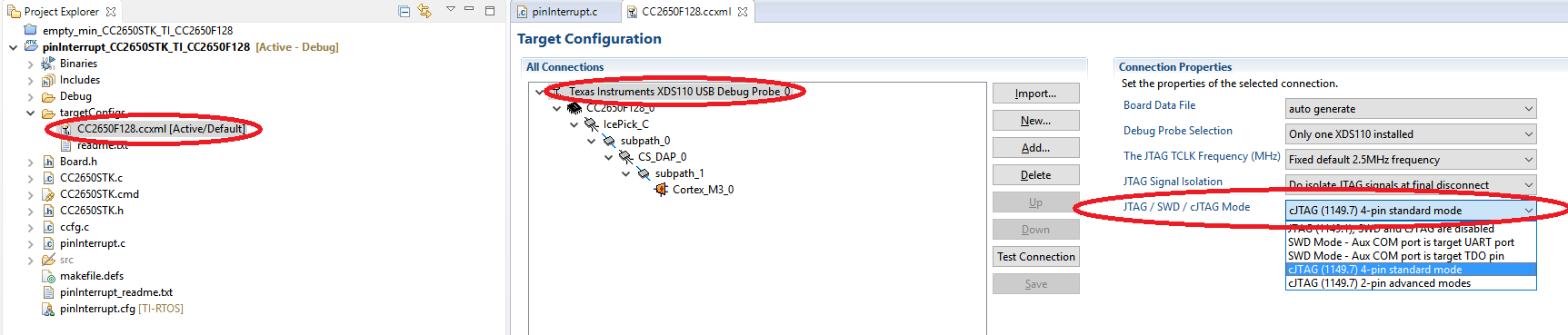

    2- In Target Configurations ---> Advanced Setup ---> JTAG/SWD/cJTAG Mode must be selected. "cJTAG - 4-pin Standart Mode"
    Thank you very much Timur and Fredrik for your help.
