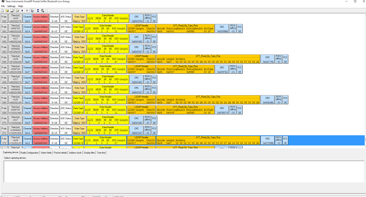

I never saw the case with ATT_READ_BY_TYPE_RSP works so I took the CC2540miniDK dongle and used it as sniffer (BTW I hope to use the CC2540 dongle isn't bad to work with CC2650)
I got five "ATT_READ_BY_TYPE_RSP" and took the screen :
I'm joinning you the file which contains the record of this picture (Open with Packet Sniffer from TI).
handle.psd
I need to understand 2 things here :
1/ Why did I never get the "ATT_READ_BY_TYPE_RSP" case on my SimpleBLECentral_processGATTMsg() function ?
2/ Can I read the handles of my 5 simpleprofiles from the sniff ?
Thank you by advance.

  • From a brief readover it appears you are doing everything correct here. I'll need to set up a similar test to answer more.
    Yes, you should be able to read the handles from the sniffer.

    It's working better but not completely right. Indeed, I now have my "ATT_READ_BY_TYPE_RSP" case but i only read 3 pair numbers, I should have 5 isn't it ?
    I made some research on my side about the sniffer BLE but I was unable to get our the handles from the the sniff I posted early, if you can help me about that i should be able to see which simpleprofile are missing.
    John
  • Hi John,
    I would suggest you take a look at Vol 3, Part F, Section3.4.4 of the Bluetooth Core Specification v4.2. That will explain how Read By Type Requests and Responses are structured.
    For example, in your sniffer capture, the first characteristic handle you discovered was 0x0002. I think the reason you are only seeing 3 pairs is that you are only displaying the number of pairs in one data packet.
    If I do a complete characteristic discovery on the SimpleBLEPeripheral project using BTool, I can discover 17 characteristics which matches the output from your sniffer log. If you only want to discover the "Simple Profile Characteristics", you will need to change your the handle range in your GATT_DiscAllChars call.

    Thank you about all these explanations, seems really clearly now and it works !
