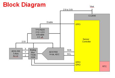

    Can I just ask this:  We are using the Sensor Controller on the CC13xx/26xx but with an external ADC (TI ADS7056) as shown below:
    Therefore, what SCS project example would be the BEST place for the customer/us to start proof-of-concept work with?
    Chris

  • Fredrik and team,
    Our customer is now asking if the Sensor Controller can sample fast enough.
    In summary, if they sample the 16bit ADC (ADS7056) at say 9600Hz (x3 for three axis accelerometer) would the CC2640 SCE be able to handle this to do calculations in the RAM also?
    From a quick glance of the data sheet we're not sure it is obvious that it can, so we wanted to ask you guys for clarification.
    For now, the calculation would just do a one second sample for RMS calculations. They would ultimately like to do an FFT to see if they can do without the DSP that is in the older architecture.
    Any empirical thoughts? Comments welcomed!
    Thank you very much,
    Chris
  • Hi Chris,
    I'm struggling to find the datasheet for ADS7056. I see that ADS7042 is tagged. This device is based on SPI. Which is it?
    In any case; the serial interfaces implemented in the Sensor Controller are bit-banged. They support the serial speeds as documented. If you don't utilize the full bandwidth, then you can use every other clock cycle for other instructions. Note that there is no multiplication module in this microcontroller. All operations you have access to are documented in the Sensor Controller Studio.
    16-bit * 3 * 9600 is 460800 bps. This is more than you can do with 400kbps I2C, so I hope the serial interface for the ADC is SPI. We can do 1.1MHz SPI, so that should theoretically leave 50% for processing.

  • btw; I don't think this use-case is ideal for the Sensor Controller. Sensor Controller is really ideal for small operations that should be run with optimal power consumption. Running three axis sensors at full speed is really an active task. I believe you would be better off using the SPI module in hardware and DMAs for data transfer. Then use the Cortex-M3 to do processing during the data transfers. This would be a more optimal use of resources, and potentially more power efficient in the end.
    Sensor Controller can be used to extract samples from the ADC at a much lower rate, to detect that something is happening. This can then be used to wake up the full system to utilize the processing power of the Cortex.
