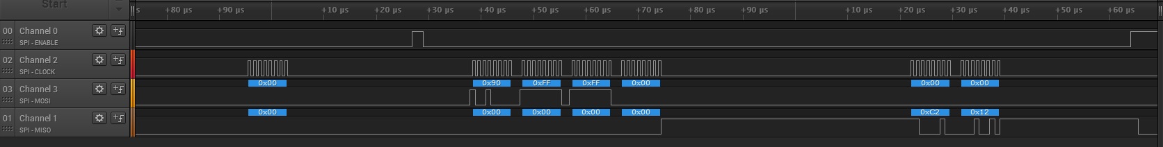

The board has an external flash (Macronix MX25V2006E), connected via SPI interface. Before proceed to the OAD feature addition, the SPI and ExtFlash drivers were added to the project. The driver was adapted to fit in our hardware. As can be seen in the following illustration, the SPI master (CC2640) and the SPI slave (MX25V2006E) are communicating as expected: the master successfully reads the flash information (manufacturer 0xC2 and device ID 0x12). So the hardware and the driver are both well functioning.

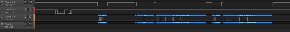

One more time, in order to evaluate the SPI communication, we put some breakpoints to debug the extFlashOpen function. Unfortunately the results are not the expected. The CC2640 can't read the flash information. However it's completely normal because according to the logic analyzer (see picture below), there is no clock signal. The SPI interface configuration remains unchanged:
  /* SPI configuration */
  SSIIntDisable(BLS_SPI_BASE, SSI_RXOR | SSI_RXFF | SSI_RXTO | SSI_TXFF);
  SSIIntClear(BLS_SPI_BASE, SSI_RXOR | SSI_RXTO);
  ROM_SSIConfigSetExpClk(BLS_SPI_BASE,
                         BLS_CPU_FREQ, /* CPU rate */
                         SSI_FRF_MOTO_MODE_0, /* frame format */
                         SSI_MODE_MASTER, /* mode */
                         bitRate, /* bit rate */
                         8); /* data size */
  ROM_IOCPinTypeSsiMaster(BLS_SPI_BASE, BSP_SPI_MISO, BSP_SPI_MOSI,
                          IOID_UNUSED /* csn */, clkPin);
  SSIEnable(BLS_SPI_BASE);
    /* Get read of residual data from SSI port */
    uint32_t buf;
    while (SSIDataGetNonBlocking(BLS_SPI_BASE, &buf));
Let me just notify that the bit rate is 1 MHz, exactly the same frequency used in the project mentioned above.
What can be the problem? Is there any pin configuration missing?

  • After some efforts the source of problem was finally found.
    The SPI drivers are implemented in different ways but both work well, without any doubts.
    As previously mentioned the SmartRF06 EB (TI XDS100v3 USB Emulator) has been used as debugger.
    The Evaluation Board was connected to our custom board through the 10-pin ARM Cortex Debug Connector (P410) using a 10-pin cable. However there is a pin (pin 8) shared between the programming/debugging (TDI) and the serial interface (SCLK). Once this signal isn't necessary to program/debug the target considering the cJTAG (2-pin) configuration, in order to put the SPI interface working in both projects (main and BIM) was:
    1. Select the cJTAG (2-pin) interface in the IAR IDE;
    2. Connect only the necessary signals between the Evaluation Board (P409) and the target (custom board) using 5 wires: V_SENSE, GND, JTAG_TMS, JTAG_TCK and nRESET.
    And now both SPI drivers are functioning like a charm.
