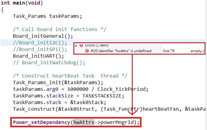

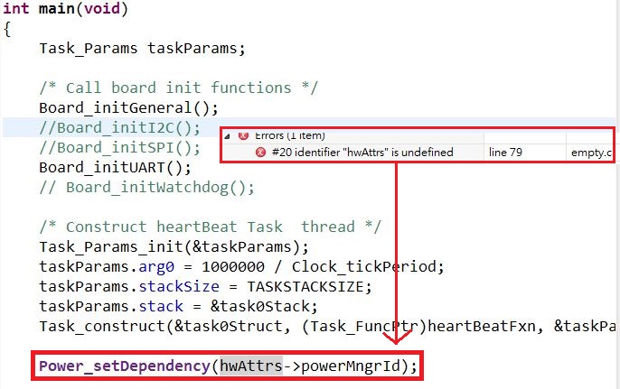

I refer power management for CC26xx SimpleLink Wireless MCUs User’s Guide Chapter 3,
it's about UART Drive , when the URAT drive opens , it's declares a power dependency upon the UART peripheral , with a call
to Power_setDependency() , if I use empty project , where should I put Power_setDependency() ?
seems I get error ...

  • In fact , I am not use SimpleBLEPeripheral example , I use Empty example:

       Power_setDependency(hwAttrs->powerMngrId);   //error

  • I'd try the UART echo example in TI-RTOS. The TI-RTOS UART driver already sets the power dependency as needed.
    Tom
  • Dear Tom:
    I just want to verify CC26xx SimpleLink Wireless MCUs User’s Guide Chapter 3 , Example : UART Driver
