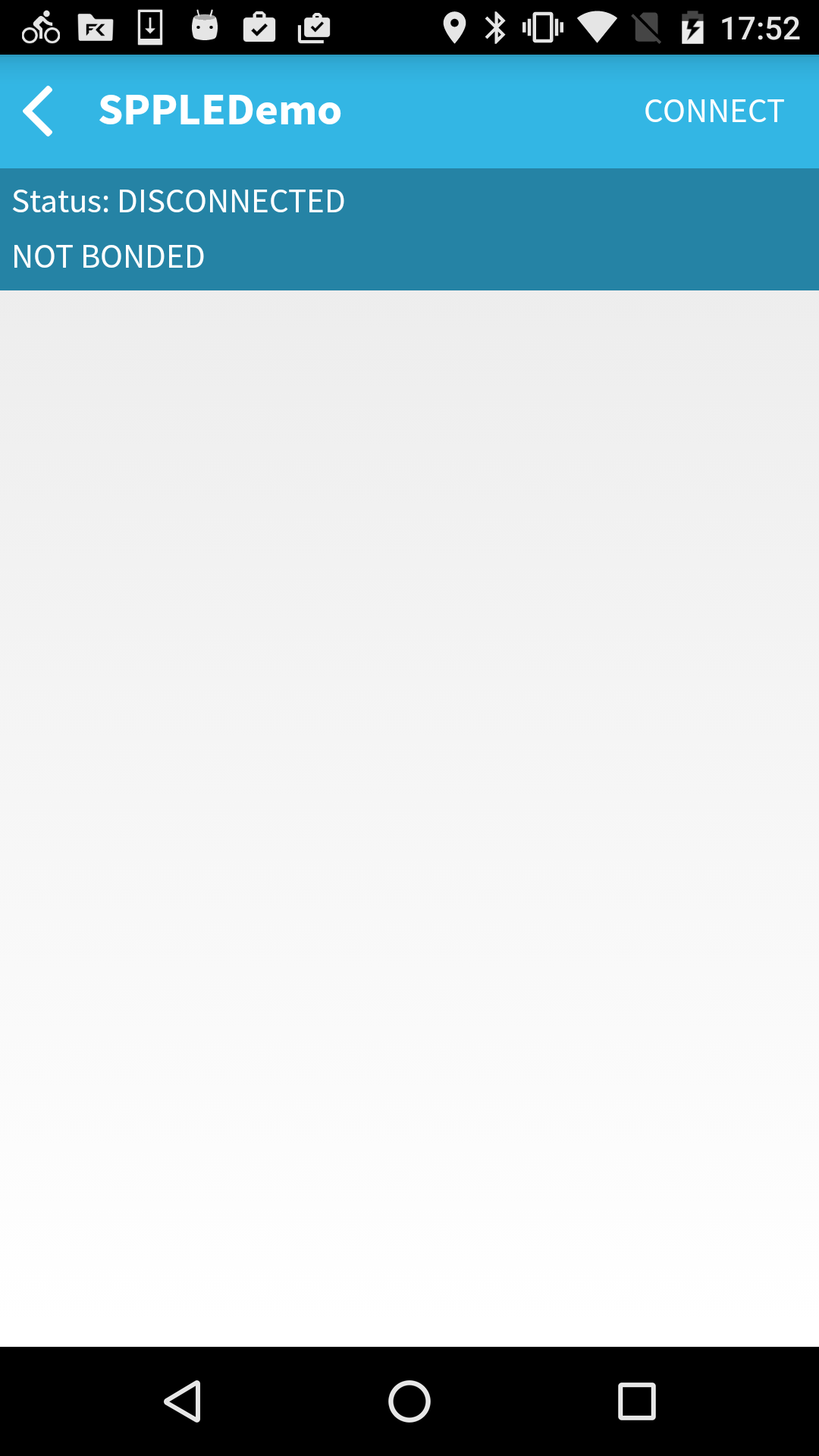

  • Hi Vihang,
      1. I am using custom gatt based profile and I have also tried for the sample code SPPLE.
      2. I encounter the same issue with SPPLE. Besides, I couldn't connect the device on any Android phones with BLE Scanner on Android ( by Bluepixel Technology LLP). I always get disconnected status and the screen shot is attached.
  • Hello Emily,
    what BT UPS are you using? BlueDroid on Android device?
    Please share some more information about the exact setup you are using.
    So we can help pin point what is the issue.

  • Hello Emily.
    First thanks for sharing all the details.
    UPS - upper protocol stack.
    And now i understand you are not using BlueDroid - so i assume you are using TI Bluetooth stack.
    Now i also understand that it works well on a couple of devices and doesn't work well with some others.
    The next step for me in order to understand what could be the issue would be to get FW logs.
    Can you please capture FW logs of a good case (connection with a Nexus5 device) and a problematic log (with Samsung Galaxy S5)
    So i can see what exactly is the difference in order to help solve this issue.
