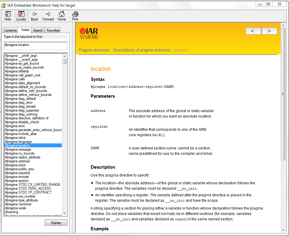

  • Hi KK,
    Yes, it is certainly possible that the size of the CCFG structure may grow in future TI-RTOS/BLE-Stack releases - note that it has grown by 4 bytes since initial BLE-Stack v2.0 release. Of course, you can also adjust the location of your structure as a SW upgrade would be required. I would say reserving 128 bytes for the CCFG is prudent.
    One way to specify an absolute location is with the location pragma, see the IAR help menu:
    You can see an example usage of this pragma in the osal_snv.c file. Then you would not need to modify your linker file.
    See the "Controlling data and function placement in memory" section in the IAR help for additional examples as well.
